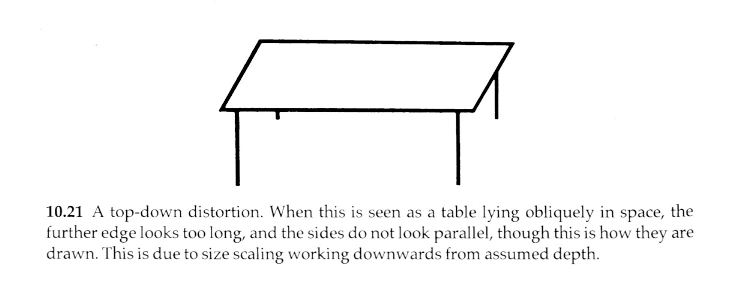

    None of the absolute mathematical relationships that you are treating as constant are actually perserved by the human visual system when you look at an image, or even the real world. And yet you are still treating the perspective you see in the image as an absolute truth and constant and assuming that there is no difference between the absolute linear geometry as rendered in the camera image and the assumed 3D perspective you see when you look at that image. It doesn't seem to occur to you to even question this.
    Eye and Brain - R L Gregory:
    "When an artist employs strict geometrical perspective he does not draw what he sees-he represents his retinal image. As we know these are very different; for what is seen is affected by constancy scaling. A photograph, on the other hand, represents the retinal image but not how the scene appears... ...The camera gives true geometrical perspective; but because we do not see the world as it is projected on the retina, or in the camera, the photograph looks wrong."
    The front and back of our table here are exactly the same size, and so the two side are exactly parallel, and so the opposite angels are also exactly the same. This is the geometrical truth of the image and the truth of the photo and how it is mapped to the back of the retina.
    But it is not what you see.
    In fact very little of the geometry you actually see in the above image relates to it's true geometry. That the sides no longer look parallel is a clear indication that relative sizes as in the true geometry is not preserved in human vision. So:
    Is proved to be incorrect as soon as we include human vision, the relationship is not maintained.
    I keep saying that you can't relate what you see through human eyes directly to the geometry of image formation without taking into account the very nature of human perception because they are different. To fully understand telephoto compression it is necessary to fully understand the true nature of mathematically correct linear perspective and just how your view through human eyes differs from that. They are a long way from being one and the same.
    P.s. I just posted an image and said the opposite, "it's not the same, see for yourself."
    JPG, 63.6 KB, uploaded by Andrew564 on Feb. 7, 2024.

    Maybe I misunderstand you, but IMO this is not geometrical truth of the image. You could get such image only by telecentric lens, which geometrically places center of perspective into (minus) infinity (in other words, makes focal length infinite). Using pinhole or any usual lens, you will get quite different image - sides not parallel and back side shorter.

    It's not about how realistic the table is. This is highlighting a very real and observable difference between the pure and mathematically correct geometry as projected on the back of your retina and what you actually see. And to do this in a way that's obvious and uncluttered.
    With the simple addition of legs the 2D shape transforms to a 3D understanding.
    So if a 2D shape does have near and far sides that are the same length then as a 3D table top one must in reality be longer. And this is what the brain is doing, it scales up the further edge and changes the angle to fit (mathematical relationships are not preserved in human vision). In effect it is subtracting the distortion caused by perspective (viewing from a single point in space) and showing you the perceived true shape of the object.
    I could do this with a the correct perspective for a rectangular table top, or indeed I could use the examples of the sugar bowl and mugs in my wide angle shot from my burger bar mentioned above. But the problem is that you would just assume that that correct perspective is directly linked to the correct maths of image geometry. You wouldn't even think to question it. By starting with a symmetrical shape that is easy to understand it's easy to show that distortion precisely because it goes against your expectation for the 3D table top.
    The fact remains that the pure mathematical relationships of the object are not preserved by human vision, the angles and lengths are noticably different.

    So I really misunderstood your text. Sorry, I can't always follow long passages :)
    But your example is very good to show, how important context is. If I look at it as image of parallelogram with non-important additions, then it looks geometrically correct. If I look at it as image of table, then it is distorted.
    I would classify this image as 'optical illusion', although telephoto compression could also considered as optical illusion.

    The table will be approaching that look at a long enough distance - where the 'telephoto compression' becomes apparent.
  • Removed user
    Feb. 8, 2024, 11:13 p.m.
    Looks similar to an Isometric projection whereby the edges of the table are the same size as their opposites, i.e. no perspective involved.
