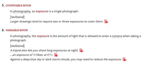

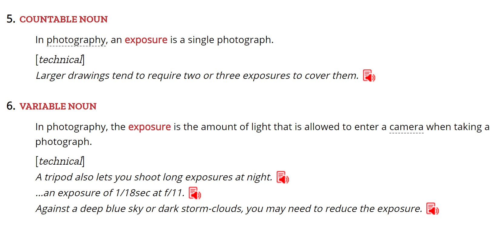

    i was referring to noun categories, open the link , as ive been saying forever ,exposure has many meanings. and the major companies use the one that's most fitting for the majority to understand.

    So what? Of course the word exposure can have different meanings. Some will say it's how light or dark an image looks and others will give the correct technical definition - amount of light that struck the sensor per unit area while the shutter was open.
    If I went up to any camera manufacturer's engineers and said I can change the image lightness in camera without altering the exposure* at all, they will say yep, that is correct. You don't have to change the exposure* to make an image lighter or darker. It really is as simple as that 😄
    Marketing/sales people and technical writers not fully understanding the basic 101 concepts of photography will write in manuals words to the effect of exposure being how light or dark an image looks, which is wrong and not even technically correct.
