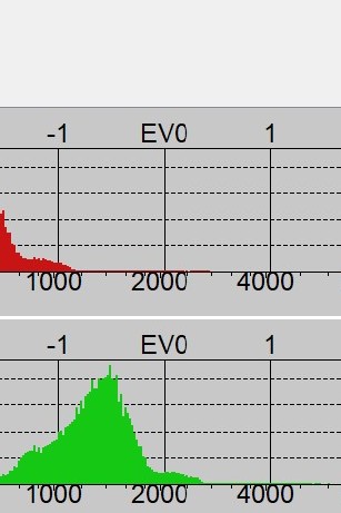

  • Members 2663 posts
    April 14, 2023, 8:44 p.m.
    Im still waiting after 300 posts why no one can explain what Ev"0" is in the image surely someone knows ,ive just had to ask Illah and waiting an answer.
    JPG, 26.5 KB, uploaded by DonaldB on April 14, 2023.
  • Members 243 posts
    April 14, 2023, 8:51 p.m.
    LOL!
