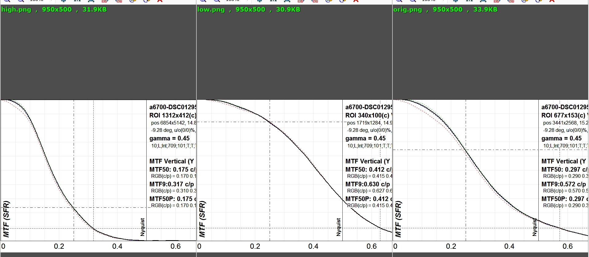

    July 28, 2023, 3:15 p.m.
    Out of interest, I took a review test image for the Sony a6700, the which image having a slant-edge in the middle.
    I re-sampled the image to 50% and 200% with Lanczos3 and then, at constant sensor size, plotted the MTF for all three images:
    Note that the MTF at 0.25 cycles/pixel is greatly different in each plot. No surprise to me and that probably means that Jim's preference for that frequency to indicate "microcontrast" is for the camera that he was testing and may not be a universal value for all cameras.
    JPG, 439.0 KB, uploaded by xpatUSA on July 28, 2023.

  • Members 1738 posts
    July 28, 2023, 8 p.m.
    Yes and no. Microcontrast means contrast at high frequencies. I was try to define frequencies that are high for any given Bayer CFA camera and below Nyquist.
