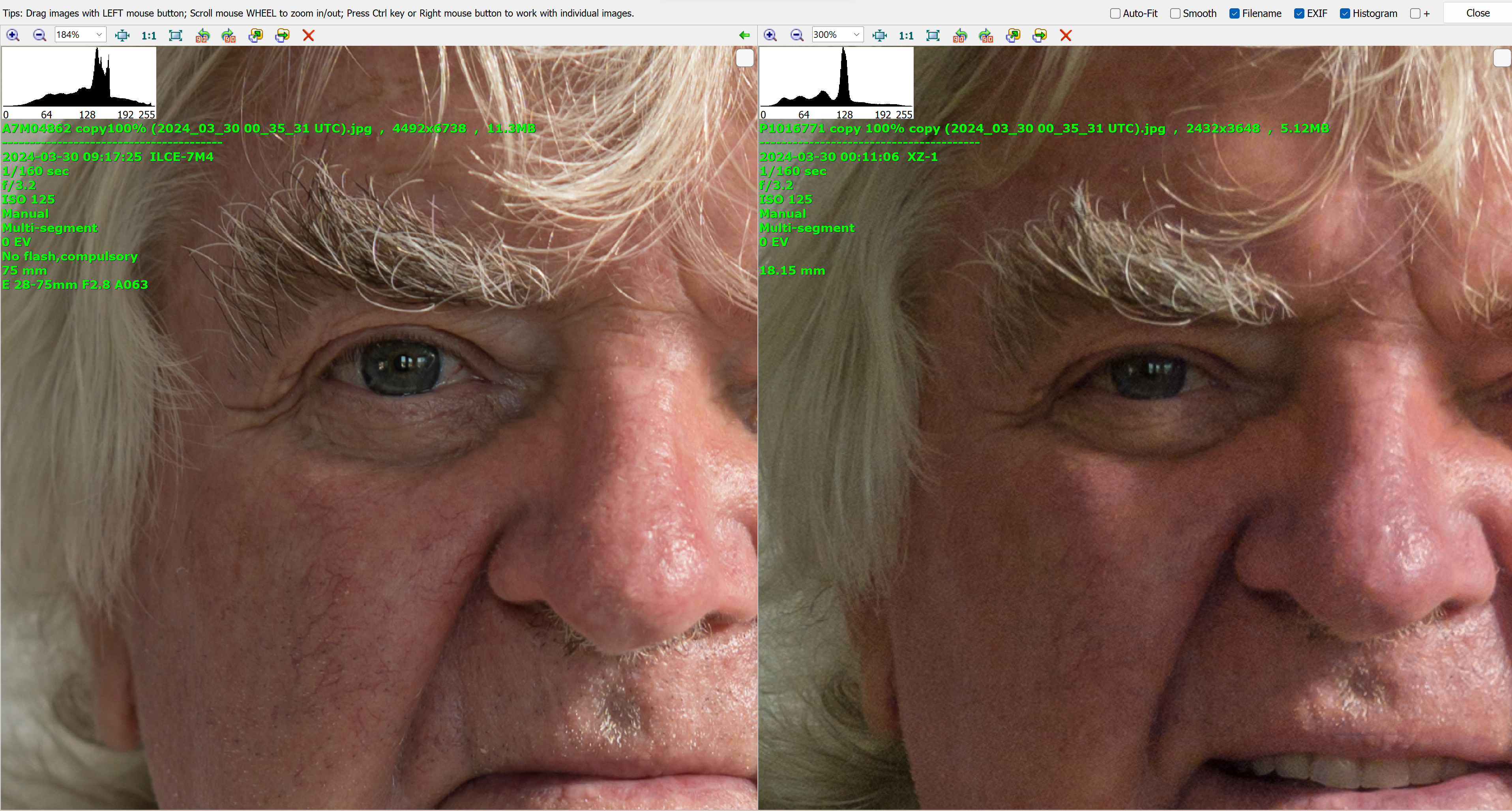

    please explain further.

    It's the lens, not the sensor. The aperture diameter of the lens for the left photo was 75 / 18.15 = 4x as large, resulting in 16x the area, hence 16x the light projected on the sensor for the same scene and exposure time, thus 1/4 as noisy (if the sensors record the same proportion of light projected on them and add in the same amount of electronic noise, both of which are likely more or less the case).

    the problem with your maths is that the a7iv can recover 4 stops of shadow detail effortlessly.
  • March 31, 2024, 9:40 p.m.
    That's not a problem with his maths. It's a problem with your mixing up of different concerns. The XZ-1 is an old CCD camera. CCDs were never great at dynamic range. But dynamic range is not the same as noisiness.

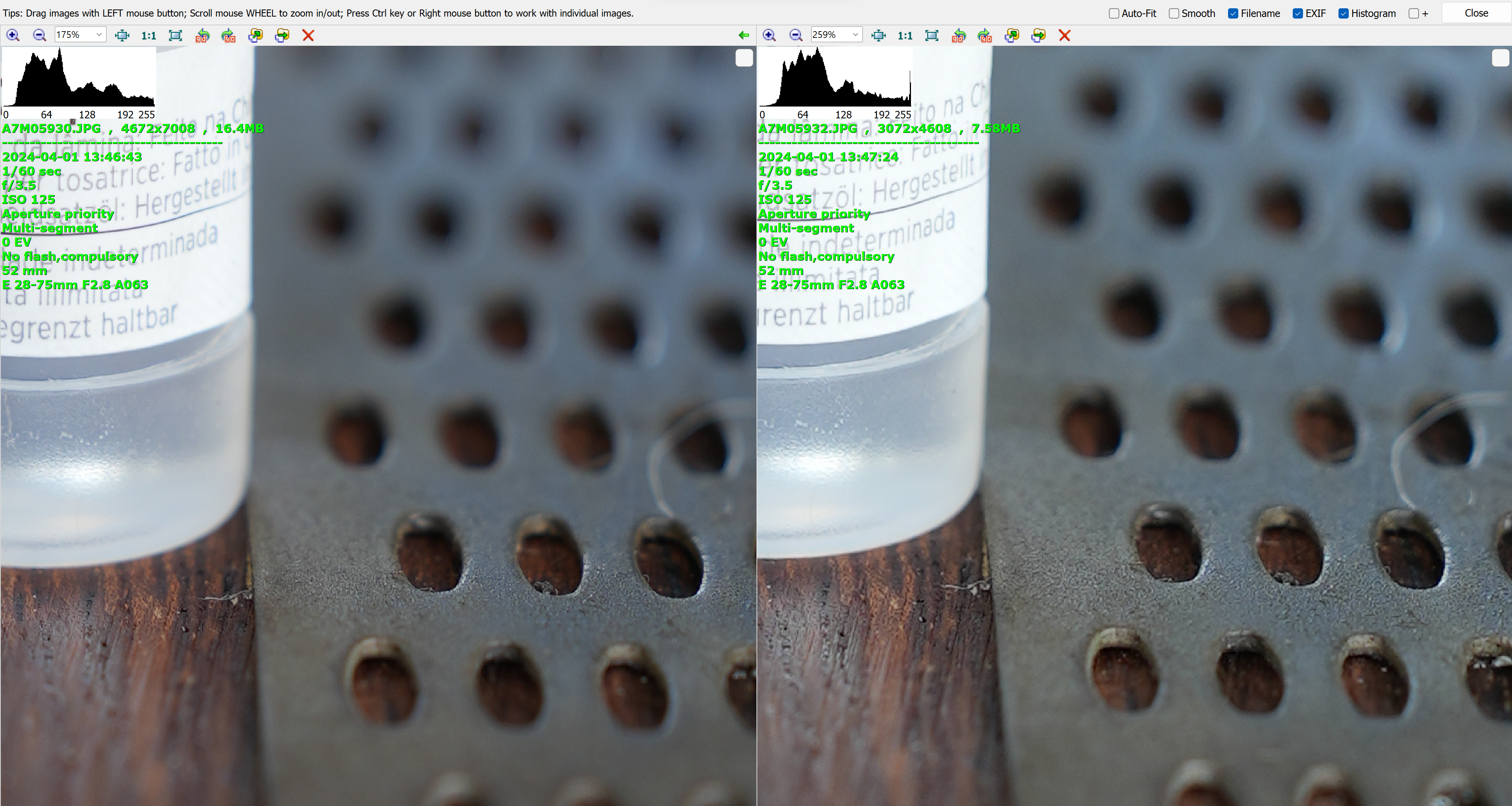

    this is what happens when you change sensor size from FF to apsc using the same lens
