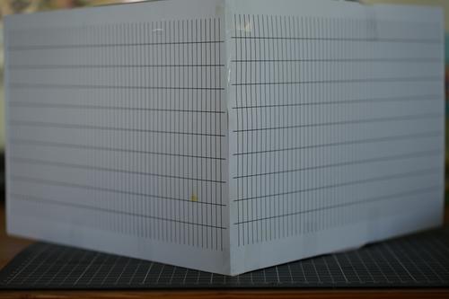

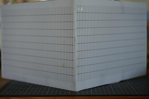

  • Members 2654 posts
    April 2, 2024, 11:14 p.m.

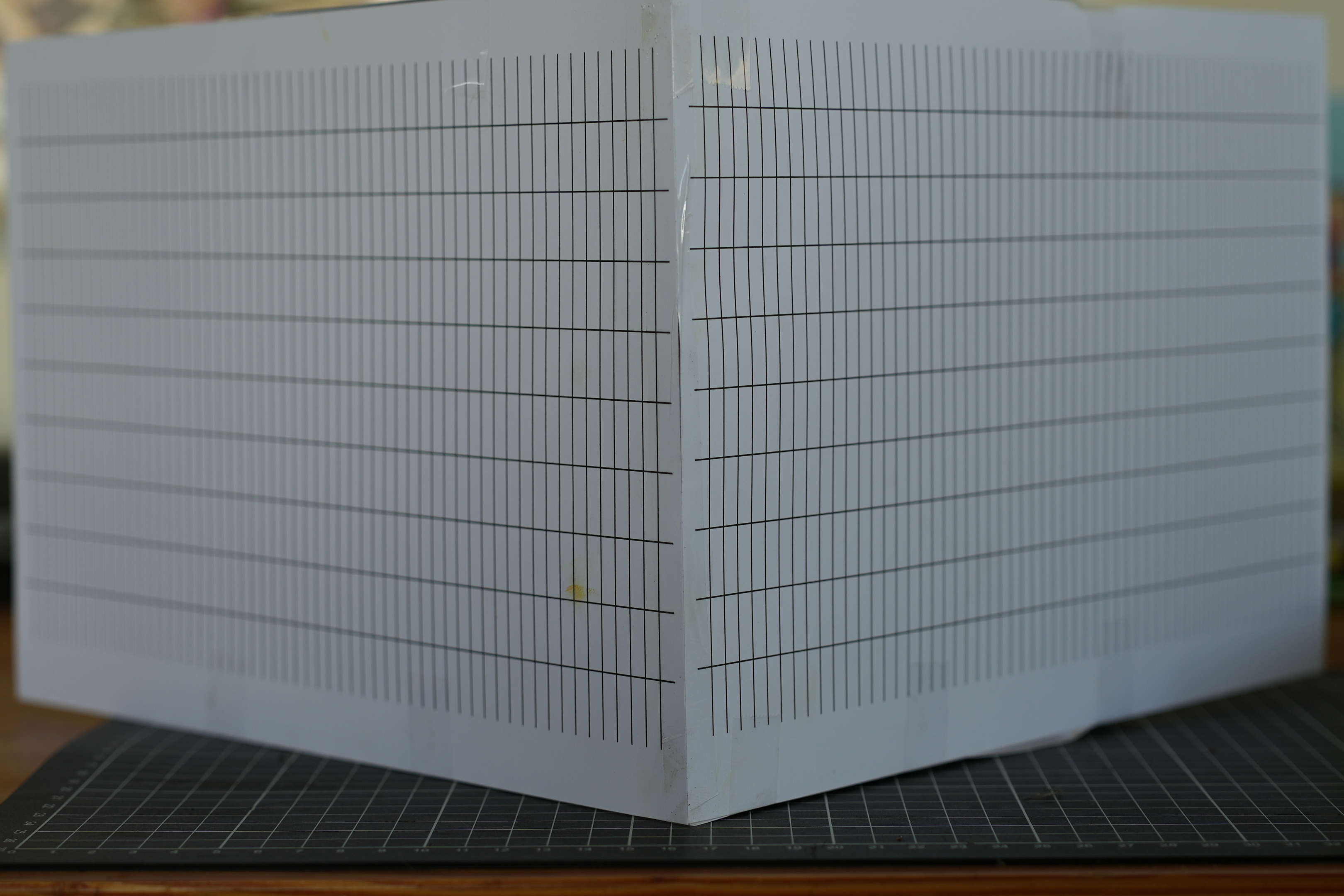

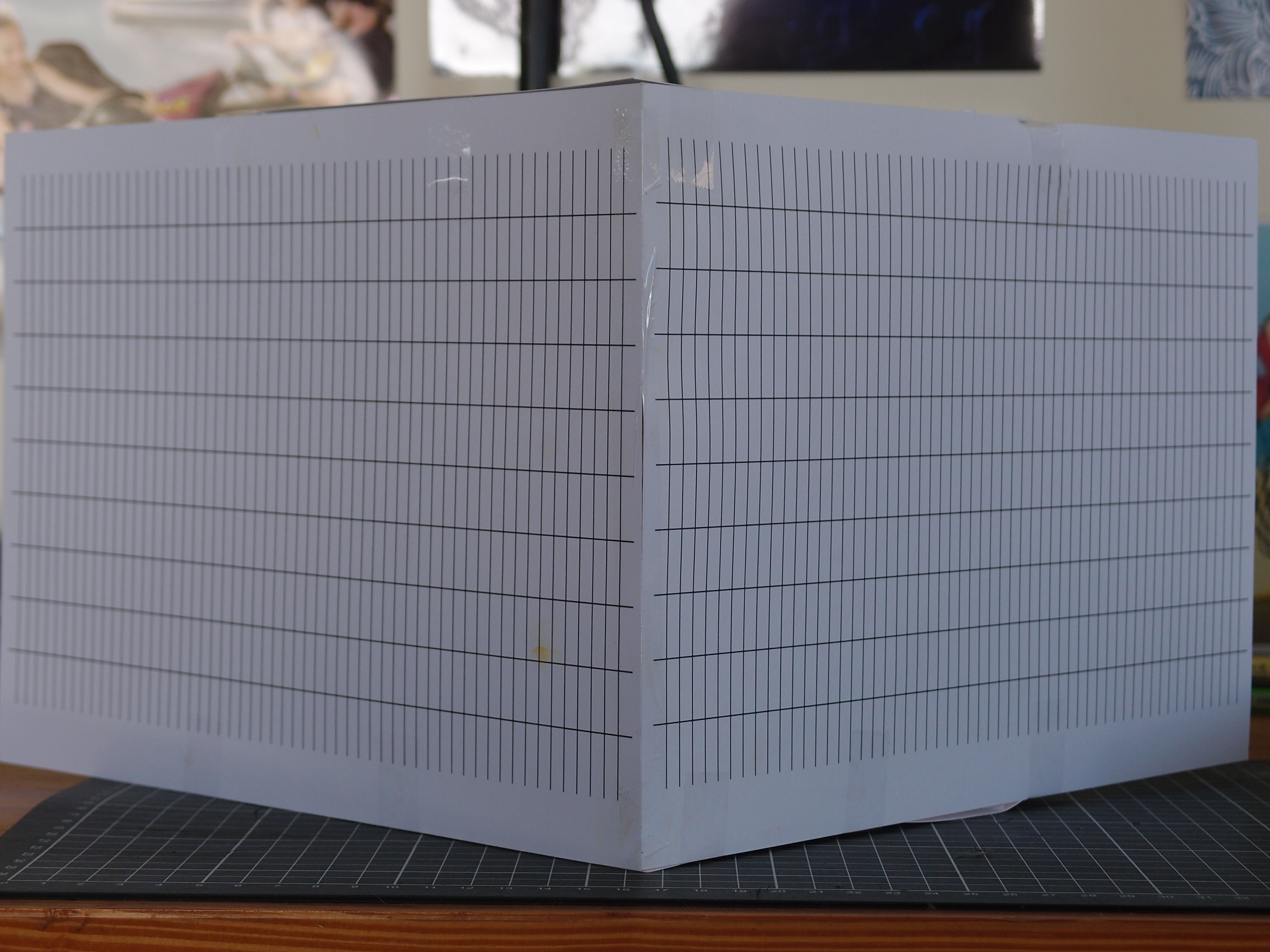

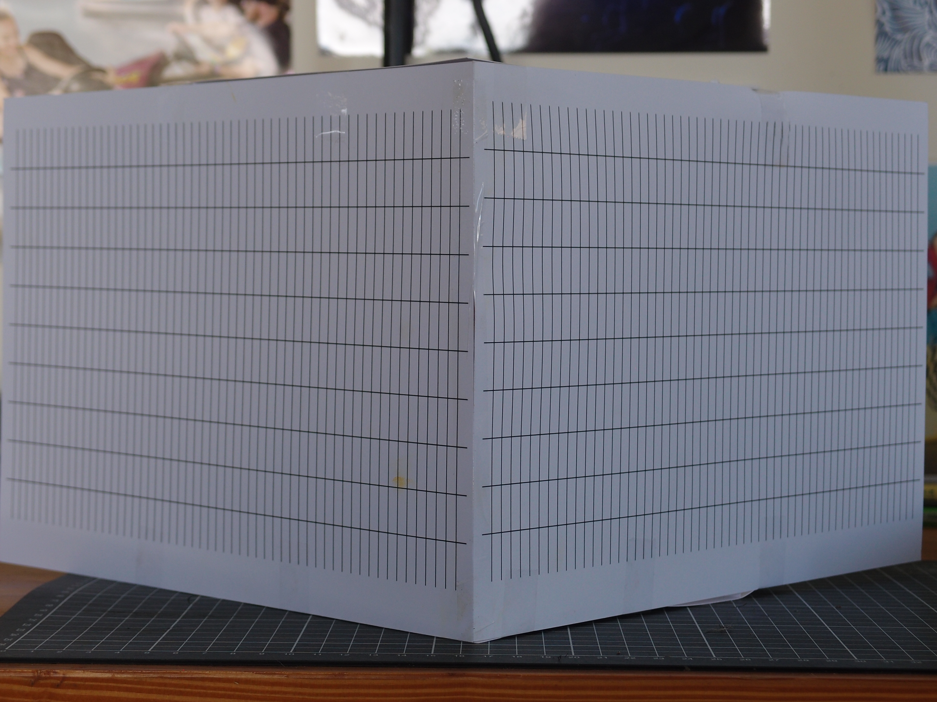

    another test. apsc vers FF equivalent fov same camera position.
    JPG, 3.3 MB, uploaded by DonaldB on April 2, 2024.
    JPG, 2.9 MB, uploaded by DonaldB on April 2, 2024.

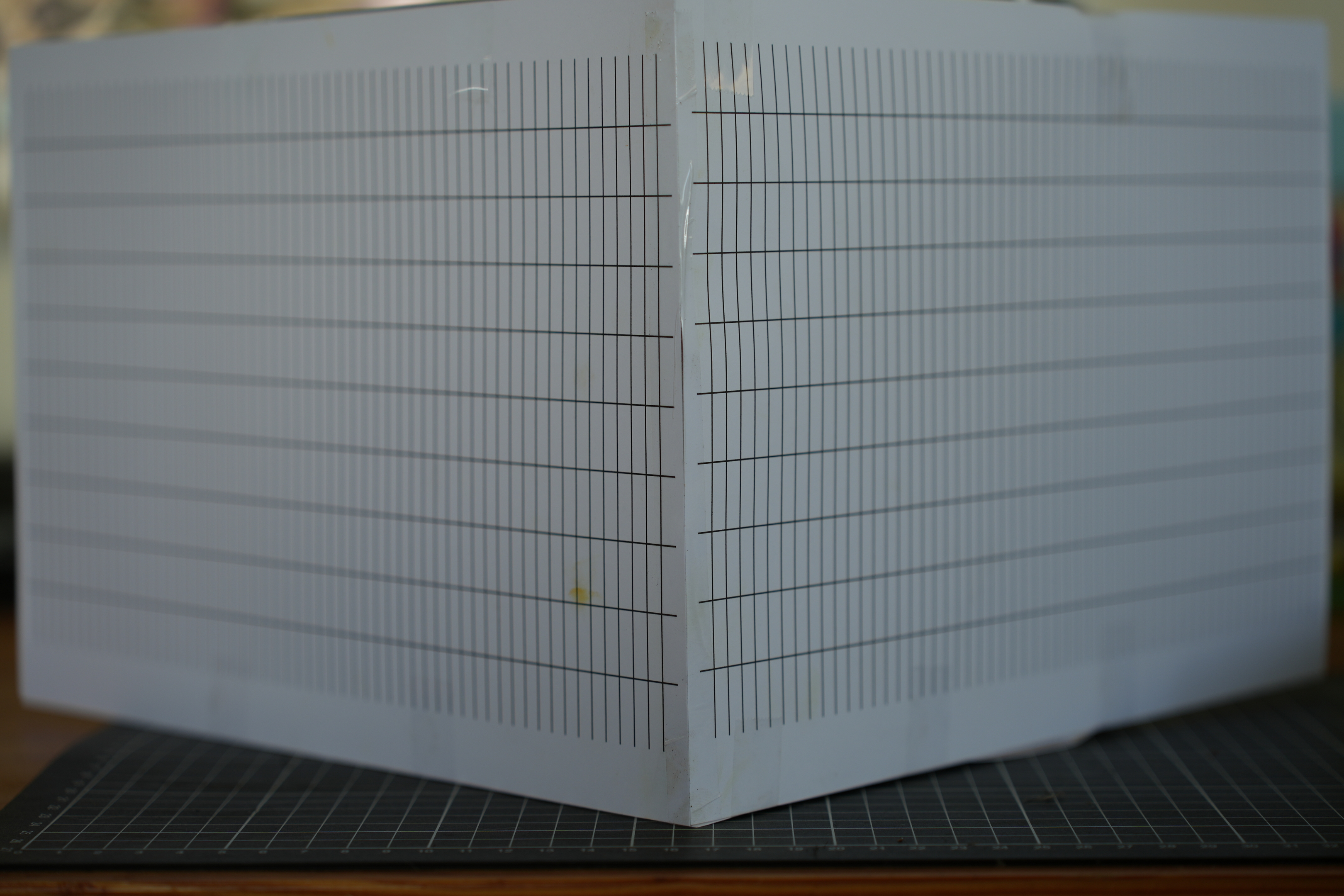

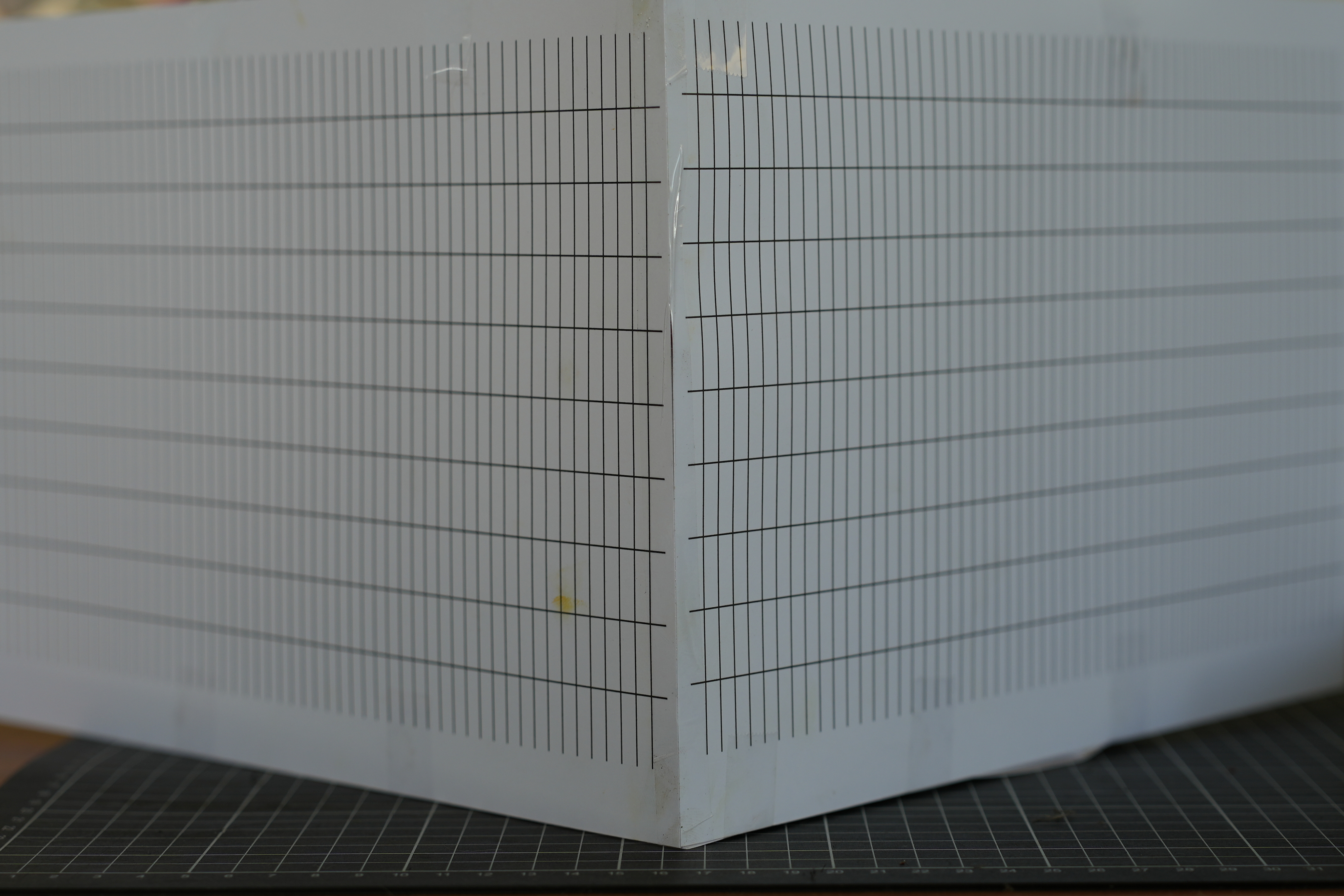

    April 2, 2024, 11:17 p.m.

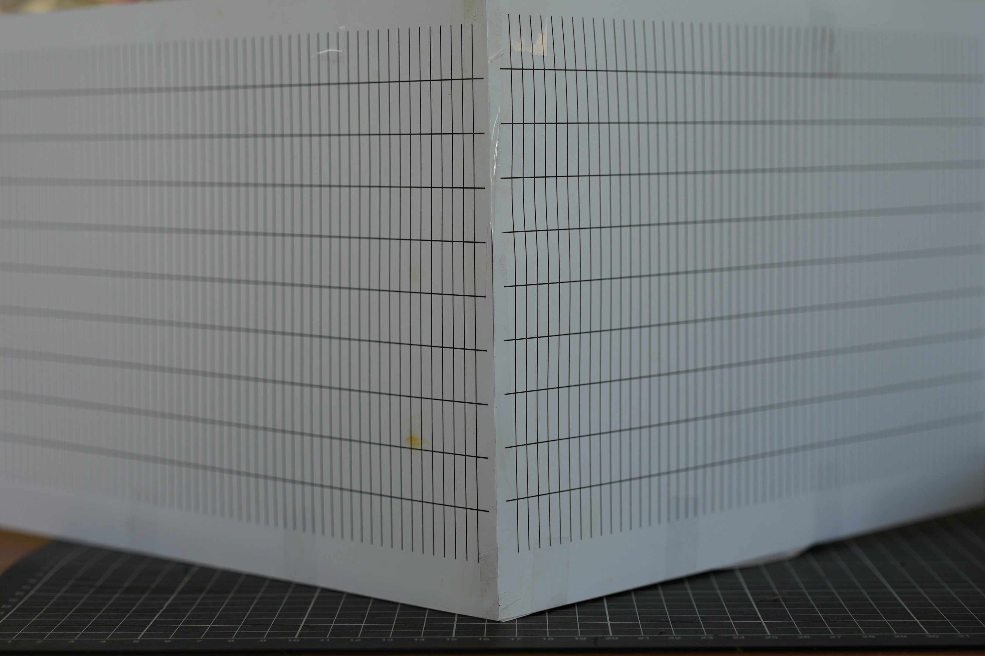

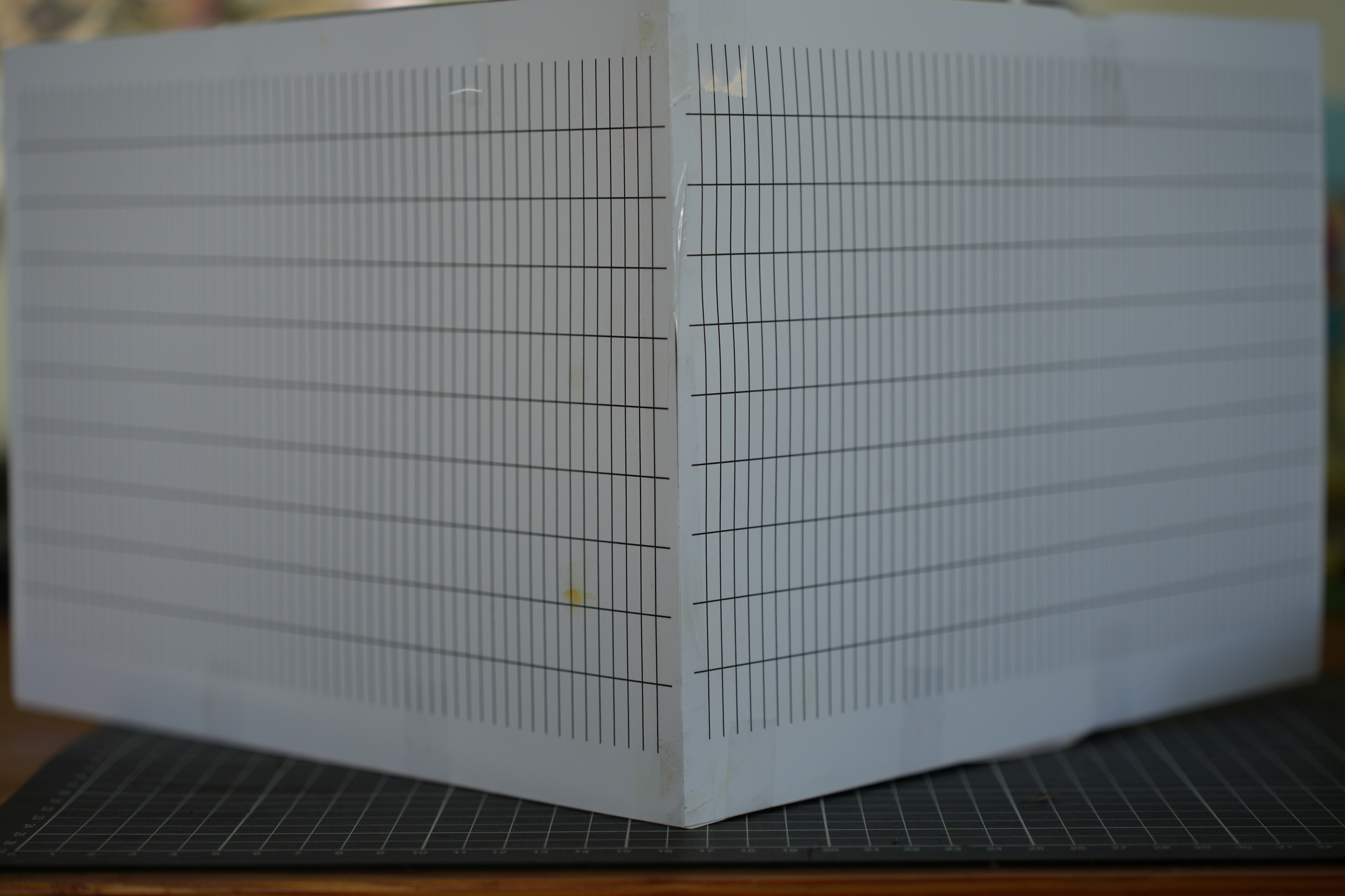

    same focal length moved camera for same fov. is my exif data showing ? because its not on my computer. 🤨but everyone elses is.
    JPG, 3.1 MB, uploaded by DonaldB on April 2, 2024.

  • Members 171 posts
    April 3, 2024, 12:05 a.m.
    What do you see in those results?
    What do you conclude from them?
    Do you believe they disprove things that others here believe about equivalence? If so, what things?

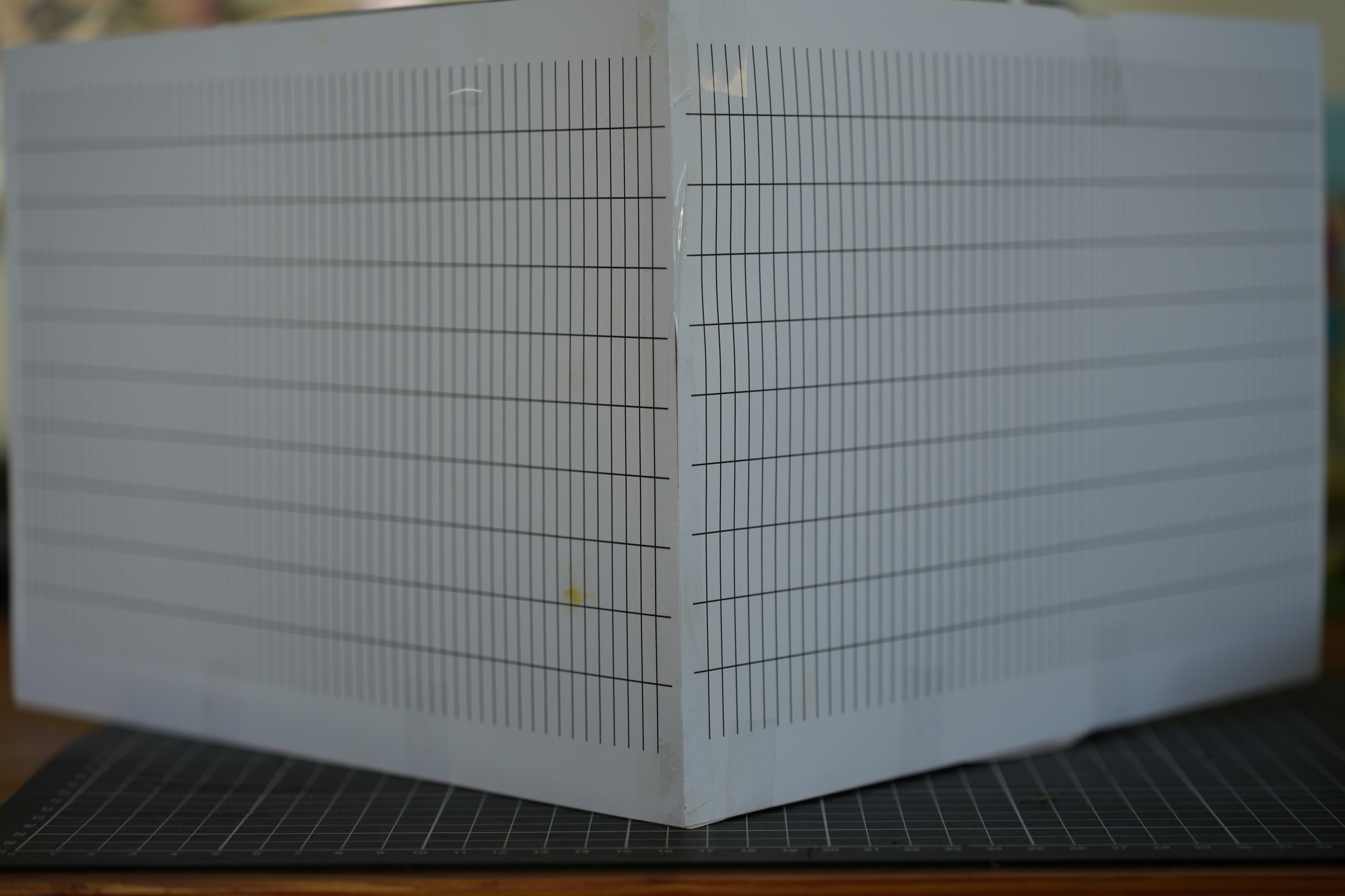

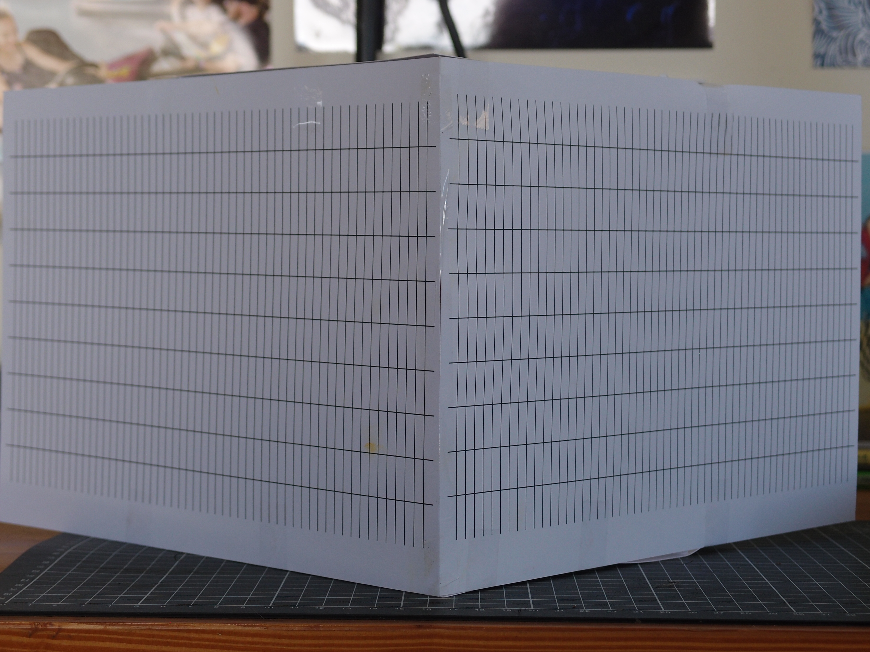

    April 3, 2024, 8:16 a.m.

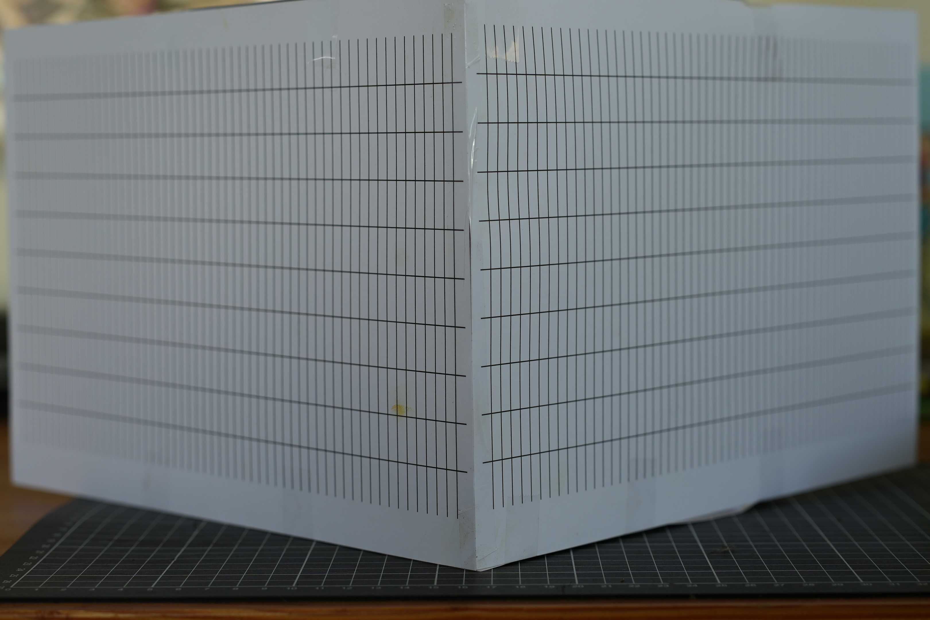

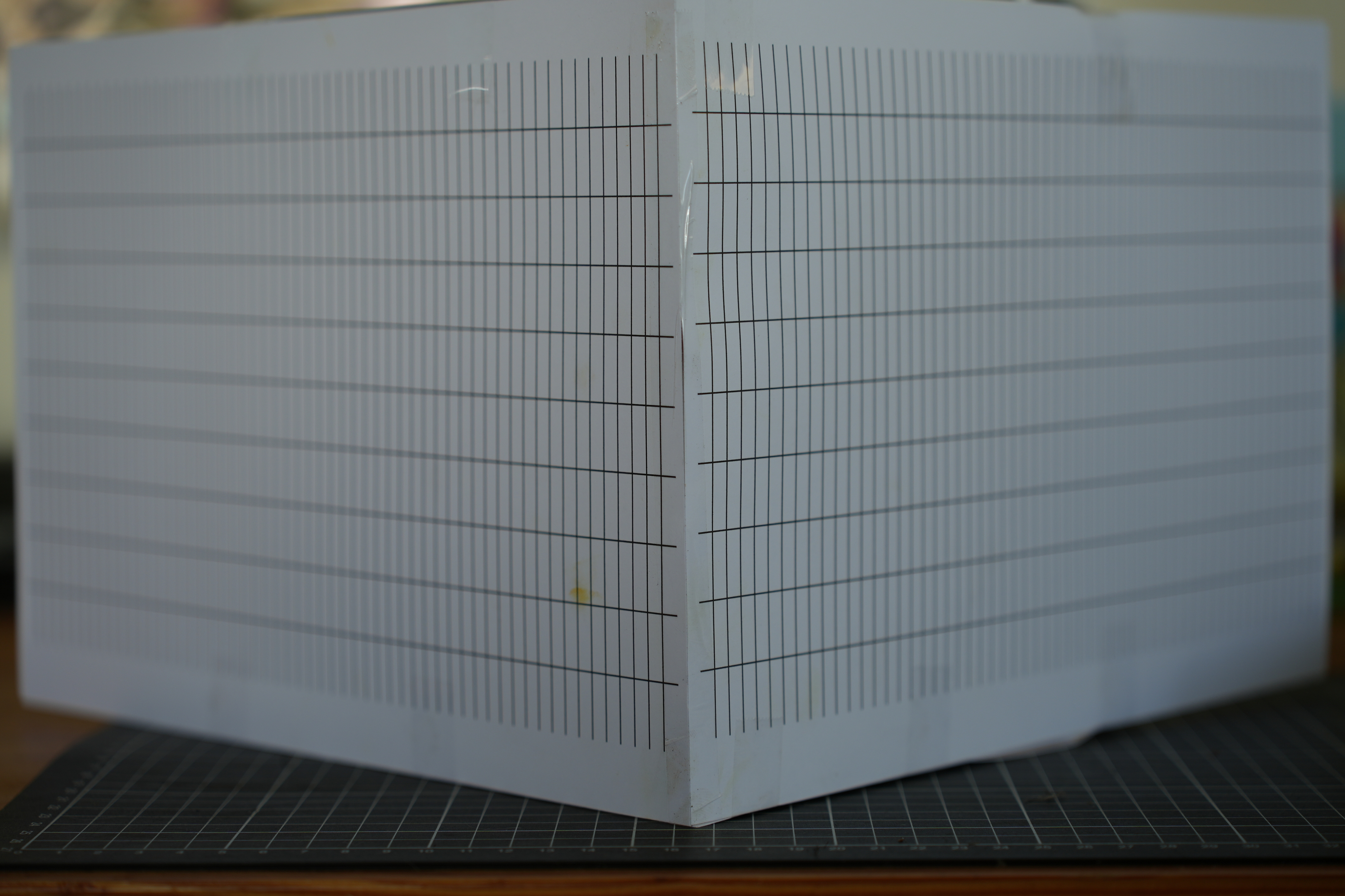

    shooting close ups is a lot less noticeable from the first set of images i posted.
    JPG, 4.2 MB, uploaded by DonaldB on April 3, 2024.
    April 3, 2024, 9:47 a.m.
    Those photos mean zero and show nothing really.
    If you want to compare DOF's you should string out a tape measure on the ground for at least a couple of metres and photograph it under different conditions to compare the DOF's along the tape measure in the various shots.
