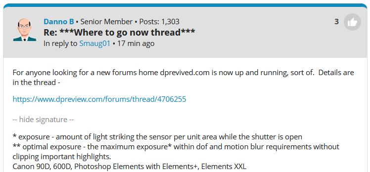

    Danno,
    I concur. I actually screenshot your DPR signature a few weeks ago when I thought the site was going down because it was clear, simple and correct.
    I've received "exposure triangle" handouts from photographers whom I know comprehend why it's wrong, but they claim it helps people to understand. Best I can get from them is an agreement to disagree, and I scratch out "exposure triangle" and replace it with "image lightness triangle" on my own copy.
    If people don't agree on definitions (and this thread provides a good example), the rest of the discussion can't move forward.
    Sherm
    PNG, 45.6 KB, uploaded by shermlevine on April 10, 2023.
