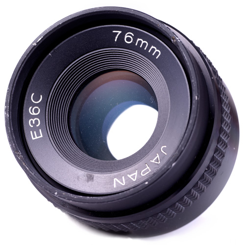

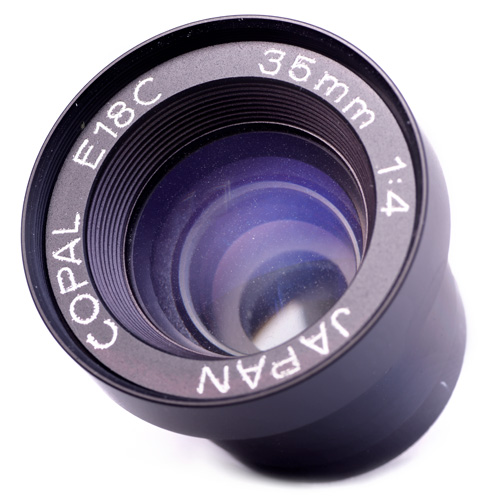

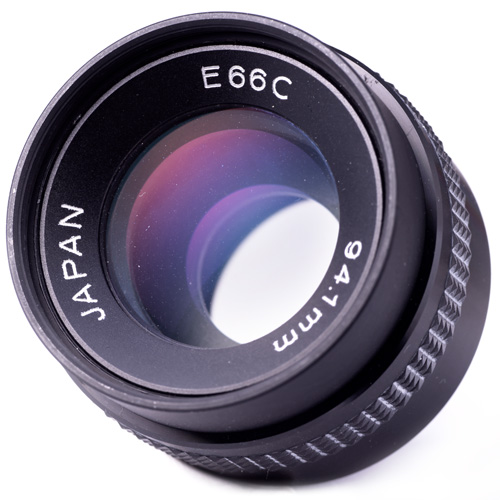

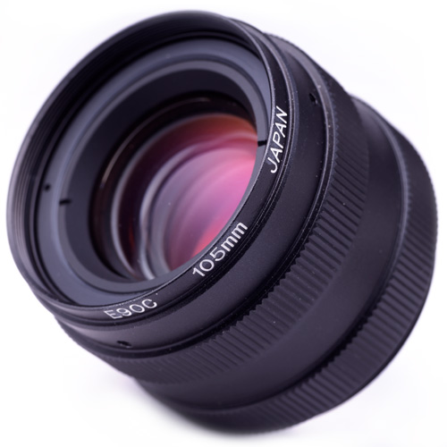

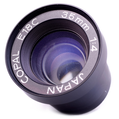

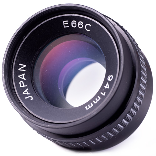

    Thanks! I don't know anything about film sizes, but it's quite interesting to me regardless. Hope it's okay if I ask a slightly related question:
    My favorite series of lenses is one which was supposedly used in several kinds of minilabs/professional processing machines. They were made in a range of focal lengths and all of them are labeled with a number, which I suspect might indicate the film sizes they were used to process. There are the following:
    E18C - in focal lengths of 35 and 40 mm (which might correspond to the 18x24 mm format)
    E36C - in focal lengths from 48 to 100 mm (probably for the 24x36 mm format)
    E66C - in focal lengths from 75 to 94.1 mm (?? - I thought perhaps made for max. 6x6 cm format, if that's a thing which was processed in such labs?)
    E90C - in focal lengths from 105 to 125 mm (?? - any idea?)
    There's no definitive proof of that theory being correct, but if we assume that the number has to do with the format they were designed for, I would really be interested in your thoughts. I can try to measure some of the image circles of the lenses in question, which could probably give a good indication of the possibilities.

  • June 26, 2023, 7:22 p.m.
    That's interesting. Do you know which company was the manufacturer?
    In any case, if we started with the E36C as being for 24x36, with a 43mm frame diagonal, that would make the E18C fit a 21.5mm frame diagonal, which was 110 (or, nowadays 'Four Thirds').
    E66C would correspond to a 79mm diagonal, which does indeed give 56x56mm or 6x6.
    E90C would give a 107mm diagonal. 6x9 is 56x84mm which is 101mm diagonal, which is I guess what it's for, with a little leeway either in the frame size of the naming.

  • Members 1913 posts
    June 26, 2023, 9:23 p.m.
    Thanks a lot for that information - that's very interesting. Will have to look up how to check if those values are realistic for the respective lenses I own. I'm sure there are some tutorials on how to measure image circle... if you know some easy ones, please let me know!
    Indeed. Tomioka surely was the manufacturer of a majority of those lenses. Many are labeled "Tomioka" or "Tominon" after all... It's not clear though, if they were also responsible for the lenses, which are only labeled "Copal" and "EXXC" (18, 36, 66, 90). As far as I know Copal produced lenses themselves and they also had other suppliers, as I've learned from some conversations with a person who worked there.

    Oh - wow! Didn't expect that kind of information... thank you so much! So all of these are likely Tomioka made as well?
    Copal_E18C_35mm_F4.jpgCopal_E36C_76mm_F4.jpgCopal_E66C_94-1mm_F4.jpgCopal_E90C_105mm_F4-5.jpg
    I knew about the Tomioka manufacturing connection to Zeiss (Contax/Yashica) but I wasn't aware of the fact that it extended to a certain degree to the industrial lenses they made as well.

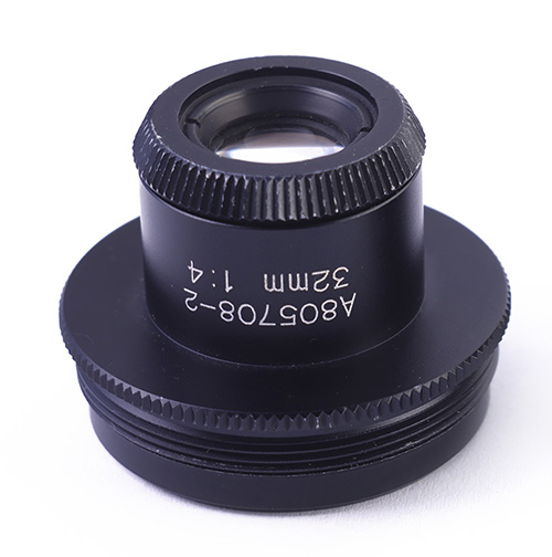

    What do you mean by "Noritsu M42"? Do some of those lenses exist in a different mount for Noritsu machines? I'm in the middle of finishing an article on Noritsu (another series of lenses I'm very interested in) and while I have seen quite a few, I've never been able to discover a single EXXC lens actually labeled Noritsu, nor have I found one with a M42 mount. All the fixed focal length ones I own have a 40x0.75 mm mounting thread, like the excellent 32 mm f/4:
    Robert OToole has pretty definitive proof though, that some of those lenses were used in Noritsu machines, so it wouldn't surprise me if lenses like that existed.
