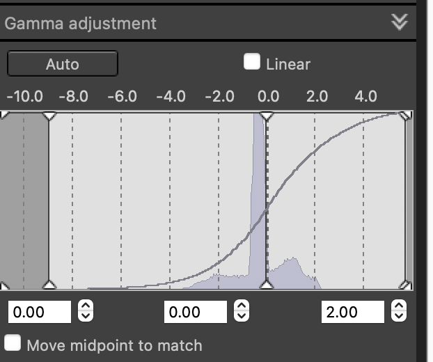

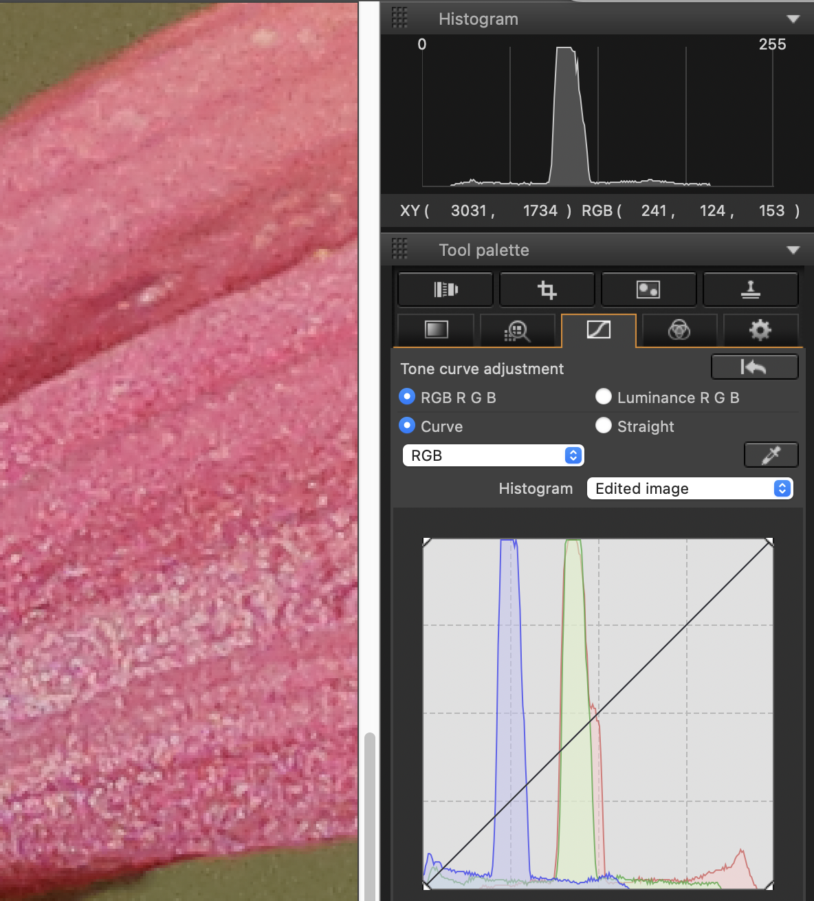

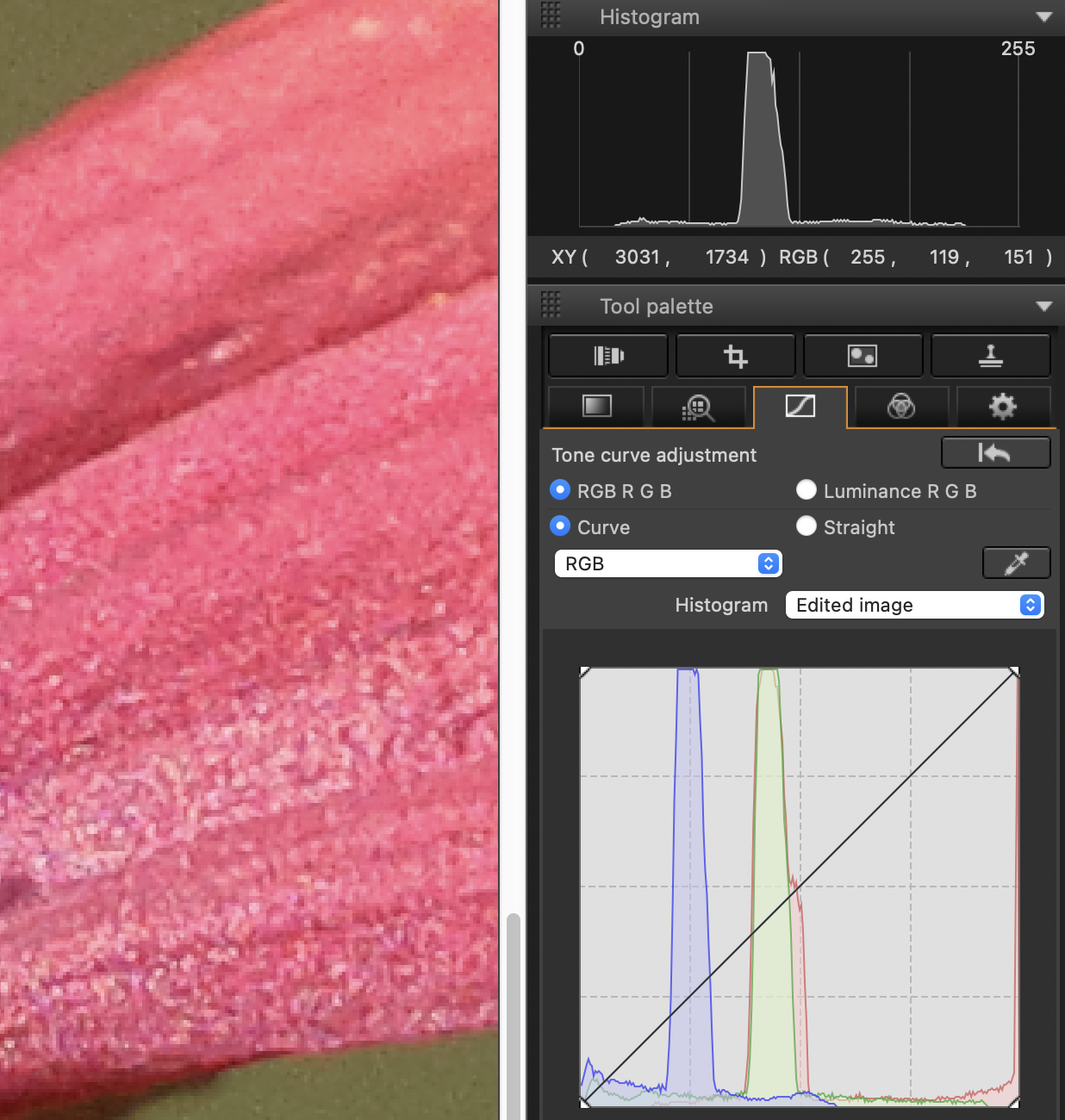

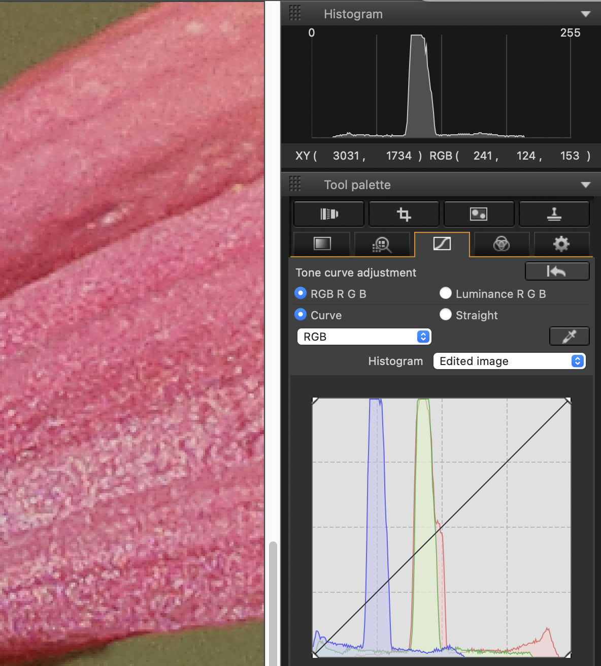

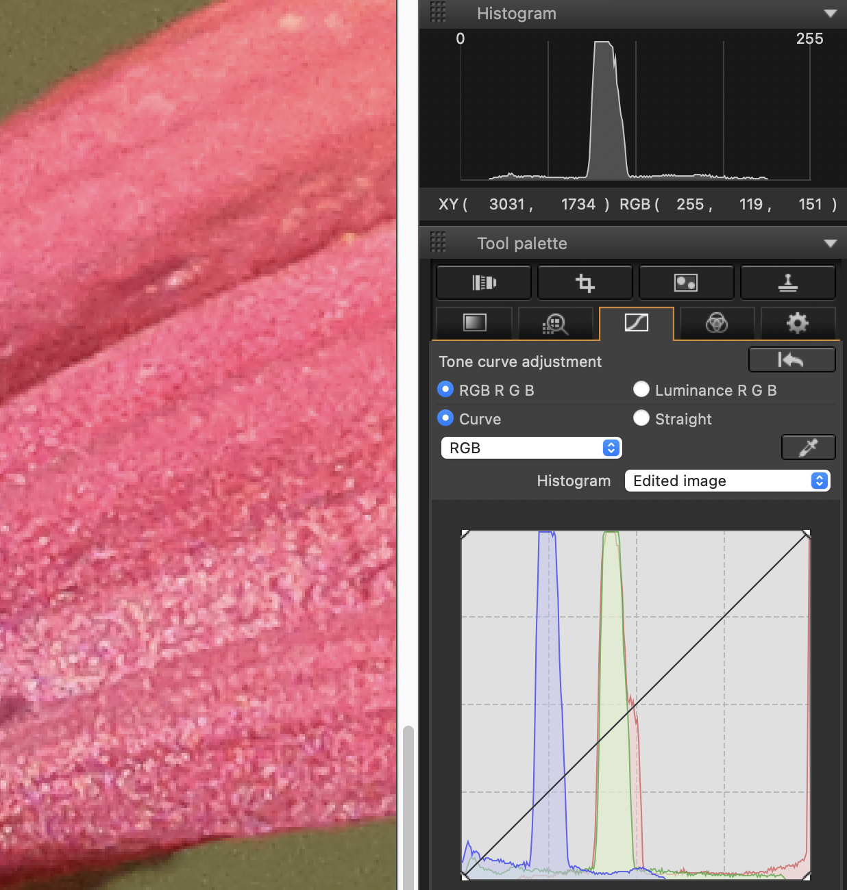

    While I have no doubt that fastrawviewer is an excellent program because I have read much of the libraw source code, I choose to use free software as much as possible. Some of that software is free as in free speech and other is only free as in free beer. I would not discourage anyone from purchasing fastrawviewer, even though I see no need for it myself. I expect that many will find fastrawviewer very useful. There is more than one way to do things.
    Since I have a Canon camera, I use the Canon DPP software on my iMac. As soon as Debian Bookworm is released as "stable", I will likely use rawtherapee some of the time as I used it when my camera was supported. If I had a Nikon camera, then I would use the free software that Nikon offers.
    In DPP:
    But if I go to the basic tab and move the input range to plus 2.0:
    then it seems to me that I can see a histogram of the full range of data captured:
    So far as I can understand, I have increased the dynamic range of the input data included and changed the shape of the gamma curve to compress that range into sRGB for display. Now none of the pixels have a red value of 255. But, the color space is distorted. It might still make an attractive photo of a red flower in sunlight.
    Your mileage may vary.
    PNG, 1.5 MB, uploaded by JohnMoyer on June 1, 2023.
    PNG, 117.6 KB, uploaded by JohnMoyer on June 1, 2023.
    PNG, 1.6 MB, uploaded by JohnMoyer on June 1, 2023.

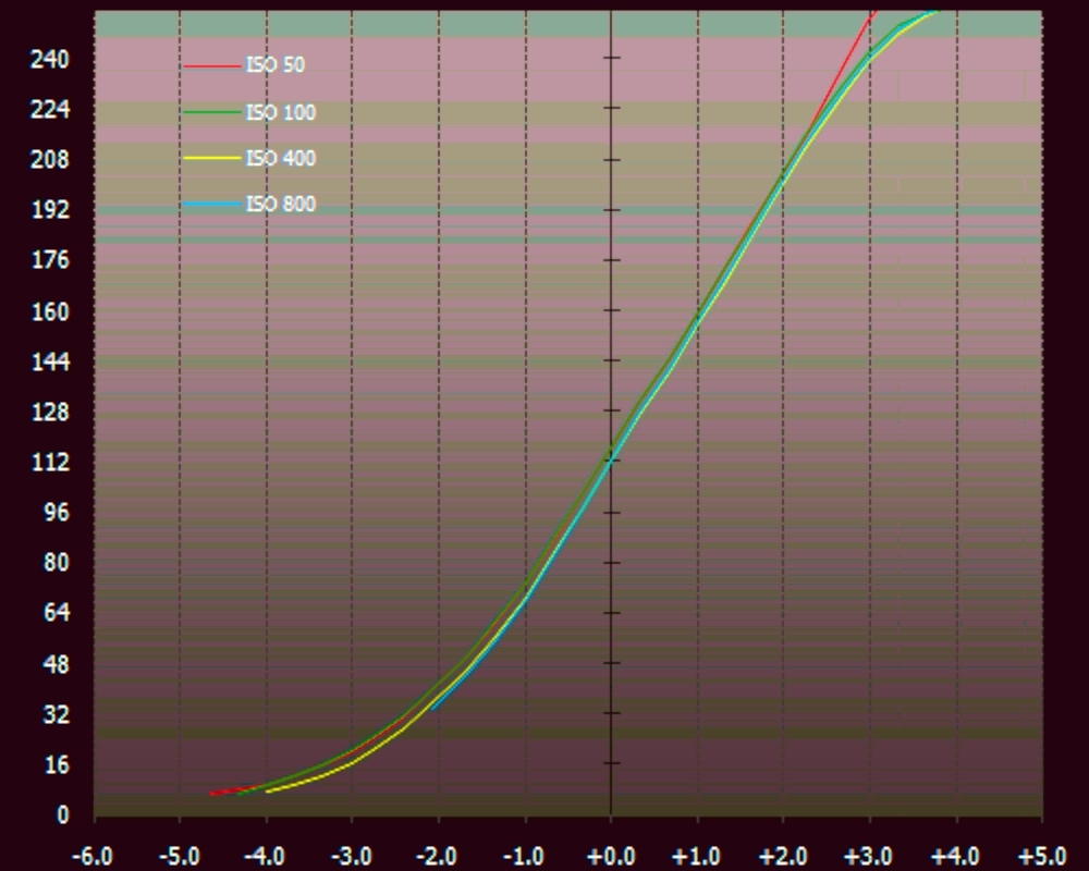

    Your 'S' shaped curve is quite similar to DR test curves over on the other site - going from illuminance from their test strip to sRGB.
    The 'S' shaped curve does reduce contrast** at low and high illuminances. One camera I had actually tested with a straight line at 50 ISO going up to 255 sRGB (see above). Good for clouds, eh?
    ** contrast in this context being the slope of the transfer curve.
    JPG, 284.4 KB, uploaded by xpatUSA on June 1, 2023.
  • Members 83 posts
    June 1, 2023, 5:33 p.m.
    I have heard the S shape described as toe and shoulder. It seems to me a good default most of the time.
    Instead of contrast, I usually think of it as the spacing of the mapped values. Quantization.
