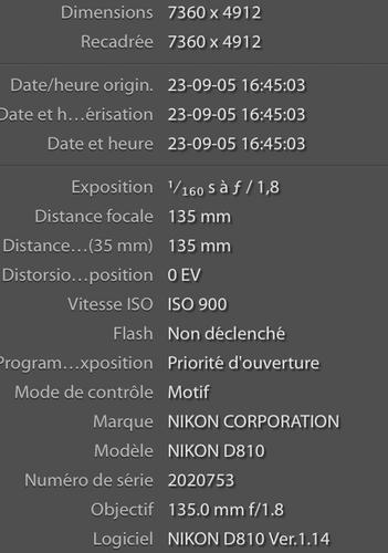

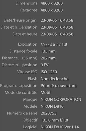

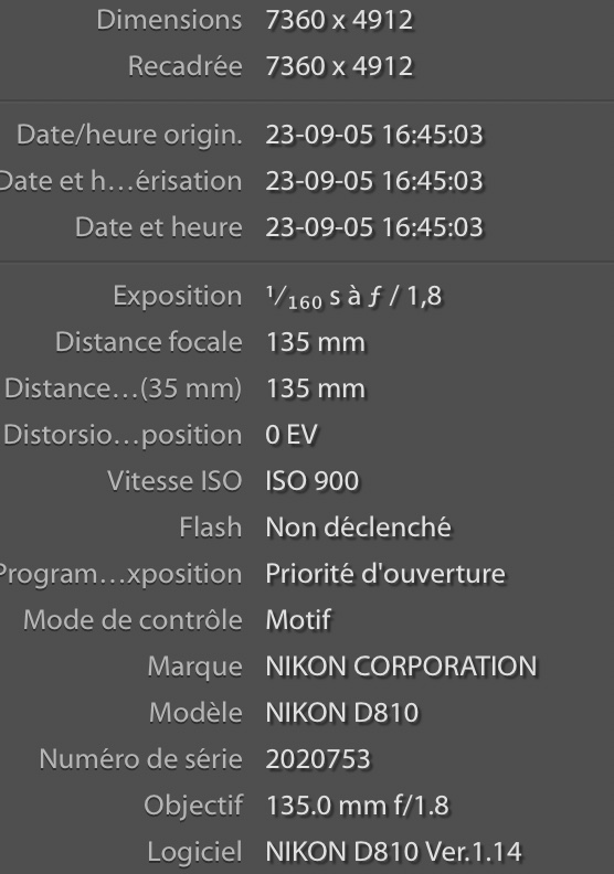

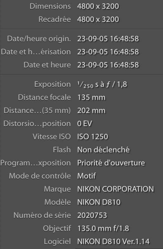

    I'll ask you the same question
    If I take a picture with my D810 FF and my 135mm at f/1.8
    And I take a second photo with my D810 (Image area DX (24x16) 1.5x = 202.5mm still at f/1.8
    At what aperture did I take my second photo? 😎
    The answer is here in LR, see the info on captures.
    JPG, 97.7 KB, uploaded by Maoby on Sept. 5, 2023.
    JPG, 95.2 KB, uploaded by Maoby on Sept. 5, 2023.

    Actually, the answer is the following: you took both photos with a focal length of 135 mm and an aperture of 135 mm / 1.8 = 75 mm. The second photo was cropped to an equivalent focal length of 135 mm x 1.5 = 202.5 mm with the same aperture of 75 mm, yielding an equivalent f-number of 202.5 mm / 75 mm = 2.7. Thus, 135 mm f/1.8 cropped by a factor of 1.5x is equivalent to a photo taken at 202.5 mm f/2.7.
    Specifically, photos of the same scene taken from the same position with the same exposure time, one at 135 mm f/1.8 cropped by a factor of 1.5x, the other at 202.5 mm f/2.7, both displayed at the same size, will have the same perspective, the same framing, the same DOF, the same noise. In fact, the main difference between the two will be resolution, since the cropped photo will be made with only 44% the number of pixels, and the differences in the sharpness of the Sigma 135 / 1.8 and whatever lens you're using at 200 mm f/2.8 probably isn't nearly as much as a factor as the difference in the pixel counts with regards to resolution. Bokeh, distortion, flare, etc., might look different, though.
    And, in fact, this is extremely easy to verify. Take a photo of a scene at 135 mm f/1.8 and then take another photo of the same scene at 200 mm f/2.8 (where f/2.8 is easily "close enough" to f/2.7 for the purposes of this experiment) from the same position with the same exposure time (use whatever ISO settings give you the desired lightness). Crop the former to the same framing as the latter. Display both photos at the same size. Post them here, if you like. Tell us what you see and we'll tell you what we see.

    No, that's not the problem at all. The problem is that you think a 135 / 1.8, when mounted in front of a 1" sensor (2.7x), becomes a 364.5 / 1.8 and that when a 135 / 1.8 is used on a FX sensor in [1.5x] crop mode, it becomes a 202.5 / 1.8. This is simply false. Completely and totally false.
    But I didn't. I directly answered your question. Here's your question again:
    And my answer was:
    Too many words? I'll shorten it: you took the second photo with an aperture of 75 mm. That's it. That's the answer to your question. Now, what f-number did you take the photo at? That's probably what you meant. Well, if the focal length is 135 mm, which it is, then the f-number is 135 mm / 75 mm = 1.8, which it is. If the equivalent focal length after the crop is 202.5 mm, which it was, then the equivalent f-number was 202.5 mm / 75 mm = 2.7, which it is.
    Yes, it is. Put a lens that can shoot f/1.8 on the camera and take the photo. There's another direct answer to your new question. Adding to that answer, if, for example, you put a 135 / 1.8 on an mFT camera, and take a photo wide open, then the focal length is 135 mm and the f-number is 1.8. The aperture is still 135 mm / 1.8 = 75 mm. So, if you want to convert to the equivalent settings for FF, then you apply the crop factor to both the focal length and f-number: 135 mm x 2 = 270 mm and 1.8 x 2 = 3.6. So, a 135 / 1.8 on an mFT camera is a 135 / 1.8. Full stop. However, if you want to know its equivalent in FF terms, it is equivalent to a 270 / 3.6 on FF.

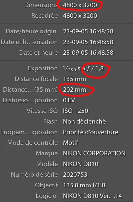

    JPG, 78.8 KB, uploaded by Maoby on Sept. 6, 2023.

    Did you notice where it said "Distance focale 135 mm"? That means the focal length is 135 mm. Did you notice where it said "Distance...(35 mm) 202 mm"? That means the FF equivalent focal length is 202 mm. Did you notice that it did not say "Exposition...(35 mm)"? That's because it didn't give the equivalent f-number. It only gave the actual f-number, which, of course, corresponds with the actual focal length.
    Again, if you have a 135 / 1.8 lens, neither the focal length nor aperture, which are both physical attributes of the lens, change when mounted on sensors of different sizes. However, the equivalent focal length and f-number absolutely change as a function of the size of the sensor, and they both change in the same proportion.
