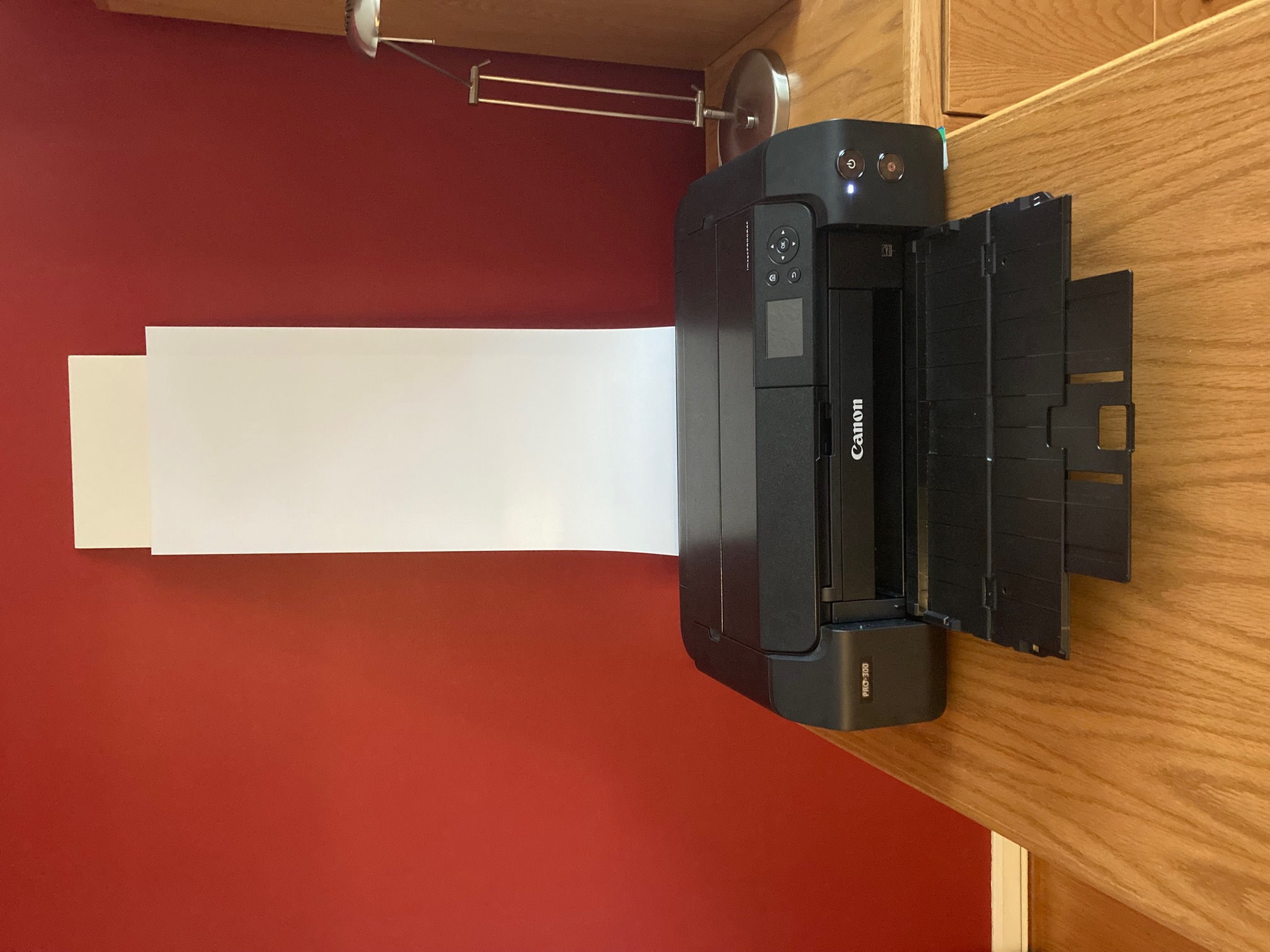

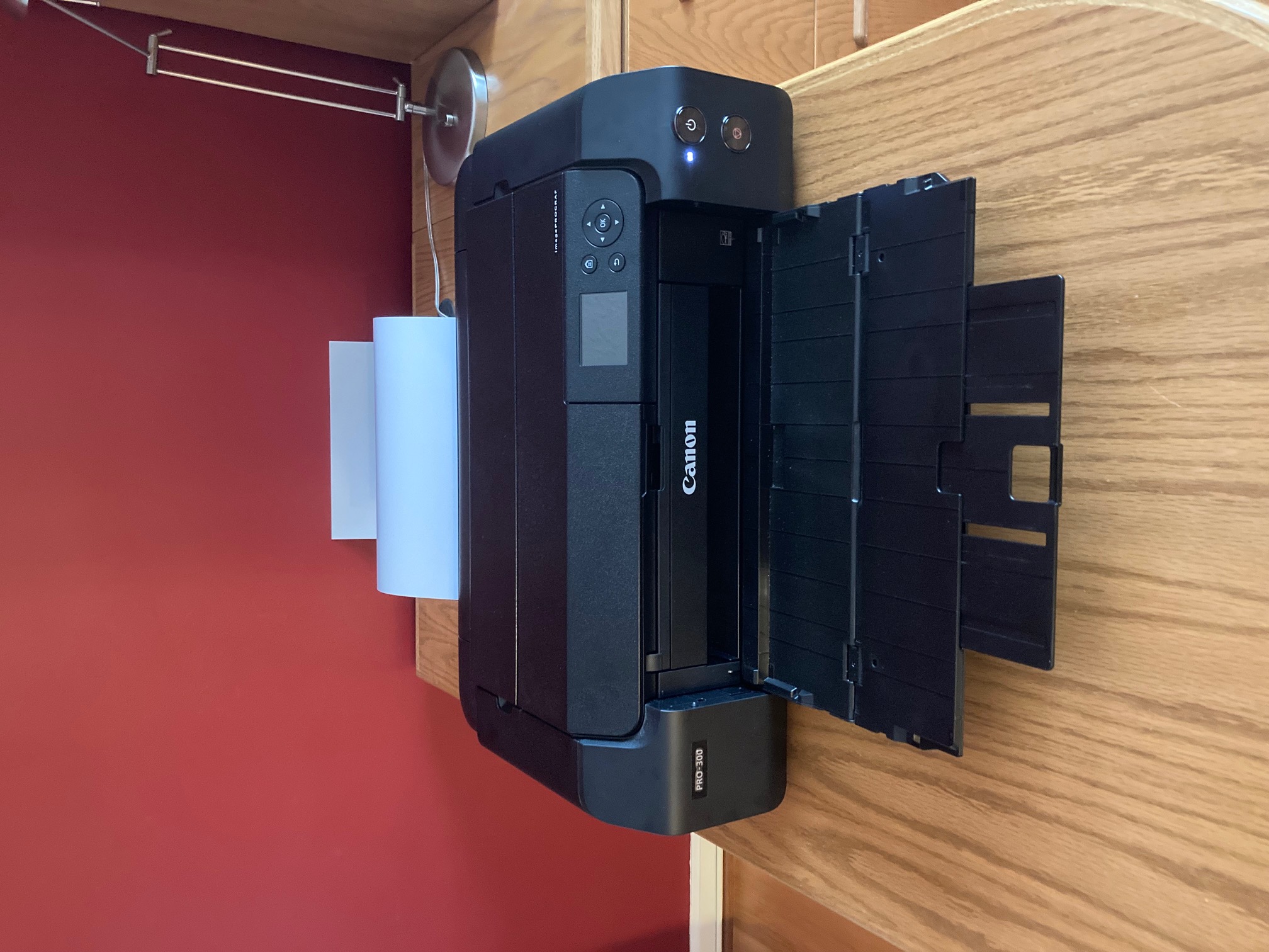

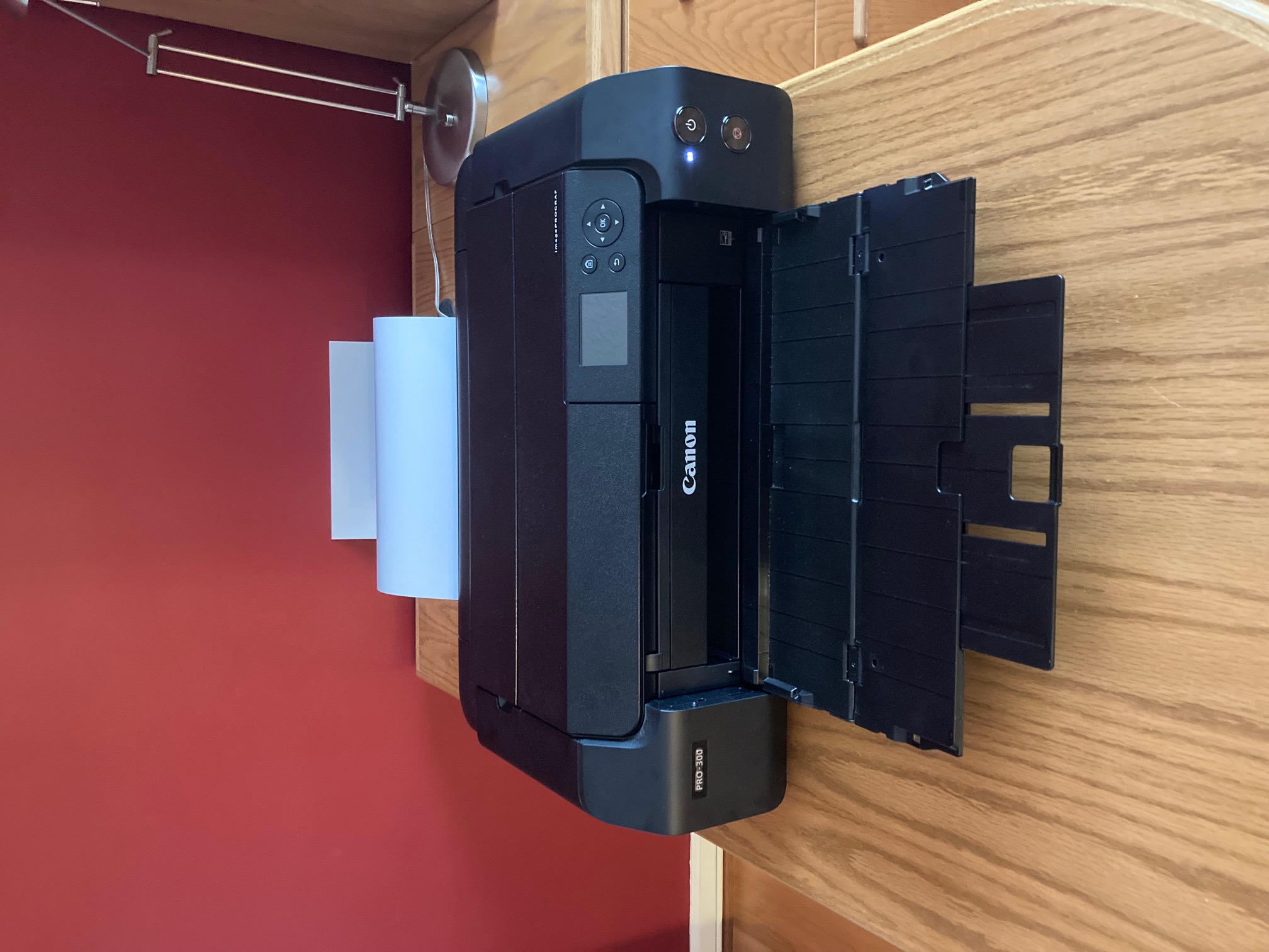

    Problem Solved! We have met the enemy and it is us!
    After spending more than an hour on the phone with Canon Tech support, I was about to put the printer up for sale and go out and buy an Epson model. The Canon rep kept saying "It's the paper, it's the paper". I kept saying "It can't be the paper, the paper is perfect." I thought he was just pushing the problem off on someone else. Well now, it wasn't the paper, nor was it some obscure setting, but rather how I set it up physically to feed into the printer.
    Because the printer is located with its back near the wall, I had grabbed an old piece of foam core to hold the sheet up, thinking I was avoiding the problem of having the paper get hung up or damaged.
    However! When the printer first started to feed, the weight of that paper was causing the printer to erroneously see a paper jam fault. So in a last ditch effort, I pulled the printer out away from the wall, letting the paper lie down on the table. It fed perfectly - problem solved! I guess I owe the Canon Tech Rep an apology...
    JPG, 621.1 KB, uploaded by MikePDX on April 18, 2023.
    JPG, 630.5 KB, uploaded by MikePDX on April 18, 2023.
