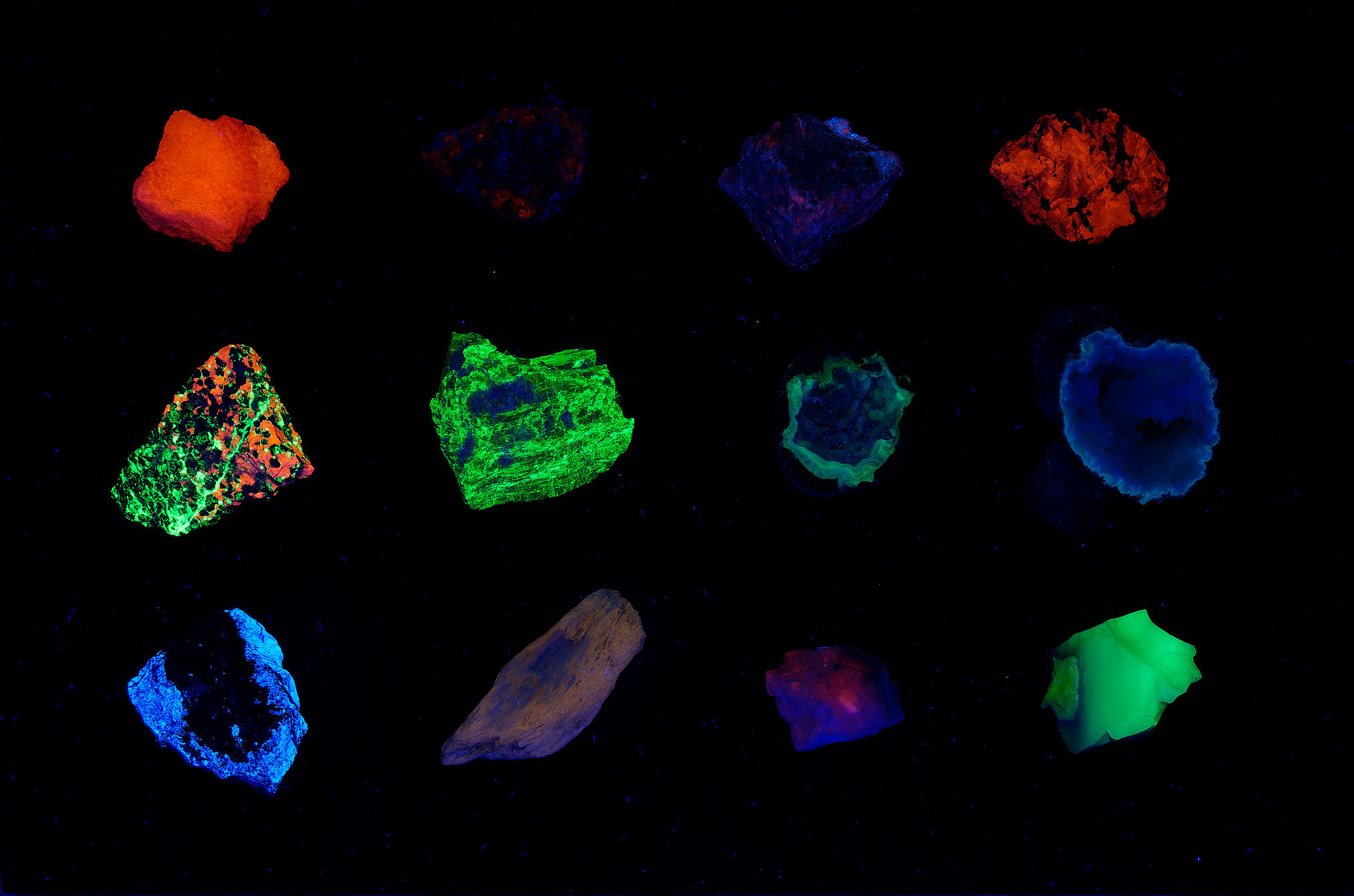

    I've enjoyed viewing objects in UV light for years; sometimes very impressive, and revealing of features not seen under visible light.
    In particular, some minerals are quite dull in visible light, and spectacular under UV, especially shortwave (used with caution for eyes and skin).

    wow these look great! This looks like a lot of fun, will have to dig out the old UV light from the loft

    Thanks, I was inspired by petrochemist's post to resurrect that image. I have a long-tube blacklight in the closet dating back to 1968. :-)
    But note, this shot was done with a shortwave light; standard UV lights work with some minerals, but not as many. Shortwave costs more and needs careful use.
