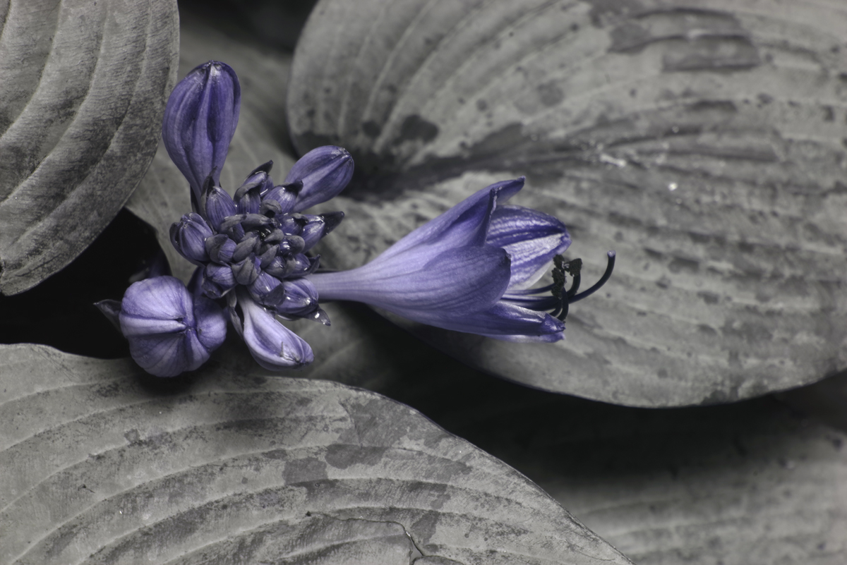

    Taken using only reflected UV light using a Pentax K1 modified for full spectrum by Kolari Vision. A 2mm thick Hoya U360 filter removes daylight. The Schott S8612 filter was added to the stack to remove infrared. Lens is an 80mm Nikon EL-NIKKOR enlarging lens. This is one of the few sharp and affordable lenses that pass UV light. This experiment used a giant Canon front mounted teleconverter lens to add focal length. More glass is often bad for UV light transmission. This worked well and reproduced the false color blooms nicely.
    Taken in shade with a 30" exposure. UV light is only about 3% of sunlight. Luckily there wasn't any wind.
    Thanks for looking and participating
