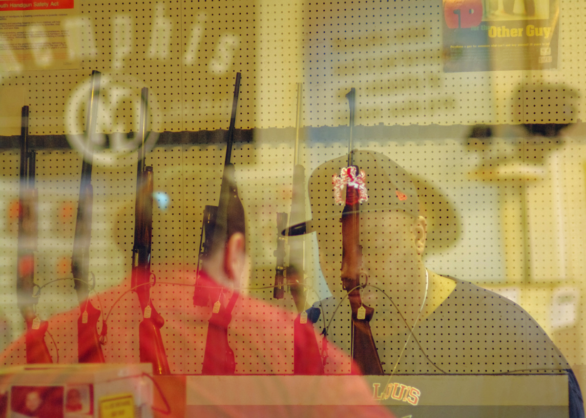

    Strange image taken in a store. Believe this is a reflection instead of a multiple exposure. Honestly don't remember taking this at all.
    Pentax K-7 with Pentax 77 limited. F1.8 1/800 ISO 1250.

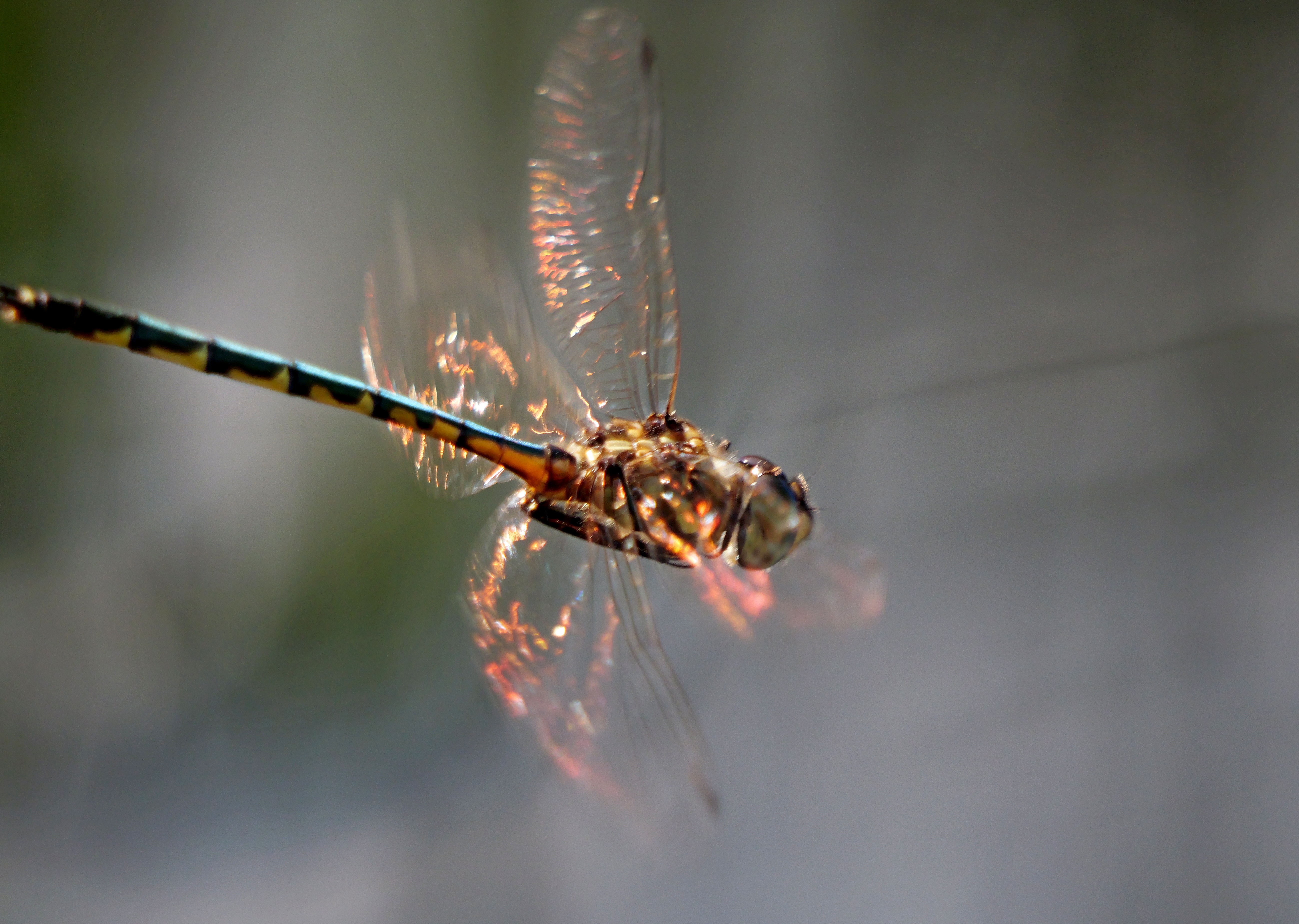

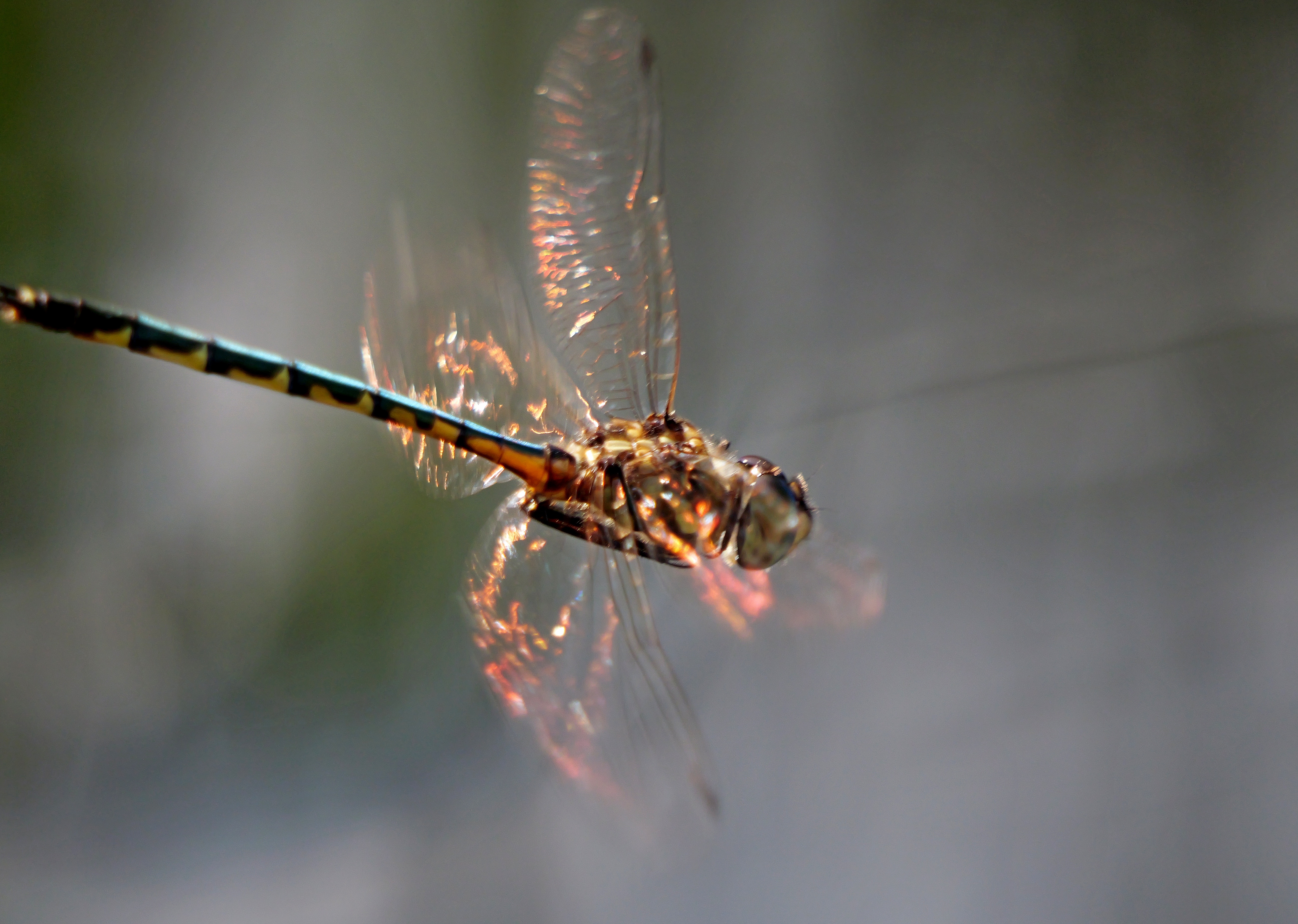

    Raised contrast quite a bit and then also darkened it to accentuate the reds, yellows and oranges
    JPG, 5.5 MB, uploaded by Bryan on April 2, 2026.

    Excellent capture! Your processing brings out the colors well. The wings look like they are charged with electricity.

    I like both the reflection and the glowing dragon. Reflections and shadows are interesting. Problem is it's hard to hunt for them. Taking a walk in hope of finding a good reflection is doomed to fail.

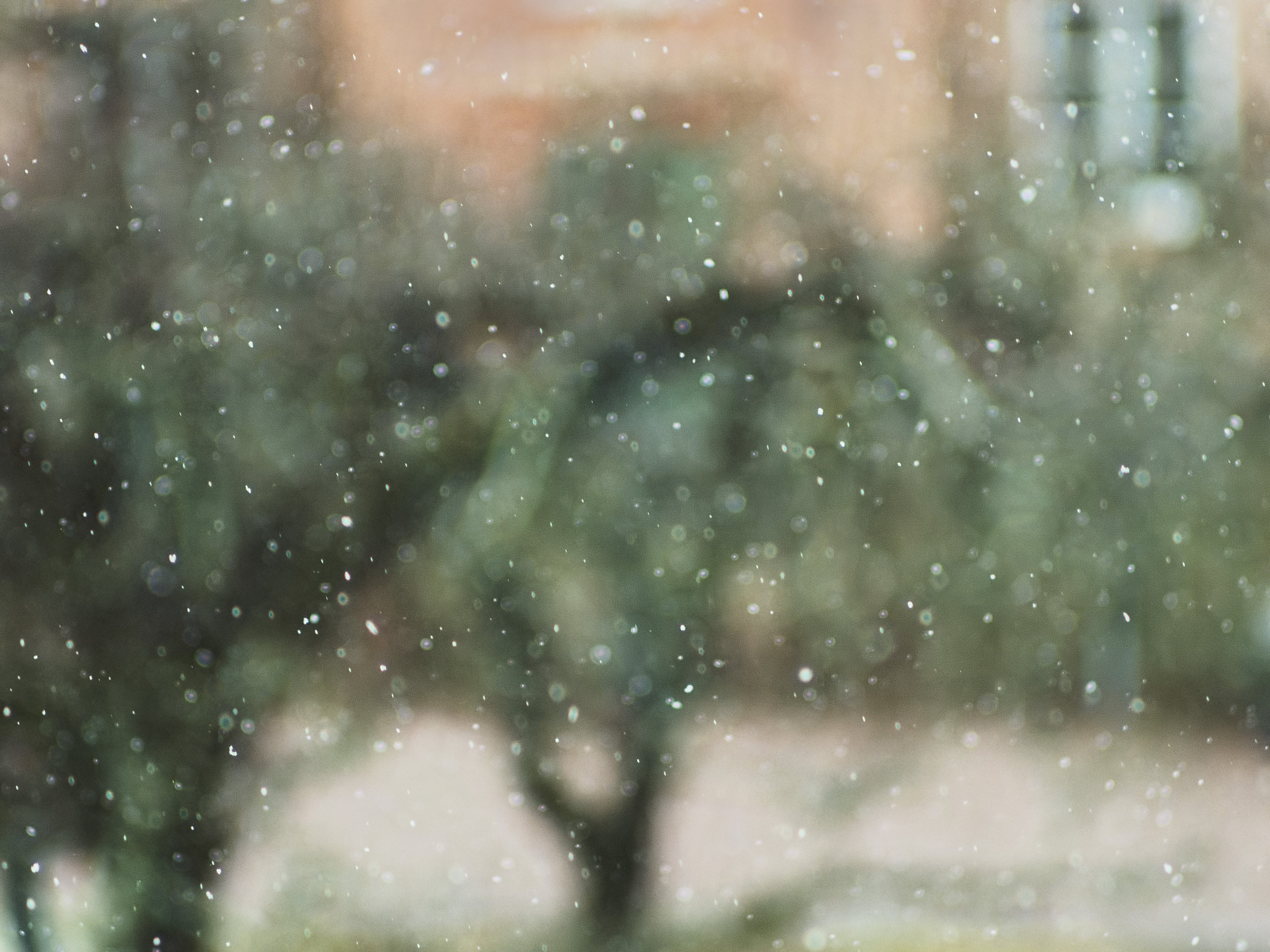

    This isn't that abstract and experimental only in that I try to figure a new lens out, but what I've got today. After a lovely spring week we now have this. Sucks.
    JPG, 7.7 MB, uploaded by meow on April 4, 2026.

    Looks great. Is this your new Meyer Görlitz 135mm f2.8? It has a nice atmospheric presentation. Resembles my 180. Animals and weather have a knack for hampering new photo equipment tests🙂.

    Actually, not so great. I had accidentally turned HHHR on, which explains I couldn't get sharp flakes and kept rising the ISO to be able to use shorter SS. And, it turns out I get a lot of chromatic aberration from the lens, whereas people with FF cameras don't. If you look close you can see almost like a rainbow in each flake.The fringing isn't hard to get rid of in most cases, but in some it is. With these rainbow things I didn't even try. I wanted to try again with lower ISO and see if that made things better, which would be a relief, but it stopped to snow. Maybe we'll get some more tomorrow.
    The lens is on the long side for general use on MFT anyway. But I like it, but the fringing and what this rainbow effect should be called will be a bother.

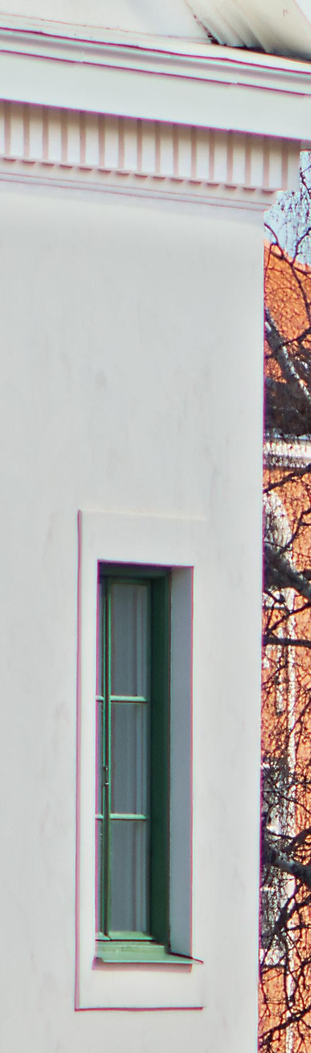

    OK, but I've seen lots of images from this lens. They don't have this kind of aberration in their bubbles. Can show you an example of it's more normal fringing.Fancy red, no less (attached). A guy at DPR was nice enough to shoot streetlights with his Orestor before I bought the lens since I worried about that since an Canon FD lens I have fringed like crazy on my E-M1. Only streetlights, no other light sources. He got no fringing. I've tested the Orestor on streetlights, using OM-1 now. It fringes. So does the Canon FD, but just normal fringing with both lenses, not crazy like with E-M1.

    JPG, 297.5 KB, uploaded by meow on April 4, 2026.
