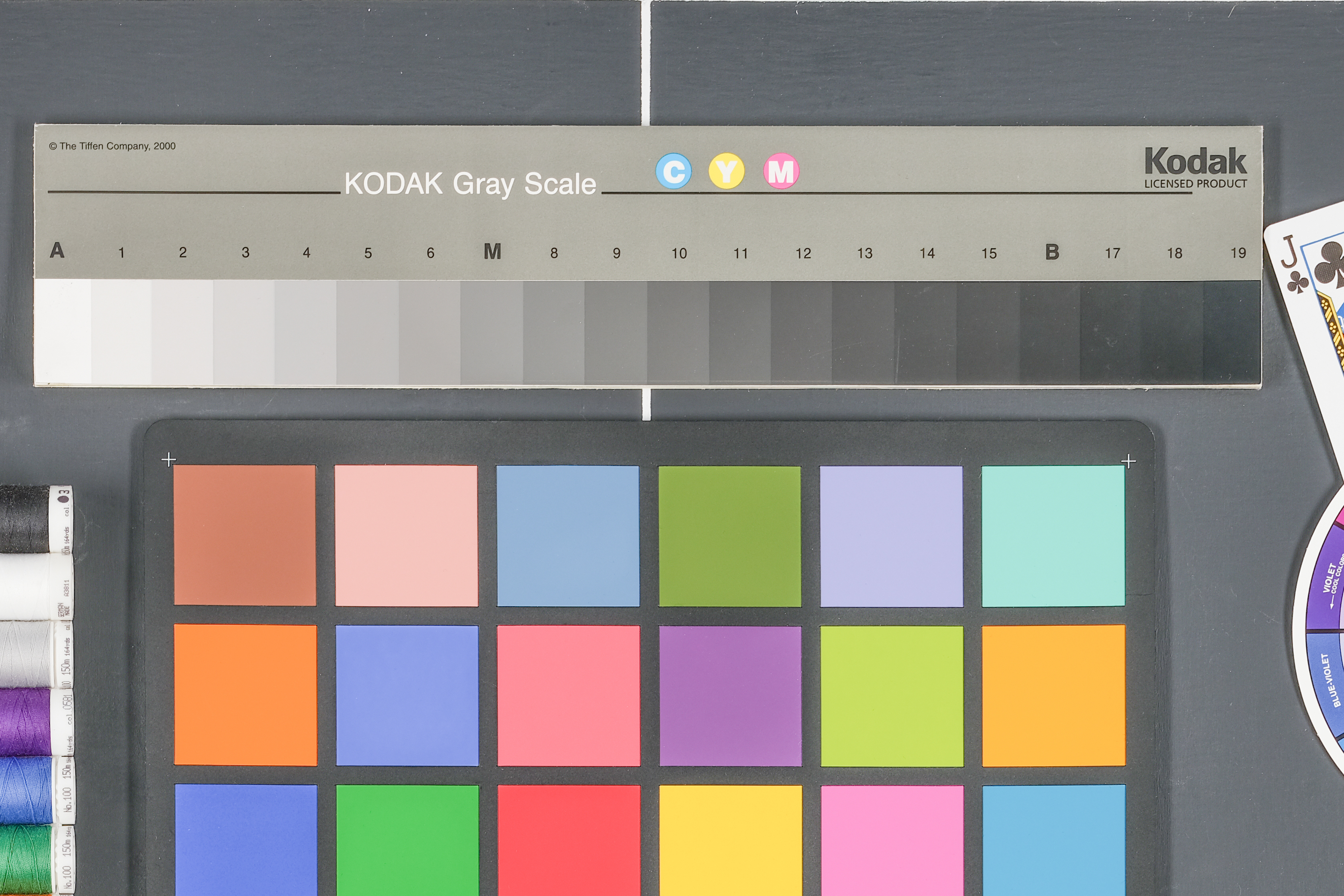

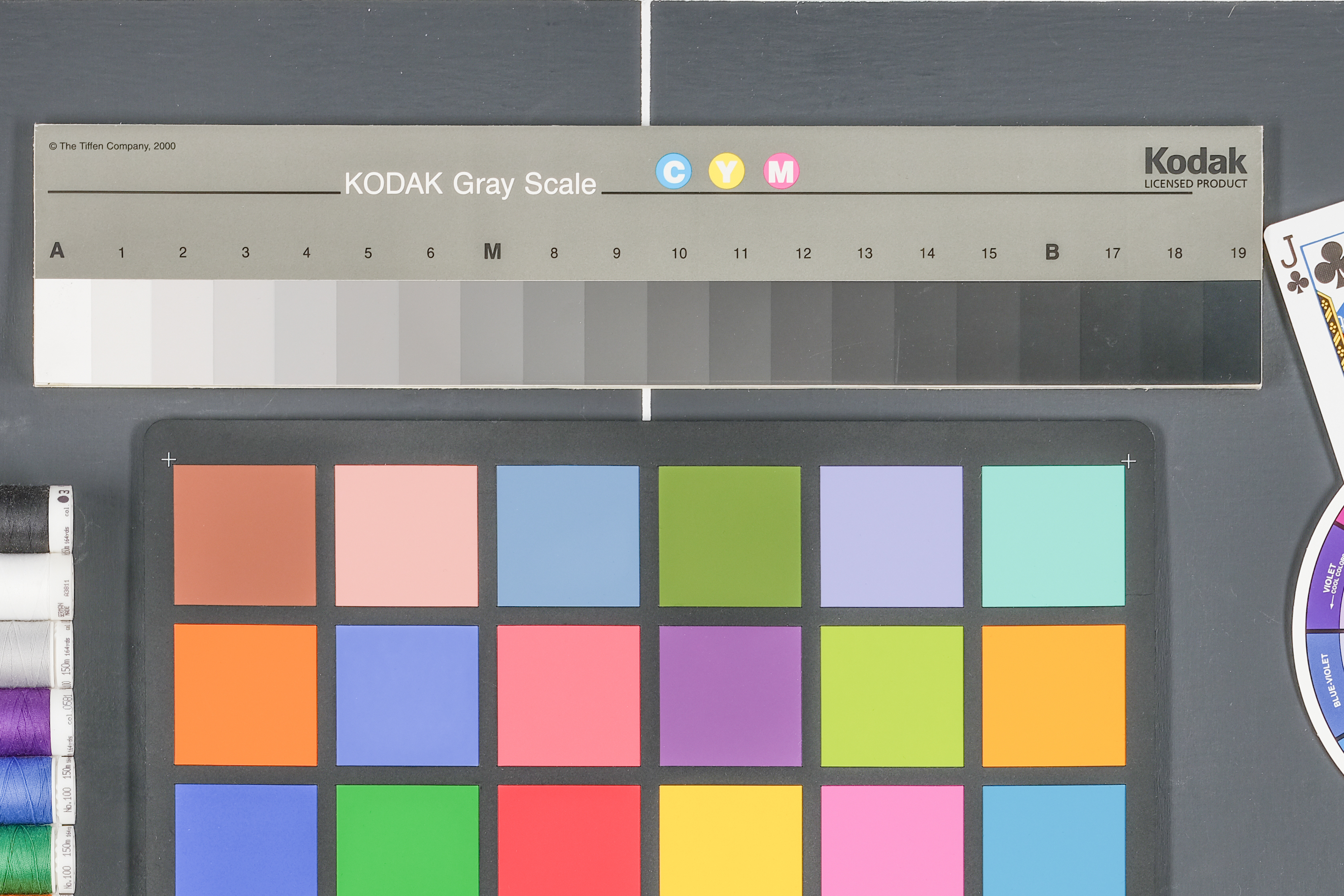

    everything is a compromise, but even images from my old 6 meg k100d looked great, what today brings is better AF well at least on some cameras others are still back in the stone age.
    what was exposed out of this thread is biggers pixels record more acurate voltage steps period. which ive been saying for years.

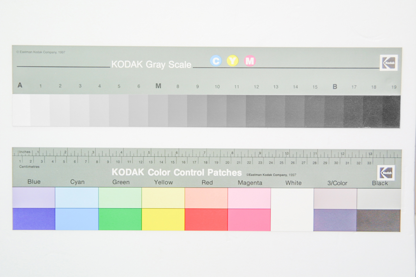

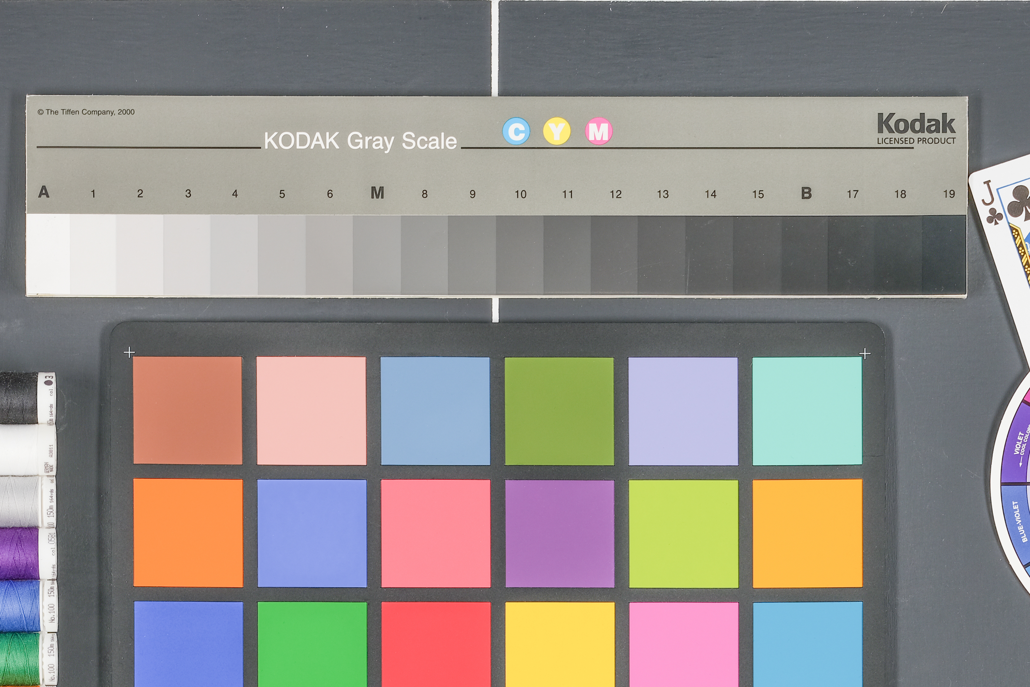

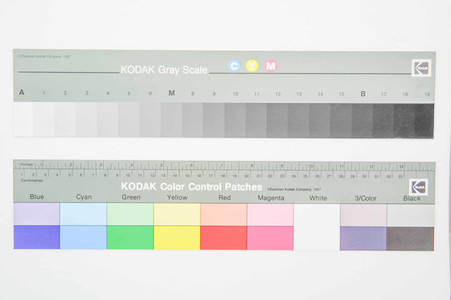

    here are 2 images latest MF and the d30 both images pushed to display seperation of tones.
    what amased me was using the colour picker in Ps some modern cameras couldnt even seperate the tones 🀨in fact the left sample was darker the right πŸ€”
    JPG, 4.7Β MB, uploaded by DonaldB on April 17, 2024.
    JPG, 537.3Β KB, uploaded by DonaldB on April 17, 2024.

    They can, but the chances of any random individual doing tests as equitable and meaningful as is possible is low. The two Kodak test images Don posted say nothing about anything, other than the fact that these cameras had lenses and sensors. No mention of how these images were exposed, how and why they came to exist at the size they are shown, etc. It looks like he normalized the size of the Kodak test strips, cropped from other people's images, as if that was any kind of useful comparison.
    His original assertion that I replied to was that the D30 at 3.1MP had better "gradation" than the 90D/R7/M6-II 32.5MP Canons of the same sensor size, which is true only in photon-limited tonal ranges and ISOs, but the camera is only doing something with its big pixels that can be better done with more flexibility with the newer 32.5MP sensor. He seems to be focused on the fact that the Z-axis depth of variation between one pixel value and its neighbor in the original pixel resolution is lower on the 3.1MP sensor, and that is absolutely true, but also mostly irrelevant, because you can filter the outliers away with the 32.5MP version, and it will still have far more detail, and far less artifacts than the 3.1MP version of the same shot. The 90D sensor has about double the quantum efficiency of the D30 sensor, and it has STOPS less visible read noise in a normalized image size both at higher ISOs and in the shadows of base ISO.
    "Make the reality of discrete Poisson statistics go away from my eyes and I will crown you the better sensor" seems to be his game (although he wouldn't word it like that) and he only accepts it "OOC", but "OOC" through large pixels discards and distorts optical information, and is an inferior starting point for a large range of resampling needs. Those large pixels protect his eyes from outlier photon variations, but they also cause severe color aliasing, and modest luminance aliasing, both of which blow up further with arbitrary resampling.
