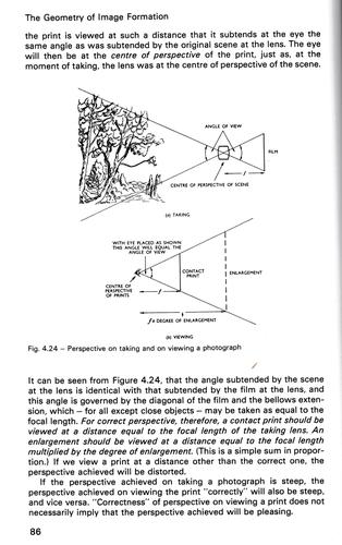

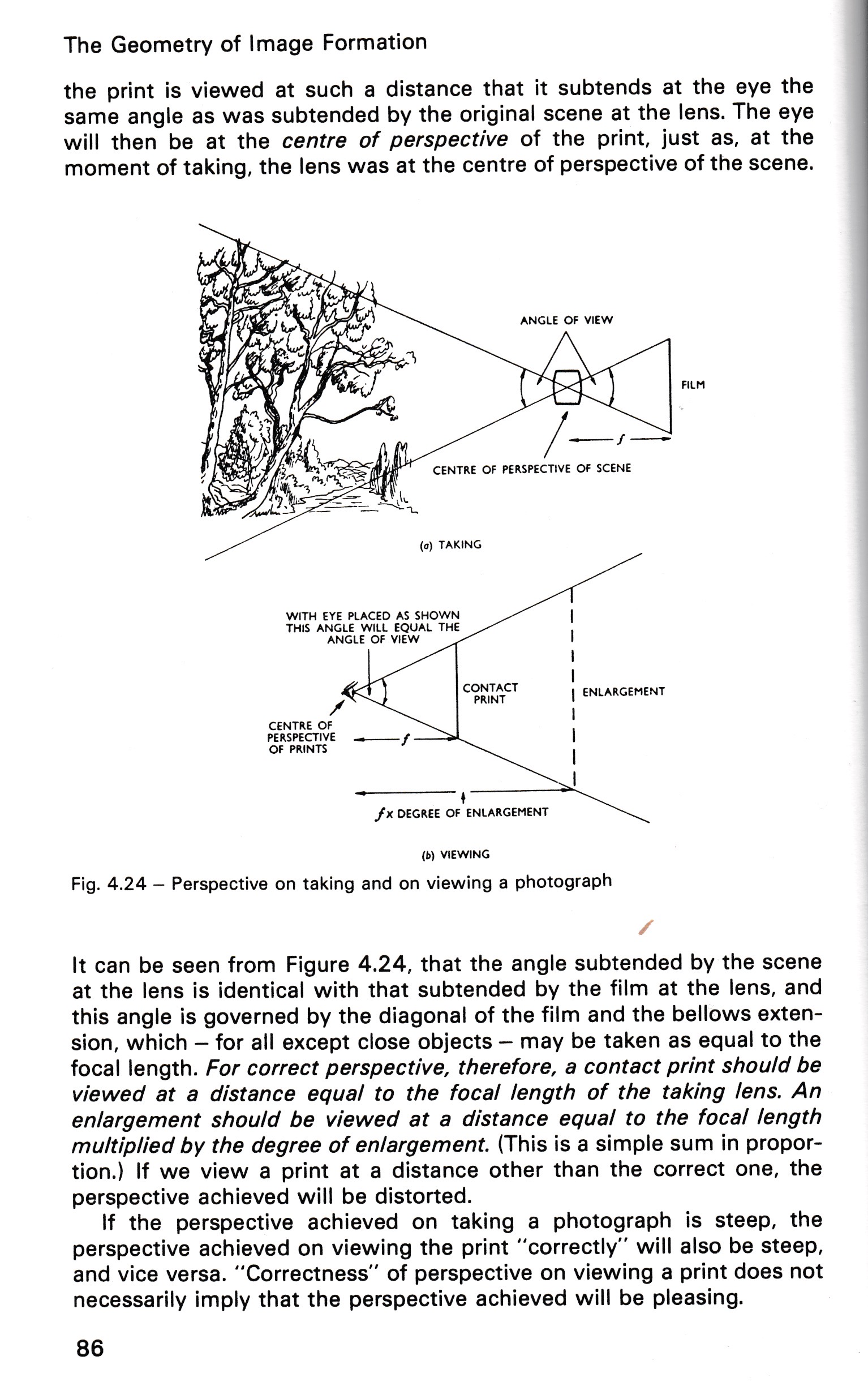

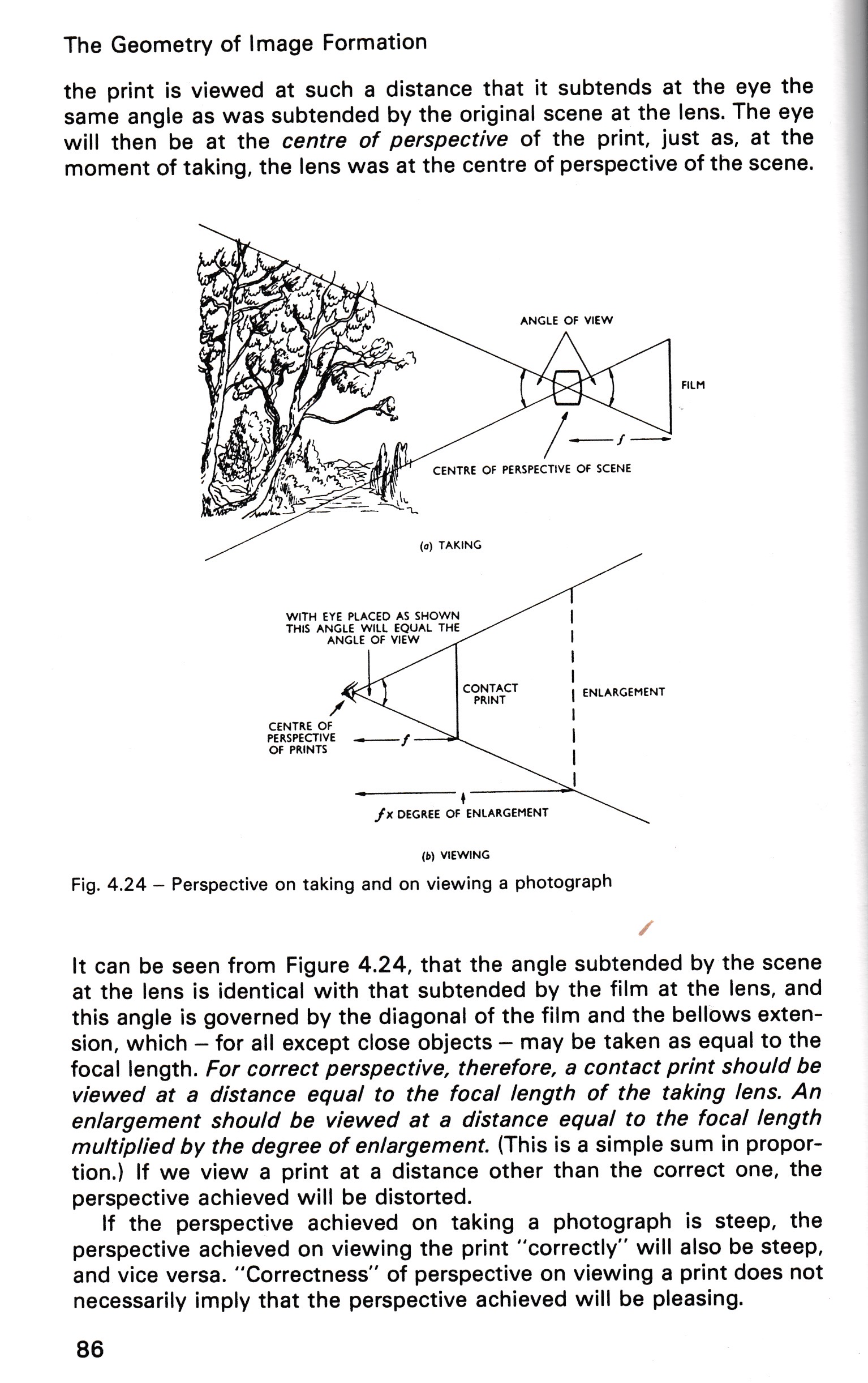

    Whenever I have mentioned the term "correct perspective" it has caused a storm. I want to try to explain where the term came from and hopefully clarify its meaning to those who are not familiar with it.
    Here is an extract from the "Manual of Photography" by RE Jacobson et al. (7th Edition, 1978) which defines the term:
    JPG, 676.9 KB, uploaded by TomAxford on Jan. 25, 2024.
    JPG, 174.6 KB, uploaded by TomAxford on Jan. 25, 2024.
