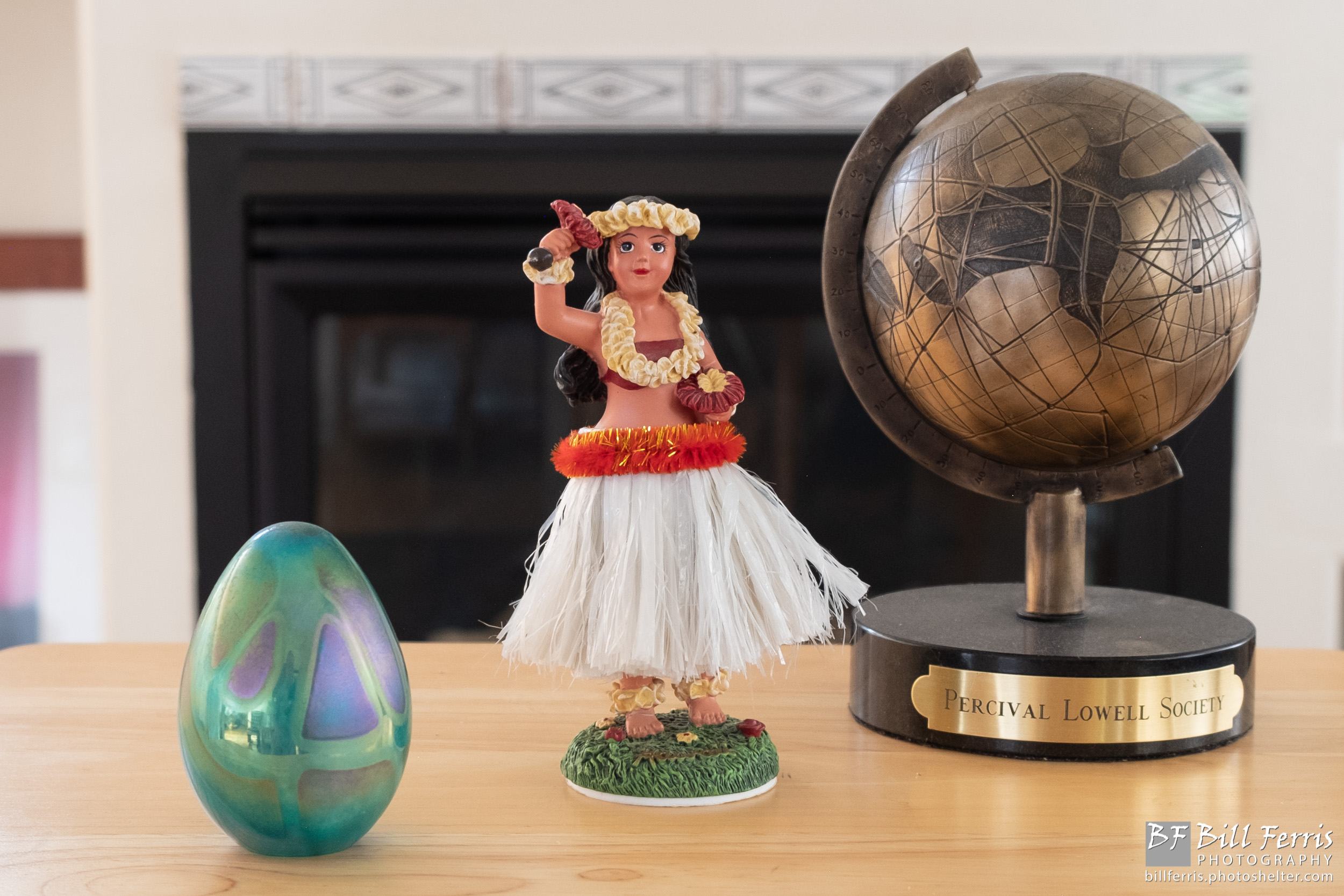

    This photo was made using a Fuji X-T20 with an 18-55mm f/2.8-4 zoom lens at 41mm, f/8, 1/8-second, ISO 1600

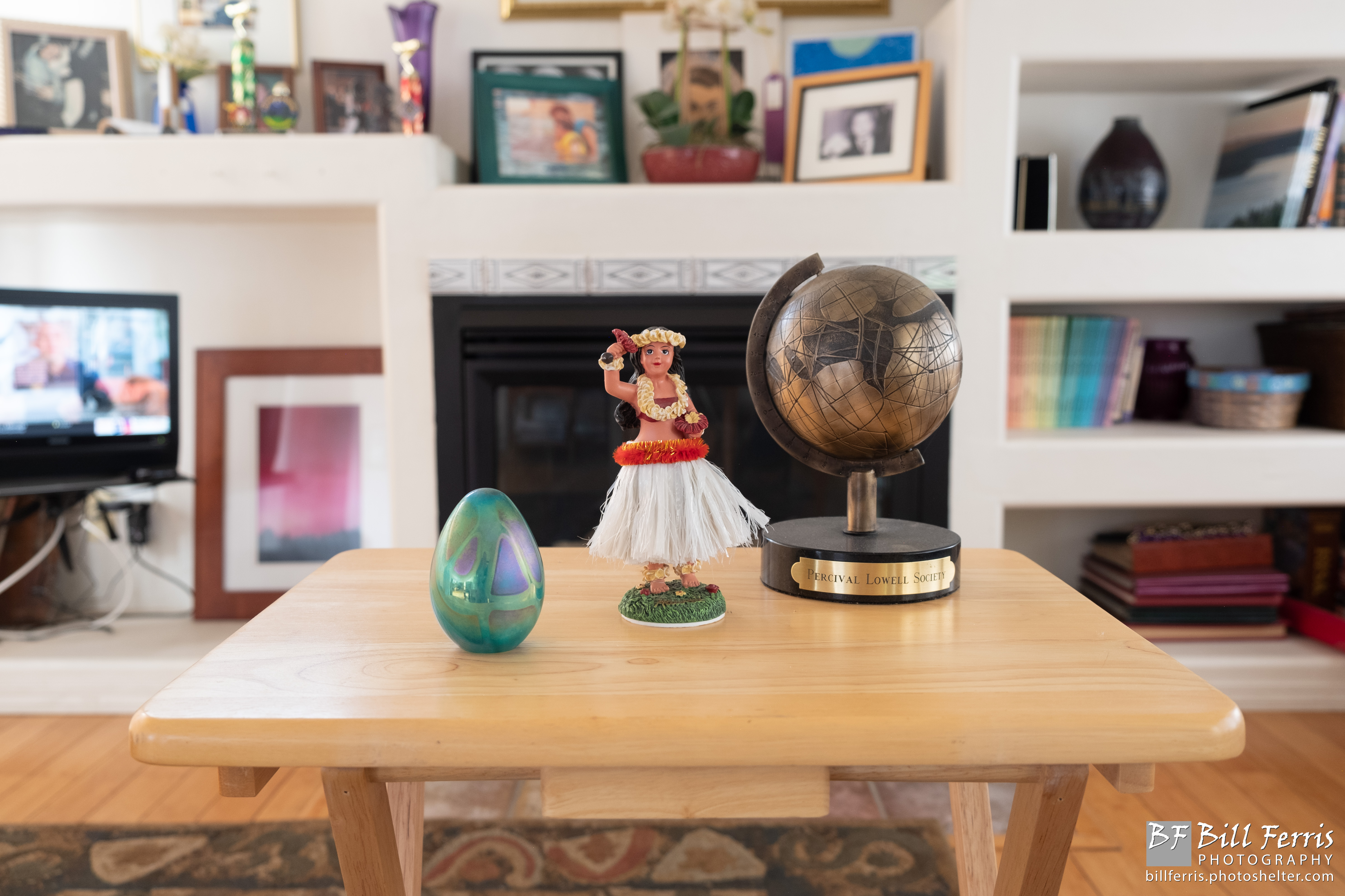

    This photo was made using the same Fuji X-T20 camera and 18-55mm zoom lens at 21mm, f/4, 1/8-second, ISO 400
    I invite you to view them full size and compare them for composition, rendering of movement, depth of field, detail, noise, and lightness. While you're doing that, I'll share some details on how the photos were made and why I chose the various settings used to make them.
    Both photos were made with the camera on a tripod. The tripod and subject were kept in the same positions in my living room for both photos. The photos share the same perspective.
    The second photo was cropped to match both the angle of view and composition of the first. Both photos were made using the same 1/8-second shutter speed. I'll discuss the reason for using that focal length toward the end of this post. Here's what the uncropped photo looks like.
    This is the uncropped version of the second photo.
    Let's compare and discuss the first two photos. They were made from the same perspective, share the same angle of view, and were made using the same shutter speed. The first three properties of equivalent photos have been met. Check, check and check.
    Next, we get to DOF/diffraction/noise. Depth of field is largely determined by the distance of the camera from the subject and the size of the lens's opening; its aperture. Let's do some simple math. The first photo was made at 41mm, f/8. The f-stop is a setting that can be used to determine the lens's aperture. If we divide the focal length by the f-number, we get (41/8=5.1) a 5mm aperture for the lens. The second photo was made at 21mm, f/4. Dividing the focal length by the f-number, we get (21/4=5.3) a 5mm aperture for the lens. With the lens having the same aperture for both photos, depth of field (DOF) will be the same. Diffraction will also be the same.
    As for noise, we've already discussed that the visibility of noise in a photo is determined by how much light is used to make the image. Let's consider that issue in the context of these images. The total light delivered to the sensor is a product of exposure times the surface area of the sensor. Exposure, in this context, has a specific meaning. It refers to the brightness (intensity of light) of the scene per unit area as projected by the lens on the sensor. Exposure is determined by the available light in the scene, f-stop, and shutter speed. The scene had the same available light for both photos. The same shutter speed was used to make both images. The first photo was made at f/8 while the second was made at f/4. The larger f-number tells us a lower exposure was used to make the first photo; two stops lower. Each difference of one stop represents a 2x difference in light. However, the full area of the sensor was used to make that first photo. The uncropped first photo used a sensor 2x the size of the second in width and height. That's 4x the surface area compared with 4x the exposure. They cancel out.
    The net result of all this is that both photos were made with the same total light. Therefore, they have the same noise visibility. With DOF, diffraction, and noise the same in both photos, the fourth shared property has been met. Check.
    As just mentioned, the first photo was made with a lower exposure. That photo was also made at ISO 1600, which allows it to match the second photo in lightness. The second photo was made with a greater exposure but at ISO 400. Since both photos have the same lightness, the fifth property of equivalent photos is met. Check.
    I exported both photos at 2500 pixels in width with their aspect ratios preserved. If you've viewed them at their original sizes, you've seen the images displayed at the same size and distance. The sixth and last of the properties for equivalent photos has been met. Check.
    The first two photos are equivalent. Note, that looking identical is not a requirement for two photos to be equivalent. In this comparison, we can see the lens characteristics at the different focal lengths used are subtly different. The crop of the second photo was done manually and is not a perfect match in composition with the first. The photos have subtle differences in appearance as a result. Still, they share the six required properties and, therefore, are equivalent.
    Since the first photo was made with a sensor effectively twice the size and four times the area of the second, the two photos are representative of equivalent photos made with full-frame and micro four thirds cameras. A micro four thirds sensor is half the size and one-quarter the area of a full-frame sensor. That's exactly what we have here with these two photos. The first photo was made with a sensor area four times the size of that used to make the second.
    Viewing and comparing the two photos, I think it's fair to say that look very much the same. There are subtle differences but they are minor in comparison with the overall appearance and impression of the images.
