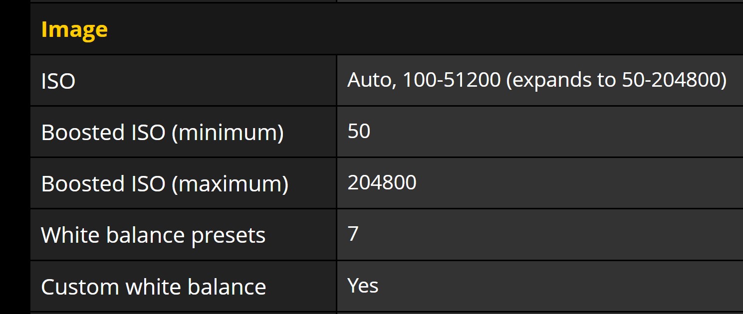

  • Members 2661 posts
    April 12, 2023, 1:46 a.m.
    your understanding is the same as what i have read. but post ADC manipulation is only for expanded iso settings.
  • Members 976 posts
    April 12, 2023, 1:54 a.m.
    No, not only; and there is no such thing as "expanded iso settings" in the relevant standard.

    Define "expanded ISO settings". I've seen cameras like the GFX 50S where the ISO settings where the JPEG brightness and raw file numbers are disconnected at what appear to be normal ISO settings.

    I think another example would be DR400 / DR200 settings on some Fujifilm cameras.
