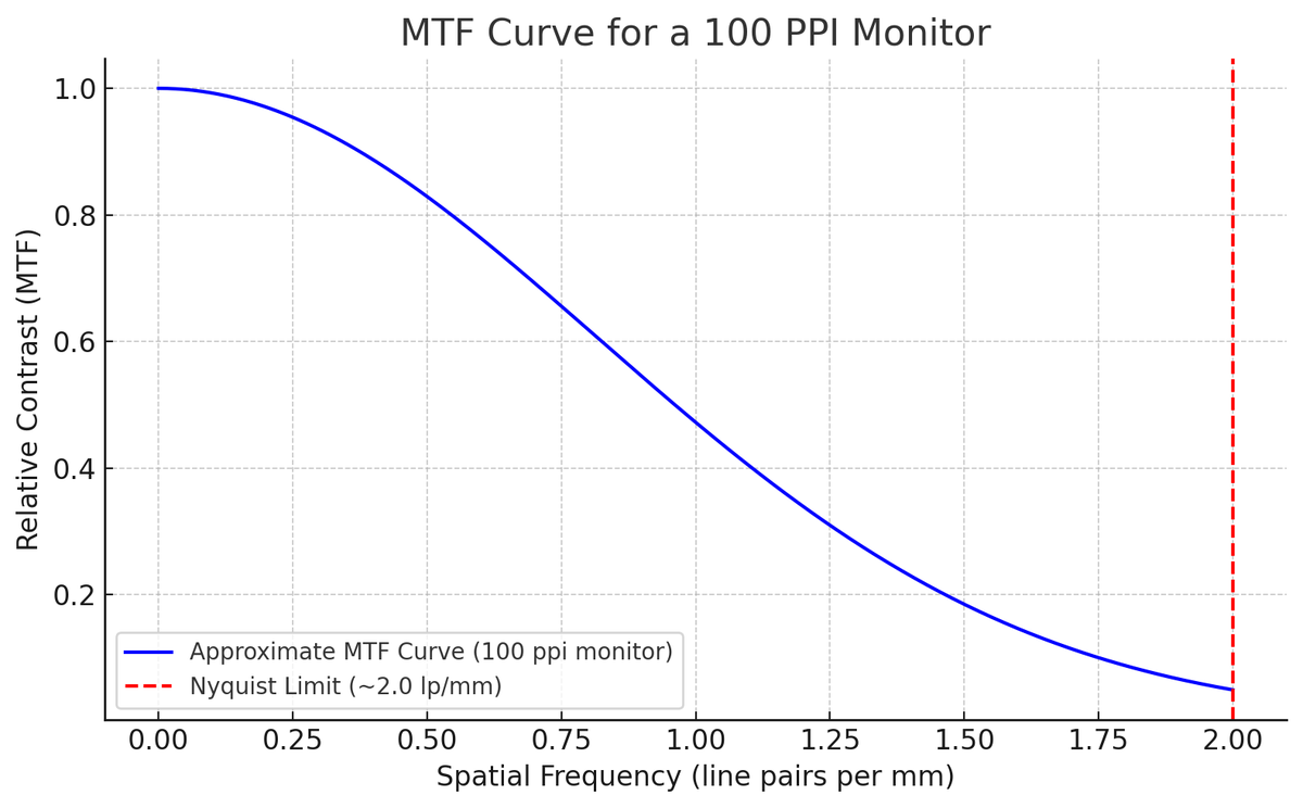

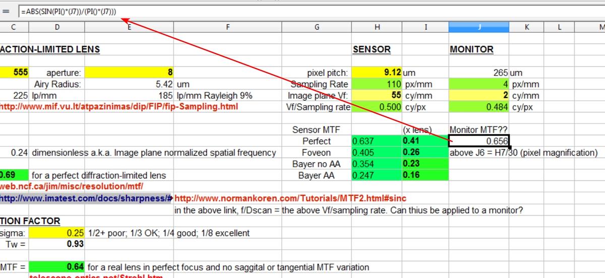

    OK, now I do ...
    Thank you. Representative units resulting from "modified by"?
  • Members 1311 posts
    May 28, 2025, 10:43 p.m.
    Yes, for example per here, an MTF can be determined for a system (camera sensor plus lens plus the viewer) because each part has an MTF at a given frequency which can be multiplied together to get the system MTF for that frequency. The link covers MTF for lenses, scanners, sensors, monitors and prints.

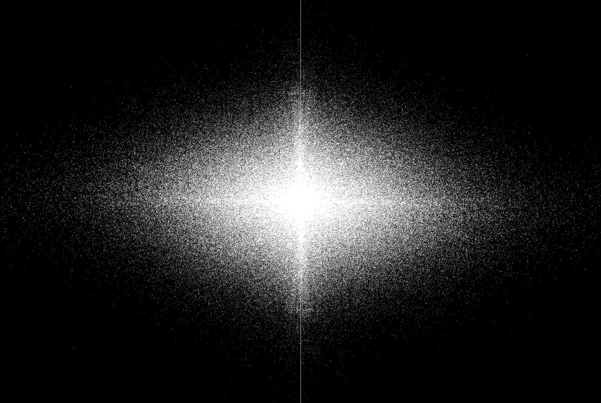

    May 30, 2025, 9:38 p.m.
    Thanks, Arvo. I sometimes compare "texture" by looking at the FFT magnitude plots of images but I have never tried anything else such as complex arithmetic on DFT plots - I have neither the tools** nor the knowledge to do that.
    ** at my age, I find that Python, Matlab, Octave, etc have too steep a learning curve.
