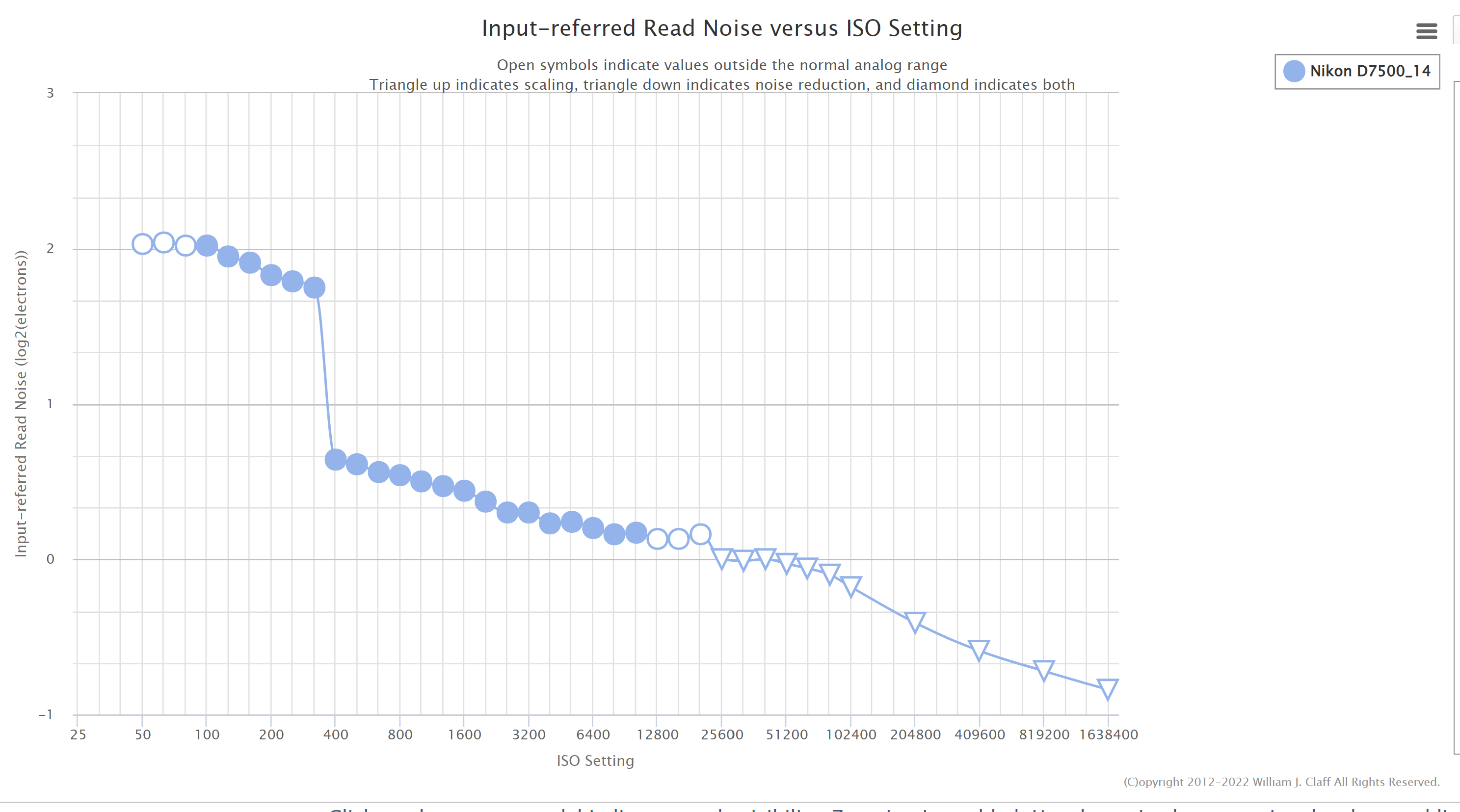

  • Members 1738 posts
    April 28, 2023, 8:18 p.m.
    PNG, 166.6 KB, uploaded by JimKasson on April 28, 2023.
  • Members 591 posts
    April 28, 2023, 8:32 p.m.
    Perhaps, but you asked why people do something, and I gave some reasons why they might do it, within the context of their habits and logic.
  • Members 591 posts
    April 28, 2023, 8:42 p.m.
    Thank you for remembering that qualifying statement, "if exposure is held constant". Some are not qualifying, and that only causes confusion.
    Most beginners are NOT shooting in M mode, and when they hear "turning up the ISO", they are thinking of what happens in those modes where the exposure time and/or the f-number are automated.
