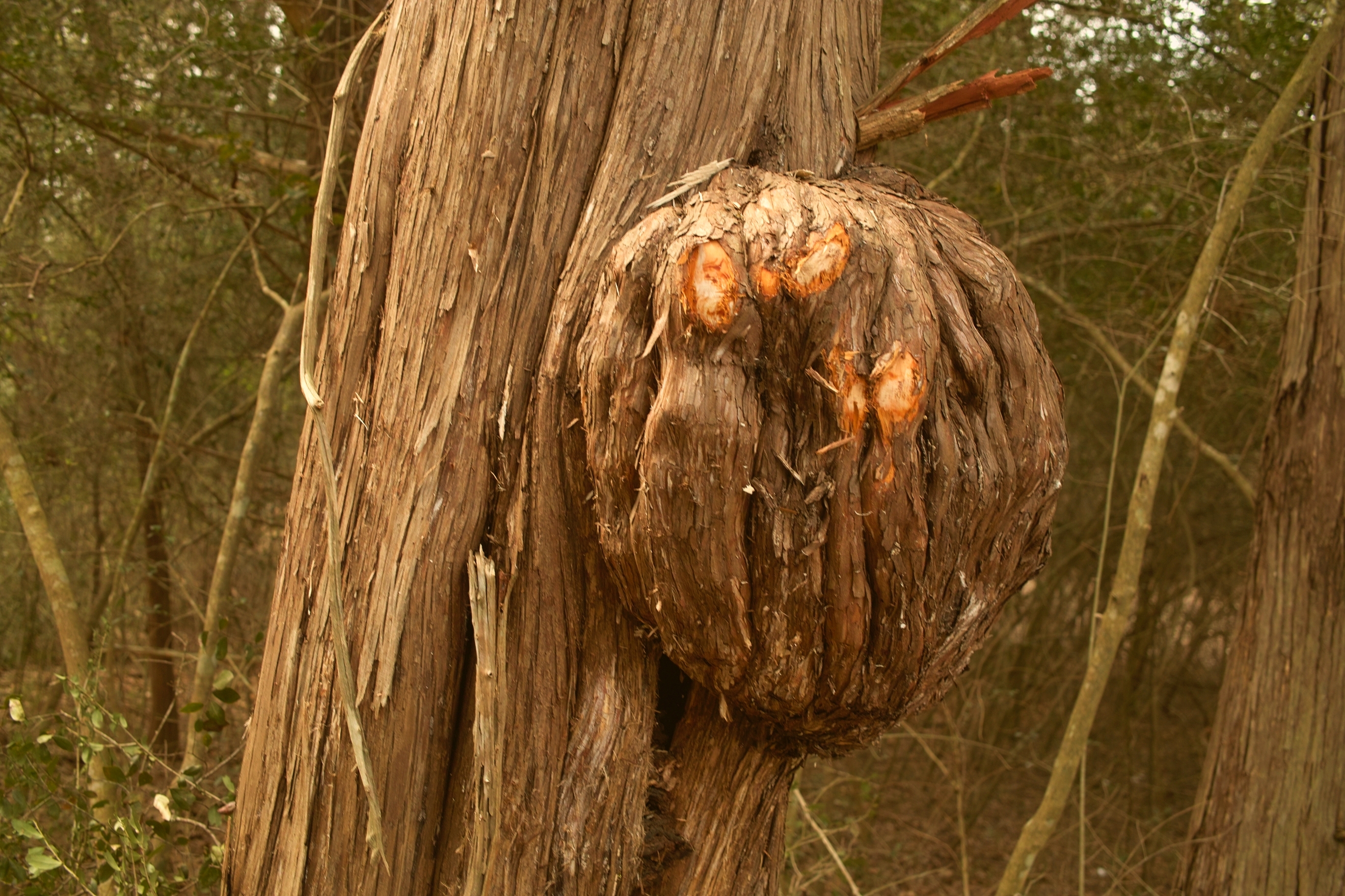

    Have a play with this:

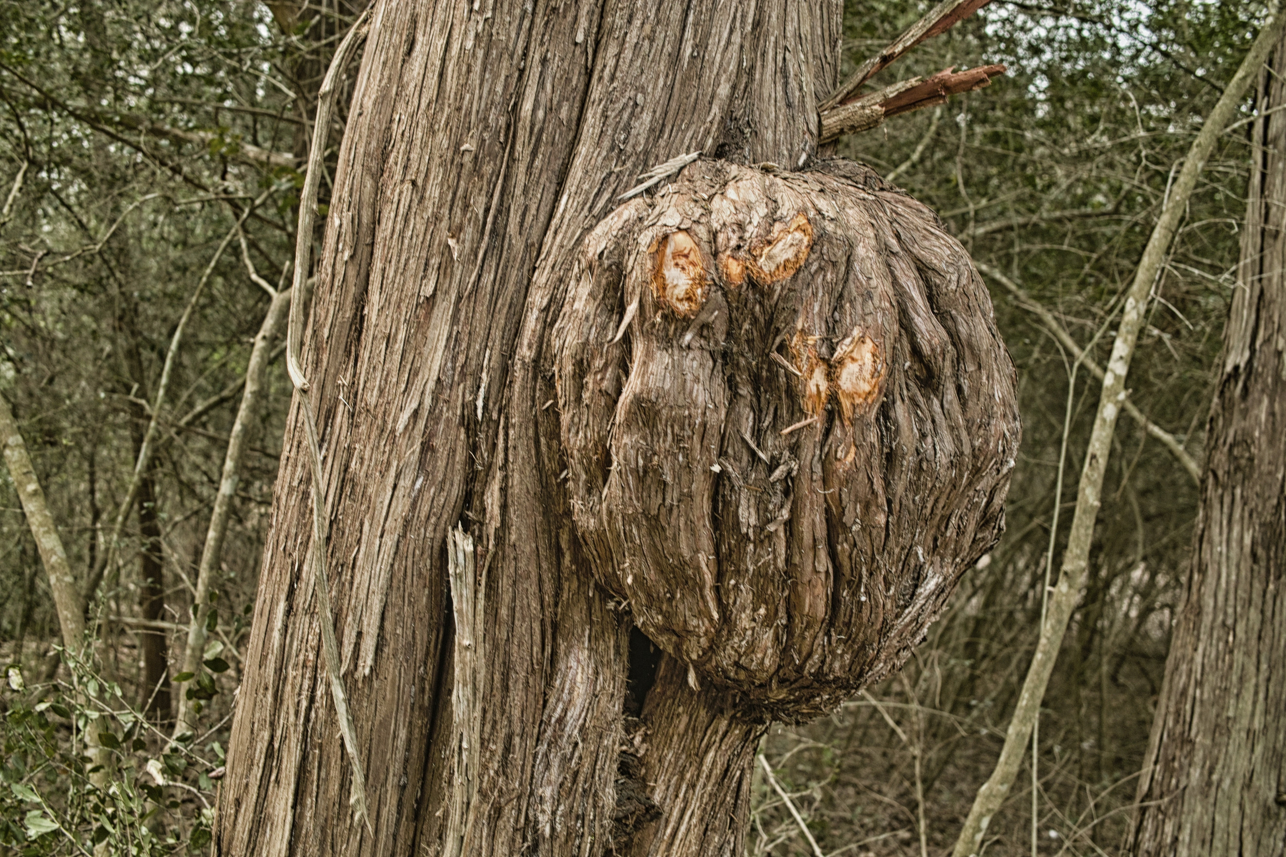

    I rather like histogram equalization:

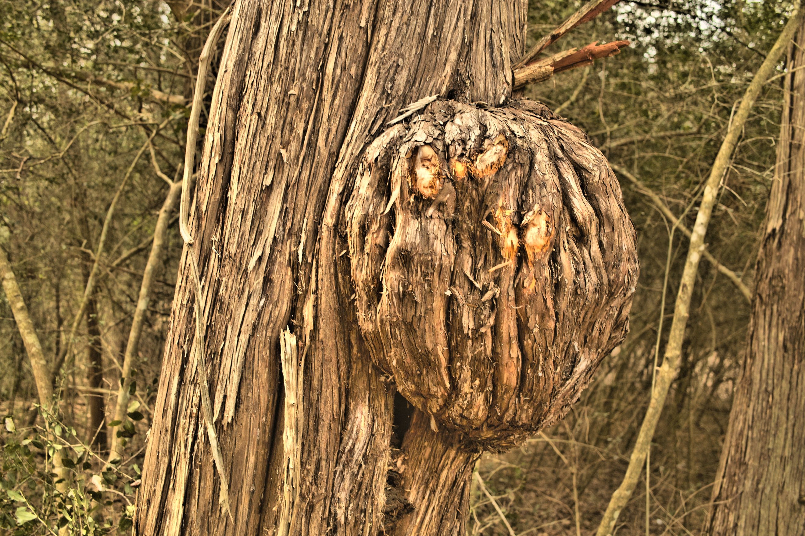

    Going to extremes - Contrast Limited Adaptive (CLAHE) -default settings,
    Simple Adaptive AHE
    What's your own favorite? Please demo by playing with my first above ...

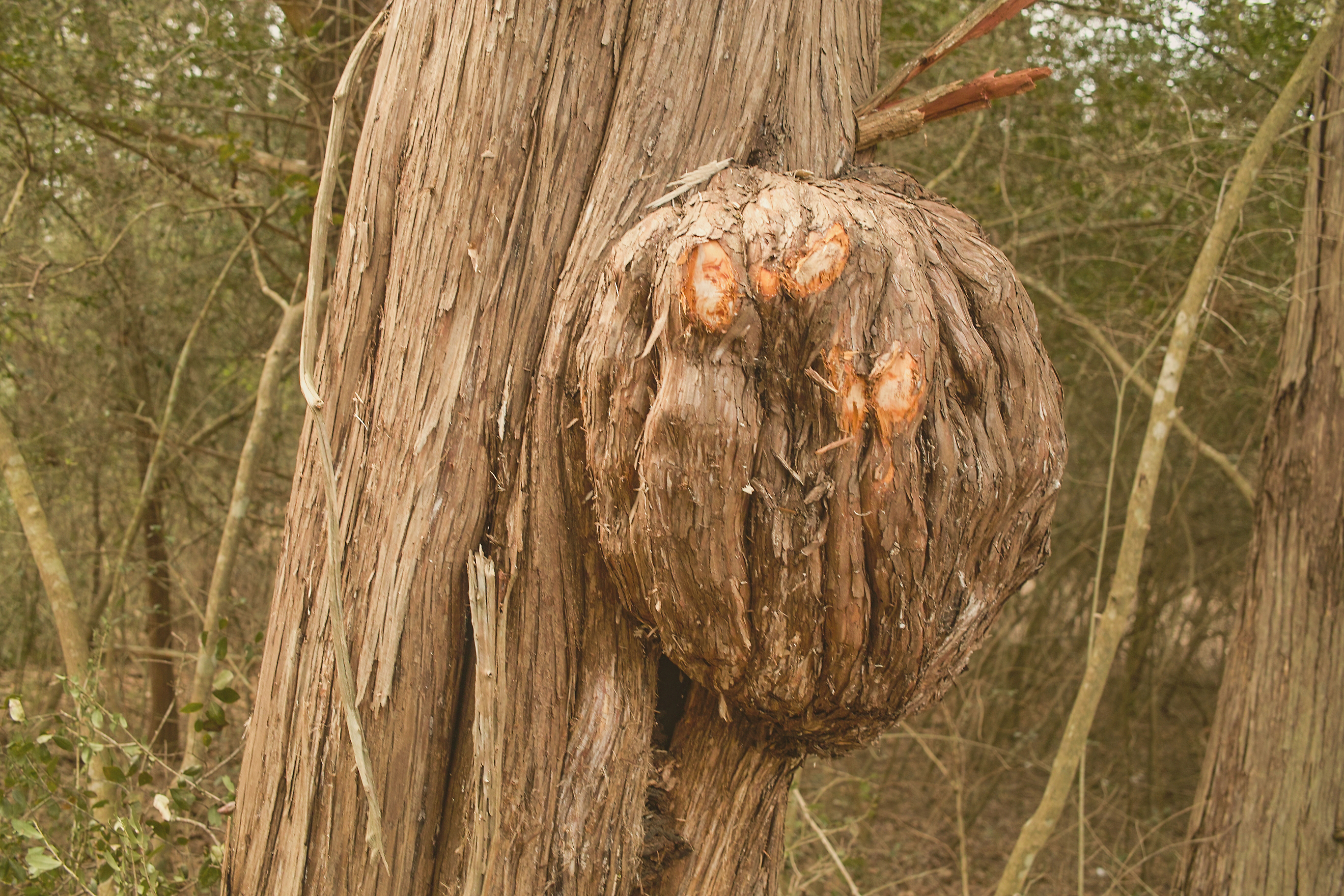

    With further reference to histogram methods:
    Some of us improve low contrast images in Levels by moving the left slider rightwards until the shadows are made darker and by moving the right slider leftwards until the highlights are brightened, then mess with the middle slider to affect the midpoint.
    Download this and compare the histogram with that of the 'play' image. It remains the same shape but is stretched between black and white.
    Another method is simple histogram equalization: en.wikipedia.org/wiki/Histogram_equalization
    Then we get "adaptive equalization": en.wikipedia.org/wiki/Adaptive_histogram_equalization
    And "Contrast-Limited" - the most complex: (scroll down in the above link) .,.
    HTH.

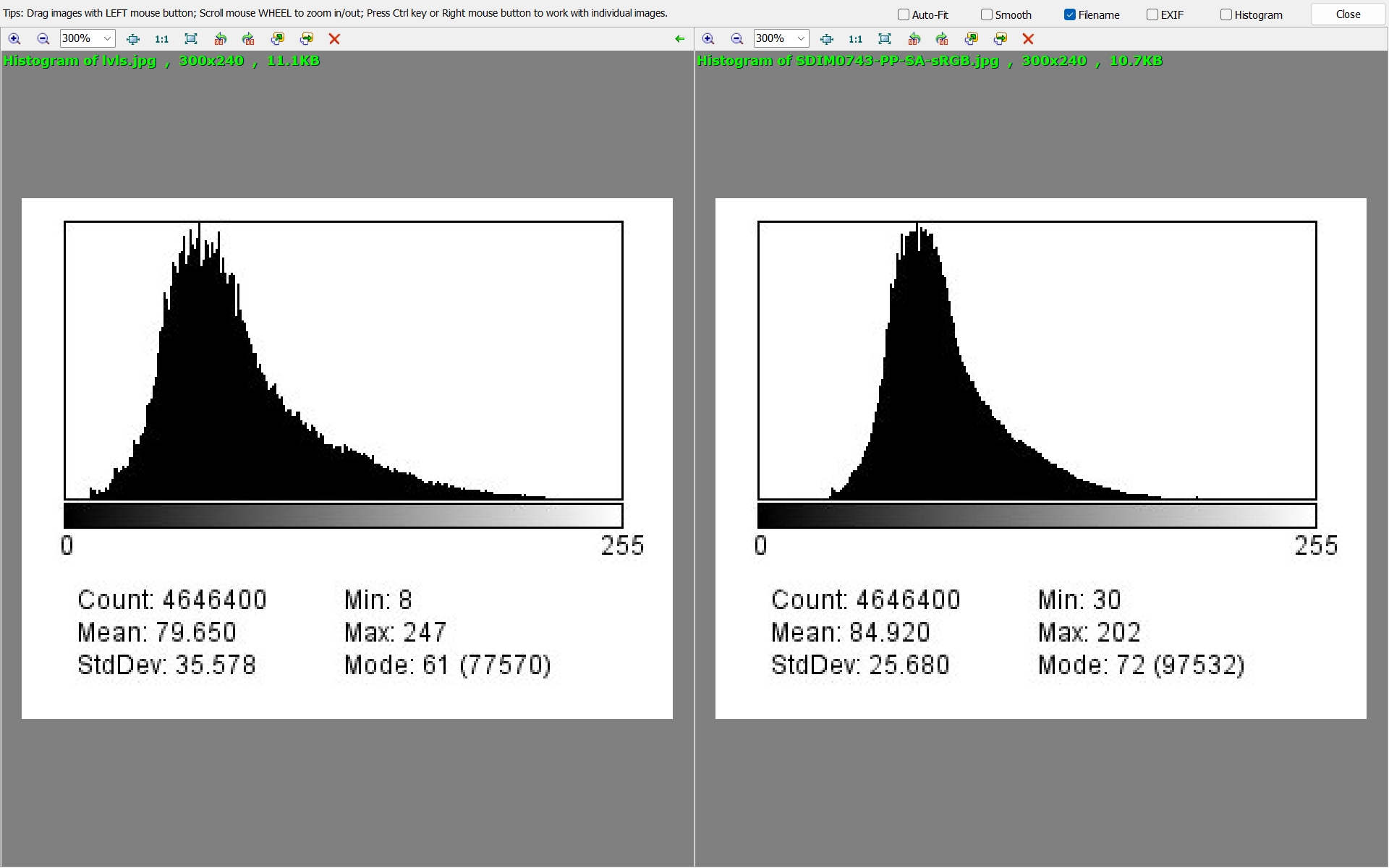

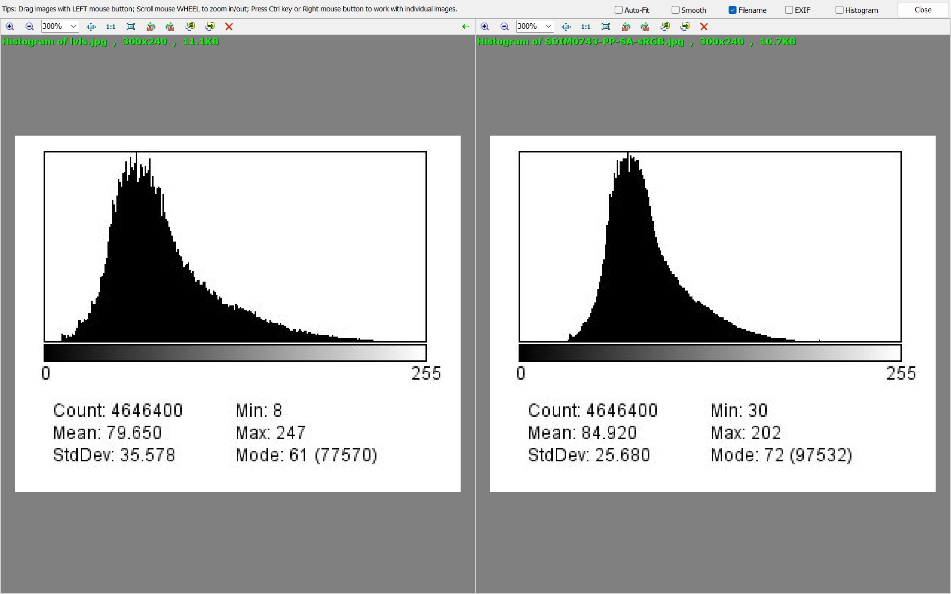

    Here's a comparison of histograms ... Levels at left Play Image at right:
    Could have gone further at both ends ... in the past I have deliberately clipped at both ends by moving the Levels pointers into actual histogram content!

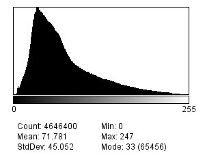

    Your question is hard to answer - I really don't know, what exact methods my tool of choice (DXO Photolab) uses.
    I can change contrast by multiple methods (capitalization follows DxO options):
    • Contrast slider
    • Microcontrast slider
    • EV + gamma corrections
    • DxO Smart Lighting
    • DxO Clearview Plus (this is HDR-like processing)
    • Tone Curve (multiple presets, both RGB and Luma + manual curve adjustment + gamma adjustment)
    • Selective Tone controls (Highlights / Midtones / Shadows / Blacks)
    • Color Rendering (film simulation presets)
    For your image they all give different results - and of course they can be combined :)
    Attached image is processed as next (unchanged options skipped; WB and color adjustments not specified here):
    • 5 - Microcontrast slider (0 - 100)
    • +0.1 - EV correction
    • 15 - DxO Smart Lighting (0 - 100)
    • 20 - DxO Clearview Plus (0 - 100)
    • Medium Contrast (Luma) - Tone Curve
    • Shadows -5 - Selective Tone controls (-100 - 100)
    • DxO Portrait 2 - Color Rendering
    Well, all this likely resulted in too contrasty (or dark) image. You can calculate histogram yourself, easier to compare :)

    Histogram looks good, perhaps a little on the dark side (mode is the level of the tallest bin):

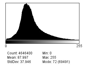

    From responses so far, it seems that my question is over-simple, posted as if contrast is adjusted all-by-itself rather than in combination with other functions. Indeed, many other functions affect contrast per se, necessitating combinations of adjustment to achieve a desired degree of histogram or even perceptual contrast.
    Still, please feel free to play with the OP image and say how you did it ...
    This was done with 41px UnSharpMask plus Levels in FastStone viewer:
    In Levels, I clipped deliberately into the darks and lights, hence min 0 and max 255.

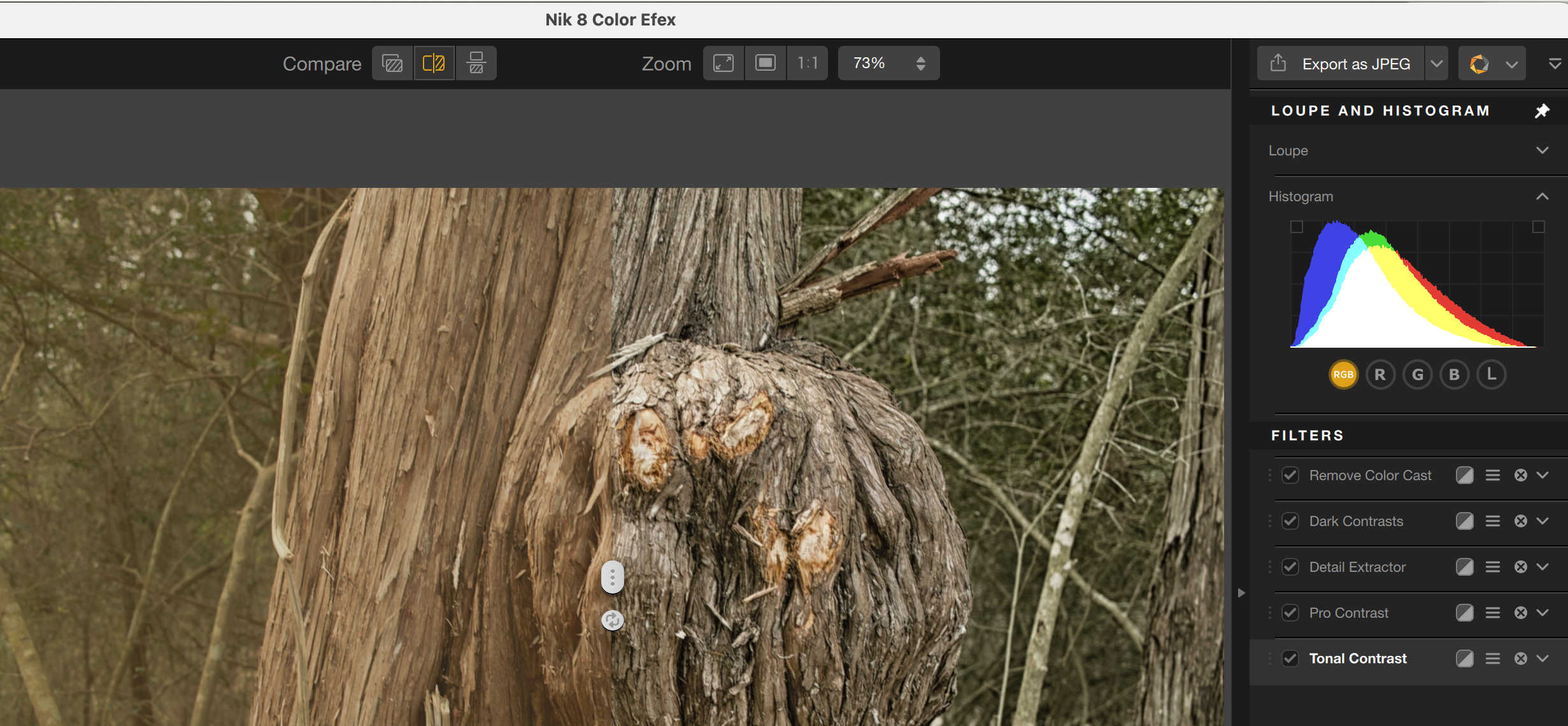

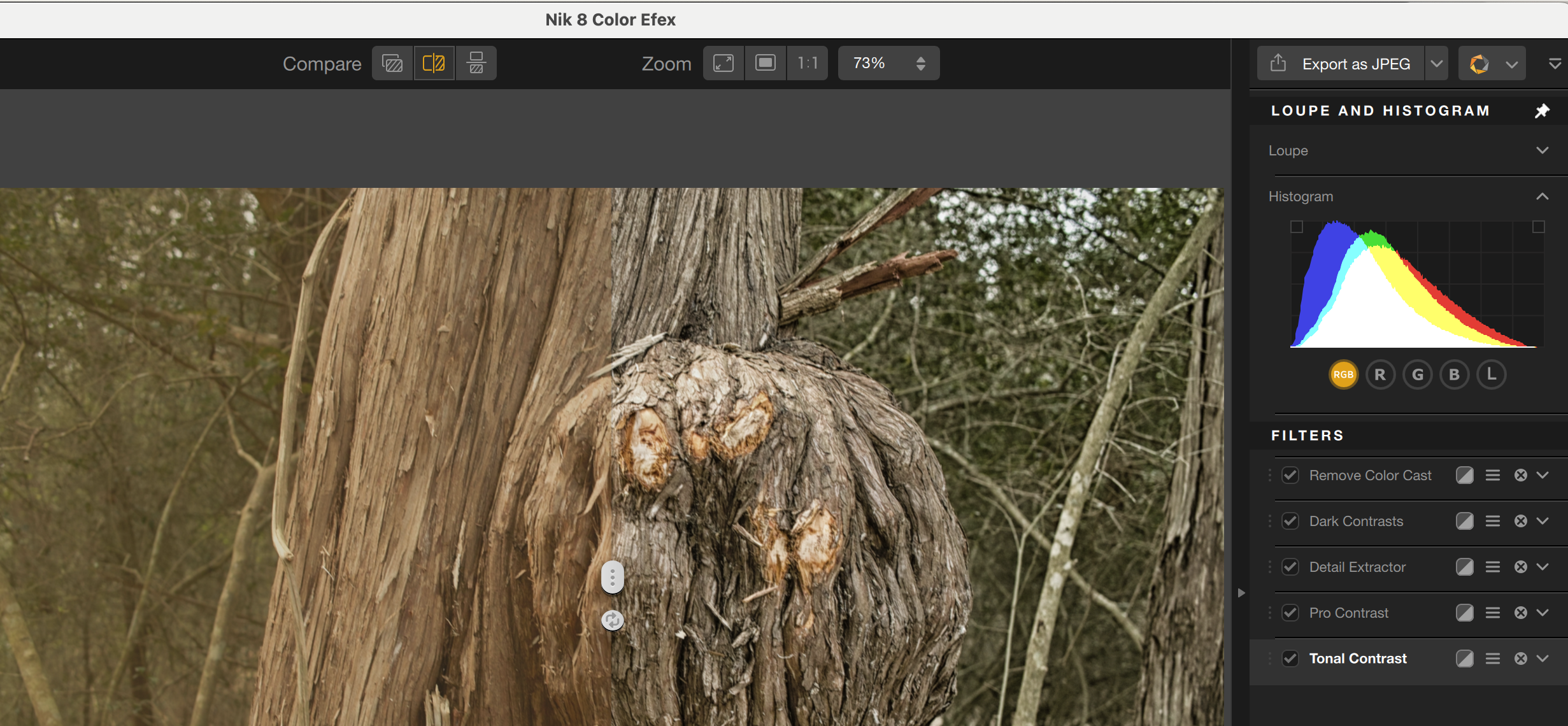

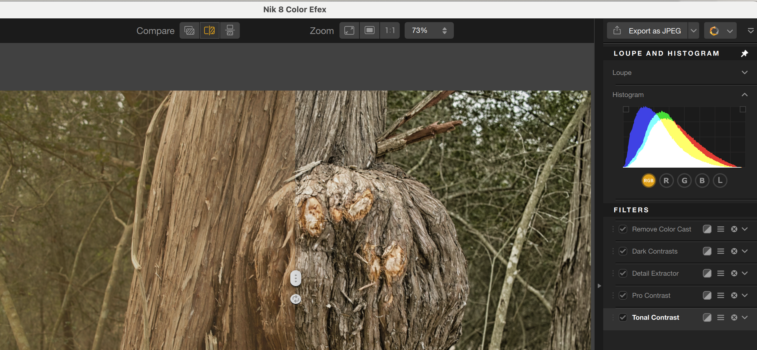

    I shoot almost every weekend in small local venue rock performances. As you can imagine the stage is not well lit and quite often filled with smoke, reducing contrast. In my attempts to show bit more than just colourful smoke I have discovered that in addition to DXO Photolab further improvements can be made with Nik plugins, in particular Nik Color Efex, which has multiple contrast filters, in particular Dark contrast with its ability to enhance contrast/details in dark areas.
    So I put this image through number of contrast filters in Nik Color Efex, removed also colour cast, which seems to increase perceived contrast also, here is result and additional screenshot shows before/after with list of filters and histogram:
