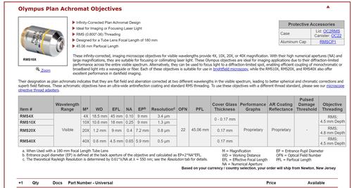

    It’s 1.3 um on the object side. So 13 um on the image side, whatever the metric is
    The lens I have is 1500 lp/mm on the object side, for a line width of around 400 nm.

    At the recommended 436 nm spectral line and magnification ratio, the lens is supposed to be diffraction limited. But note I’m talking about using the lens reversed, so the sensor side sees only 150 lp/mm.
    The lens was designed for stepping semiconductor lithography.

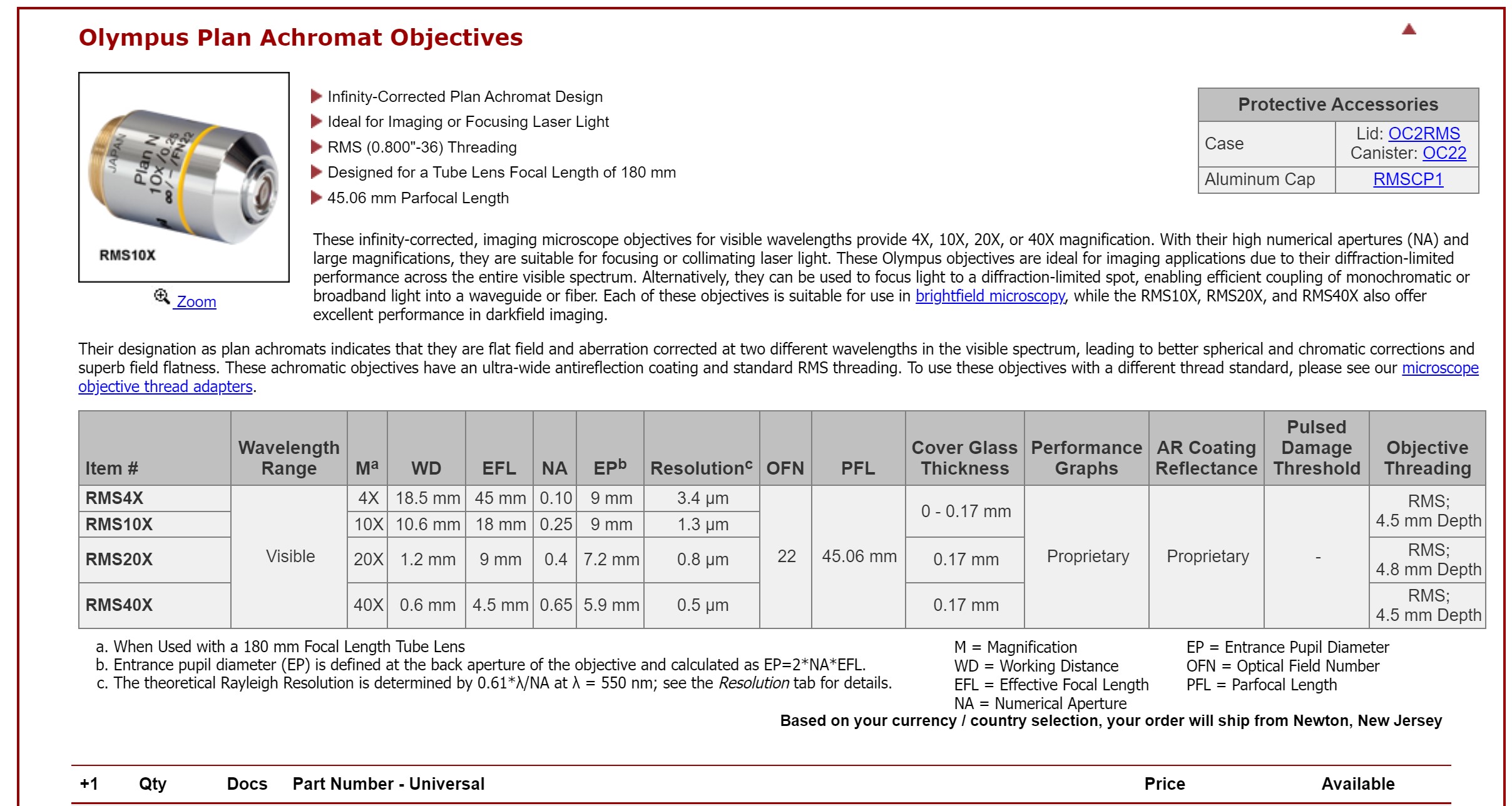

    That, given you have 10x/0.25 objective, for green 550 μm wavelength you need at least a 5.5 μm pixel, and depending on other factors, smaller pixels may be better. Look up the Rayleigh criterion.
  • Members 1738 posts
    July 29, 2023, 6:25 a.m.
    The lens was designed for 1:10. In that usage the wafer side image circle diameter was 14mm and the mask side image circle was 140mm. So as a 10x lens on a 33x44 mm sensor, the object side field of view will be 3.3x4.4mm.
