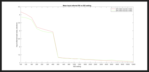

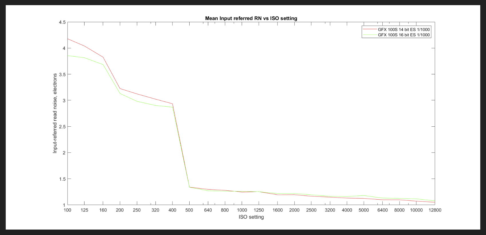

    I do not believe those sensors are fully invariant, and so raising ISO speed still gives you more image quality compared to raising image brightness in post.
  • Members 1738 posts
    April 18, 2023, 5:01 p.m.
    You will have slightly better shadow noise at the ISO point where the conversion gain increases than just below that point. There is little improvement in input referred read noise above that point.
    Most raw converters and most color profiles have difficulty with more than a five-stop push, and the finder will be pretty dark by then, too.
    April 18, 2023, 5:04 p.m.
    Right, through some of the ISO range.
    The GFX 100S shares its pixel architecture with the Sony a7RIV and a7RV.
    PNG, 86.9ย KB, uploaded by JimKasson on April 18, 2023.

    (Counting on my fingers) 5 stop push is equivalent to ISO 3200? Very unusual for me to shoot that high. So Ok to using this strategy to, say, ISO 1600, then boost ISO for those emergency situations? I'm not bothered by optimising perfectly, if it's a stop more noise than when optimised, I'm fine with that, primarily interested in keeping it so simple I can remember it in the field.
    My current strategy is auto-iso.
    My previous strategy was base ISO only, resulting in lots of shots ruined by camera shake. Then one day I awoke and realised that noise is better than blur.
