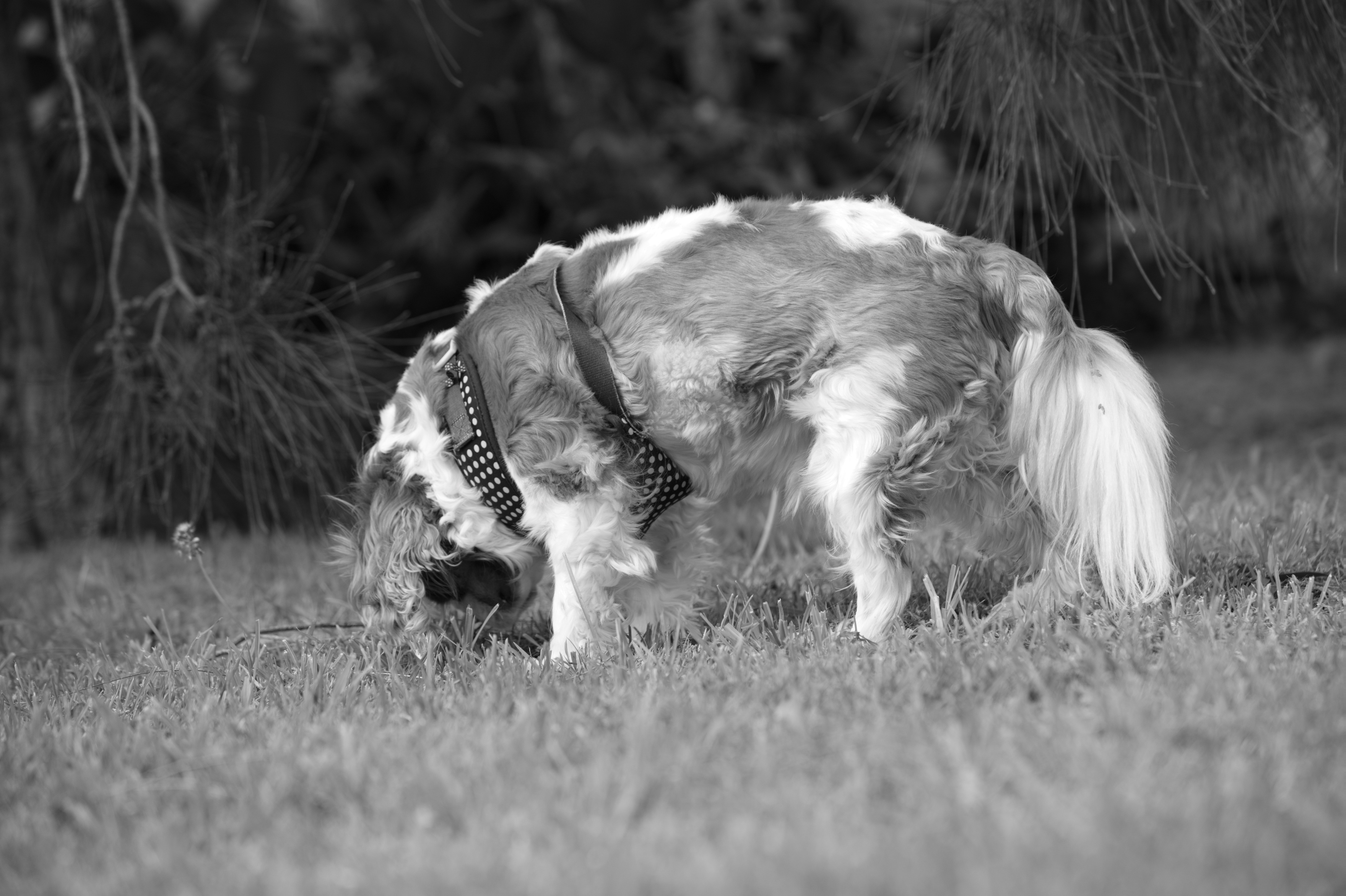

    perfect greys as i said i calibrate my monitors from grey patches. and the numbers.
  • Members 2631 posts
    May 29, 2023, 9:11 a.m.
    all good. does Bobs B&W image of the dog look perfect greys ?
    May 29, 2023, 9:19 a.m.
    But after Bob said:
    and that for all the pixels R=G=B, do you really believe anyone would expect you to say anything but that they are perfect greys on your monitor? 😎
    Now whether with your track record of at best bending the truth when not completely making things up, I at least will never know if they are perfect greys on your monitor or not 🙂
    But even if they are, if you understand the concept behind profiling a monitor (as opposed to calibrating it) you would know that just because the greys display correctly does not mean in any way that all colours will as well 😎

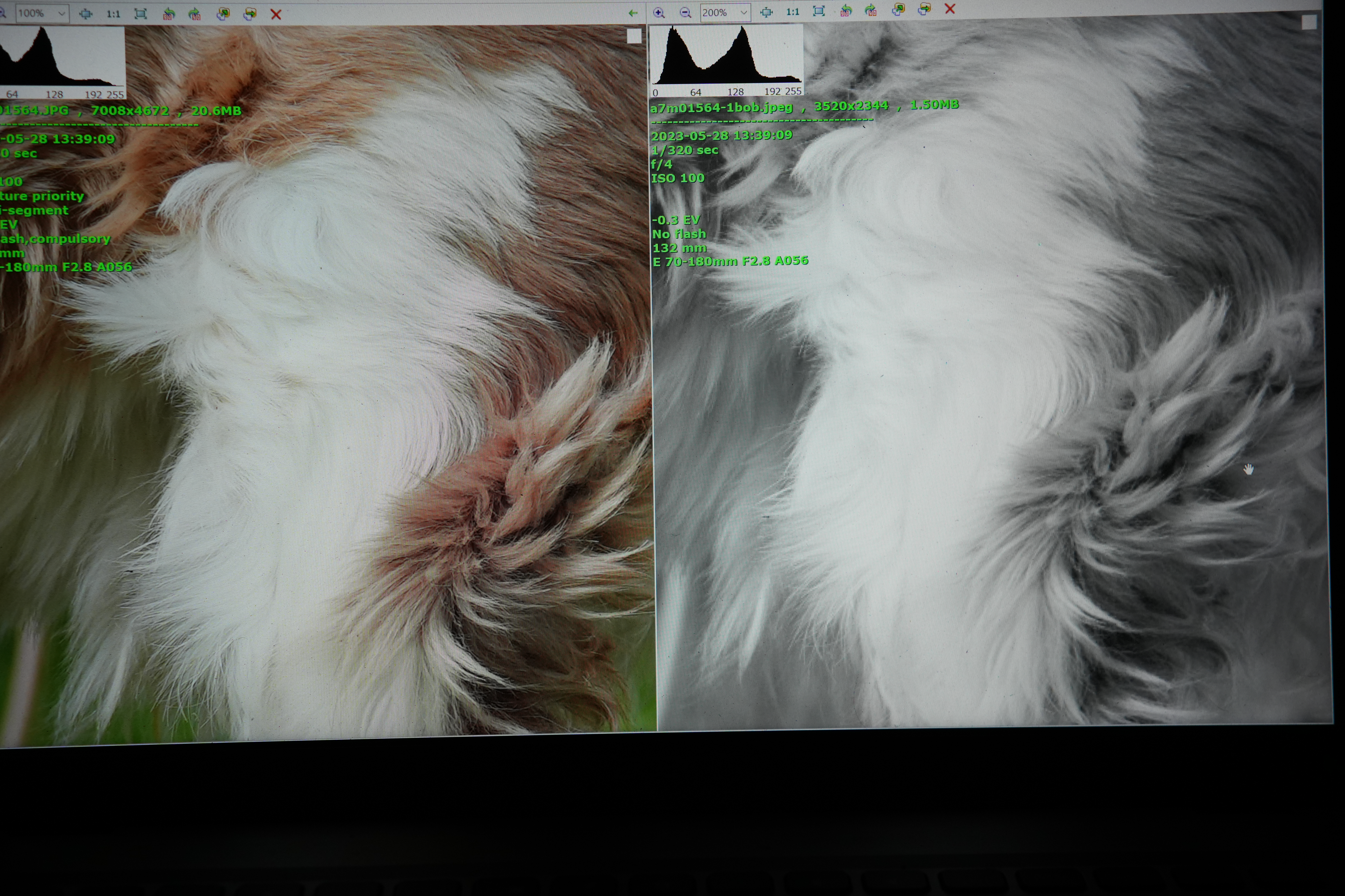

    this is a photo of my laptop monitor.
    JPG, 24.0 MB, uploaded by DonaldB on May 29, 2023.
    May 29, 2023, 9:28 a.m.
    Maybe it is, maybe it isn't. Maybe it another prefabricated image to suit whatever agenda you are pushing at the time.
    But even if in Bob's version they are perfect greys on your screen, if you understand the concept behind profiling a monitor (as opposed to calibrating it) you would know that just because the greys display correctly does not mean in any way that all colours will as well 😎 as shown in the different rendition on your screen of the dog image I posted 🙂

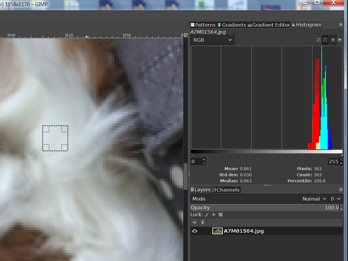

    Do you see the numbers? Do you understand the numbers? What in the numbers tells you "too yellow"?

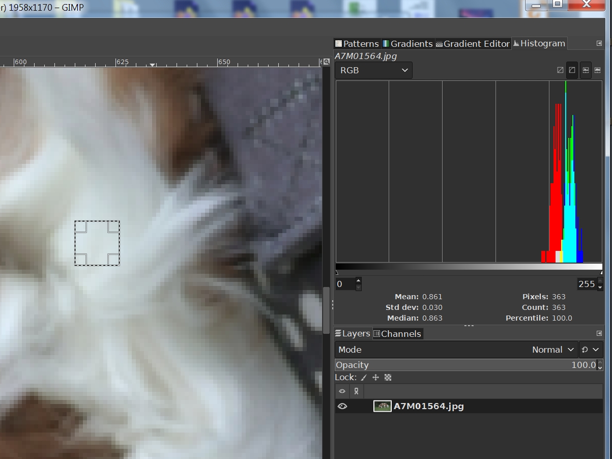

    May 29, 2023, 2:31 p.m.
    Metadata contains a record indicating manual adjustment of white balance is dialed in:
    [MakerNotes] 0x2026 WBShiftAB_GM_Precise: -0.50 -0.50
    Sony IEDT confirms this adjustment is active.
    Numbers in IEDT confirm that whites have cyanish tint.
    Numbers from the TIFF rendered through Sony IEDT as-is, with only the camera settings applied, also confirm cyanish tint on whites:
    PNG, 1.3 MB, uploaded by IliahBorg on May 29, 2023.

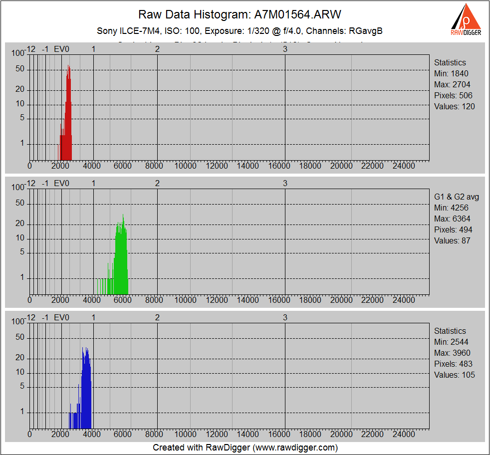

    White Fur by-more-numbers:
    Looks white-ish on my monitor ...
    Raw:
    Lower red channel in my histogram confirms your by-the-numbers cyanish tint!
    PNG, 40.5 KB, uploaded by xpatUSA on May 29, 2023.
