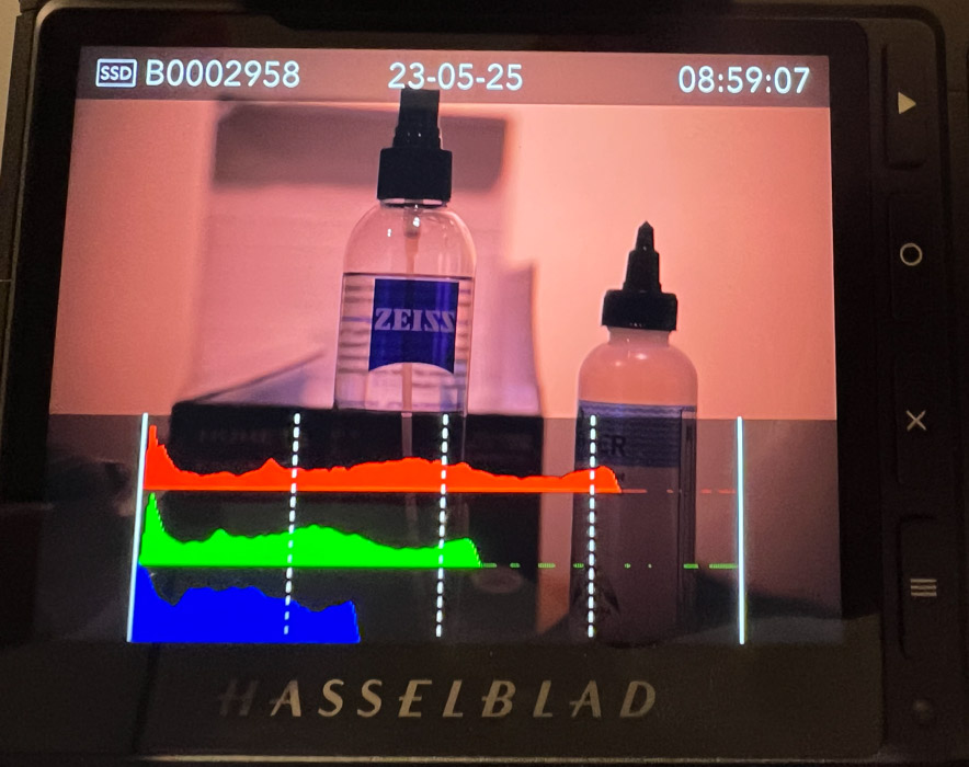

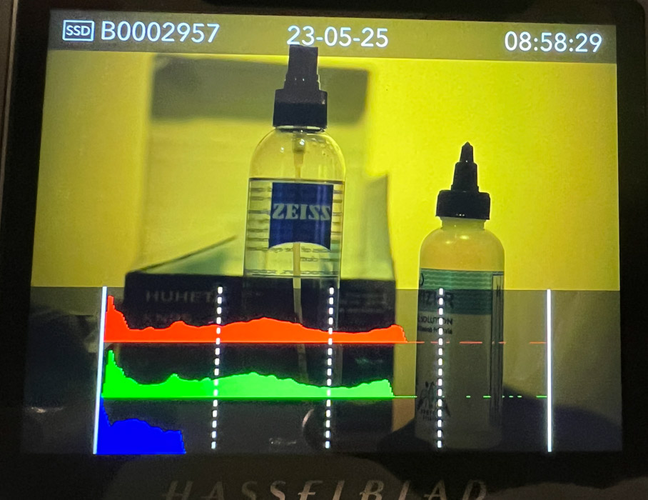

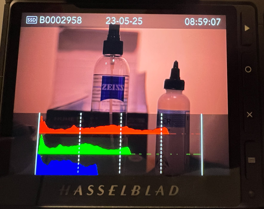

  • Members 1738 posts
    May 25, 2023, 5:23 p.m.
    JPG, 177.1 KB, uploaded by JimKasson on May 25, 2023.
    JPG, 158.8 KB, uploaded by JimKasson on May 25, 2023.
