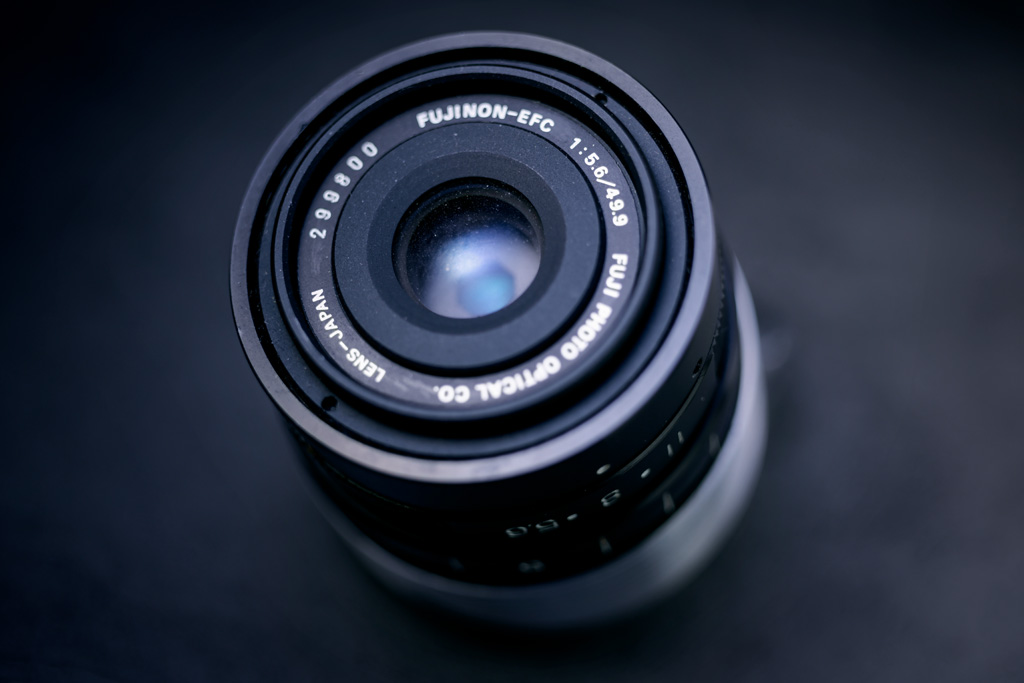

    To me 50 mm felt way too narrow... so I got myself a 49.9 mm lens: 😂
    Just kidding! But perhaps my Agfa Mikrogon 27.7 mm might do the trick? 😉

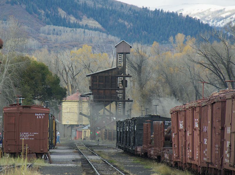

    But of course. And, that's one significant thing you get with a telephoto lens, magnification onto your sensor. Beats cropping a teeny part of an image with the reduced resolution. Both give the same perspective, one just looks crappy.
    Now, this is just a bit of opportunistic example-ing, some photos I took back in 2015 that give the opportunity to see what magnification buys. I posted one of these earlier in the thread, here it is again so you don't have to pan up to find it:
    200mm magnification, 35mm (FF) format.

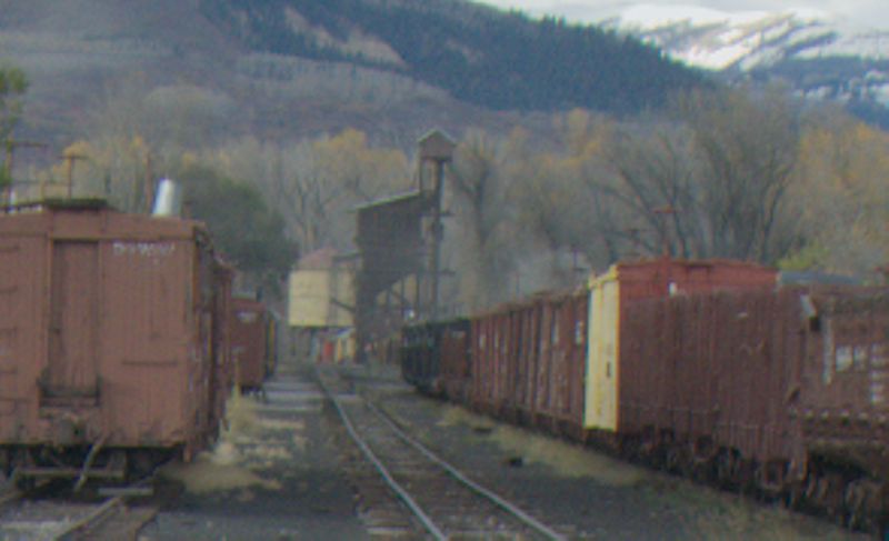

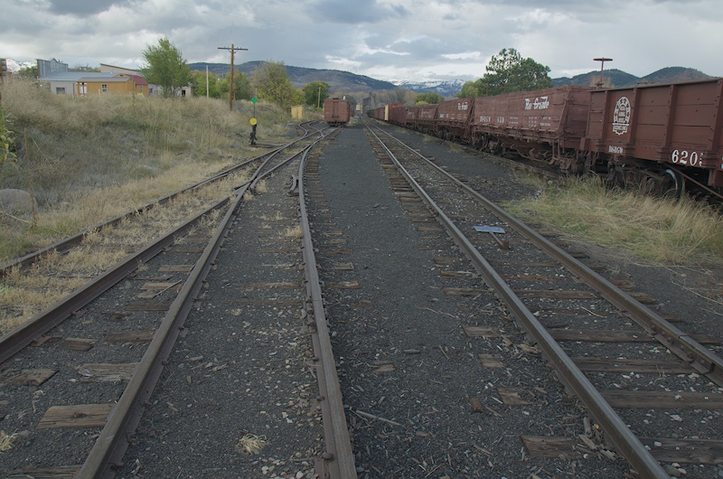

    Now, here's a wide-angle shot looking in the same direction, note that I'm not standing in the same place, a little further back:
    Sorry I don't have a wide-angle shot of the first image, but I'm going to now post a crop from this one that tries to approximate the first one:
    Crappy. About the same perspective, though.

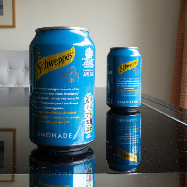

  • Members 483 posts
    July 9, 2023, 7:02 a.m.

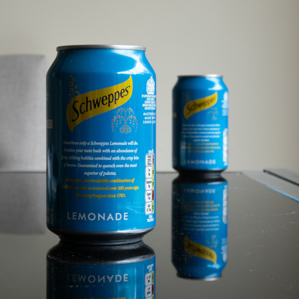

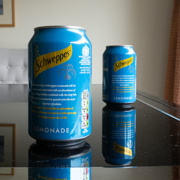

    At first glance, the photos below look very similar. On further examination, the background shows they are quite different. However, if the cans were on a plain and featureless background, the two cans are about the same size and position and the photos would look very much the same.
    In the first shot, the cans were 25cm and 50cm from the camera, while the second shot used double the focal length and the cans were 50cm and 100cm from the camera.
    At a quick glance, particularly if the background was made plain and featureless, the observer would think that the distances of the cans from the camera was about the same in the two photos.
    Of course, if we know the focal lengths used, or if we examine the pictures more closely, we can deduce that the distances must have been very different. Nevertheless, on first glance our immediate judgement is that the distances are about the same.
    A shot at one focal length appears the same as a shot at double the focal length with all distances (from the camera) doubled.
