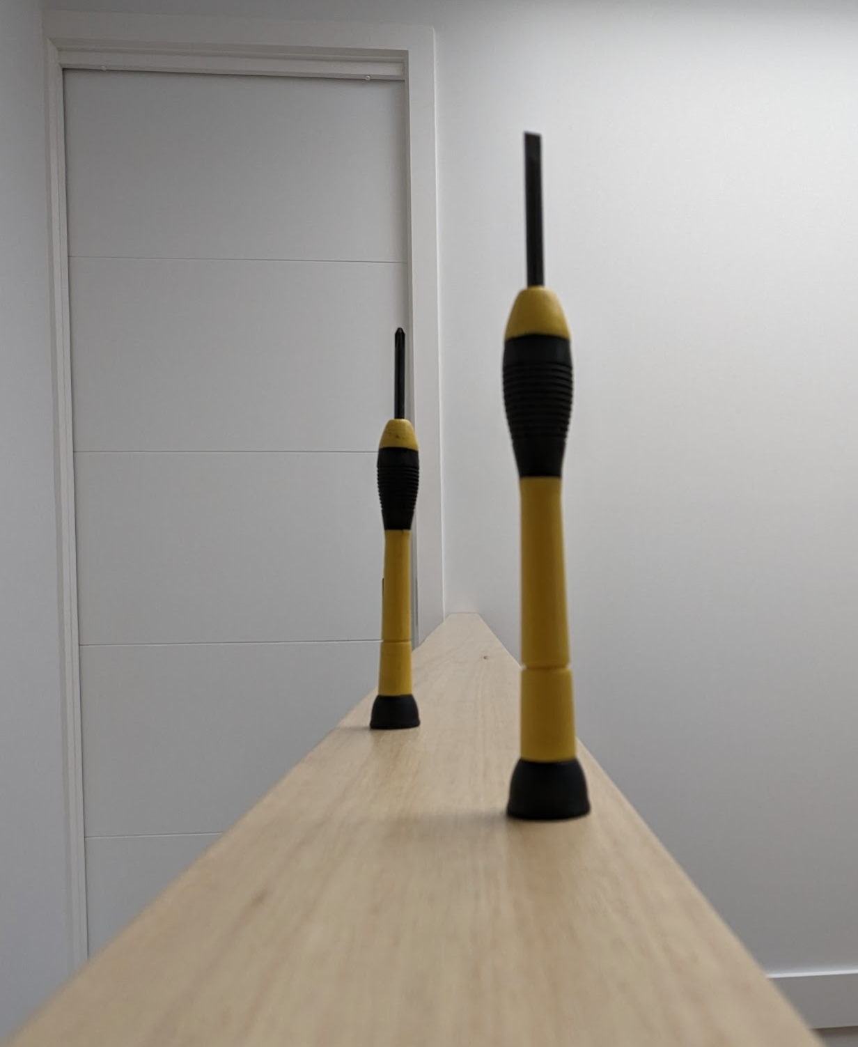

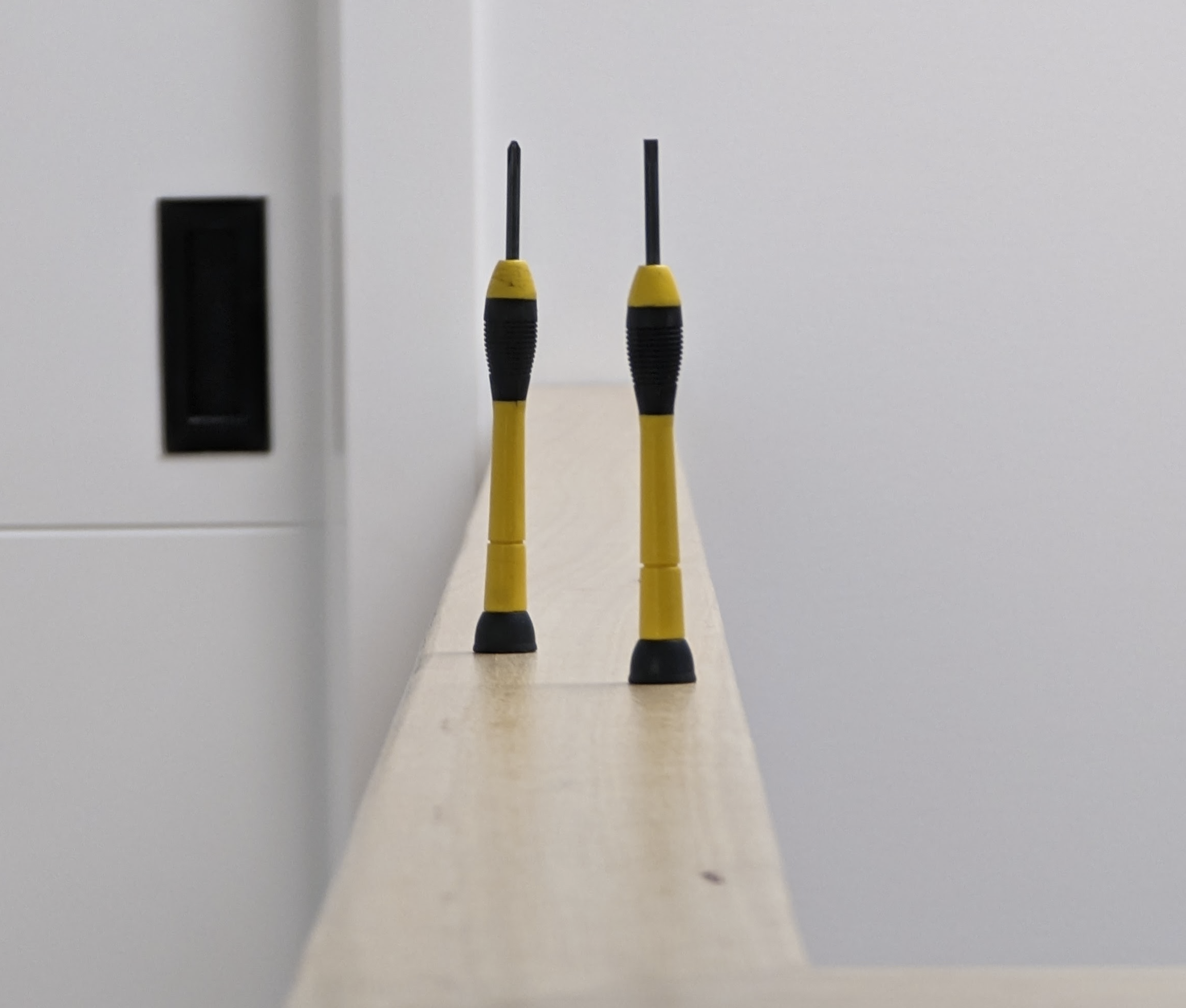

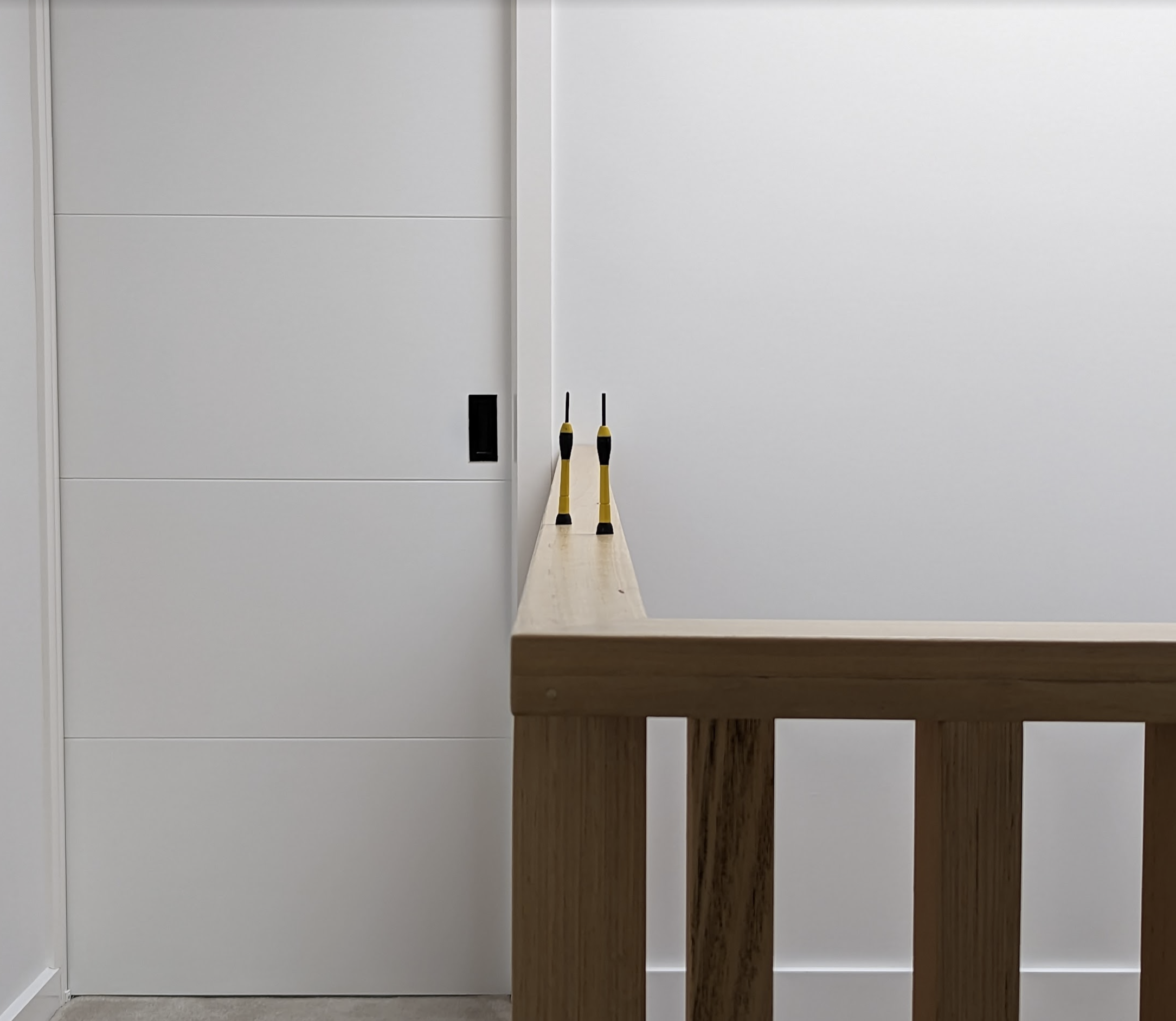

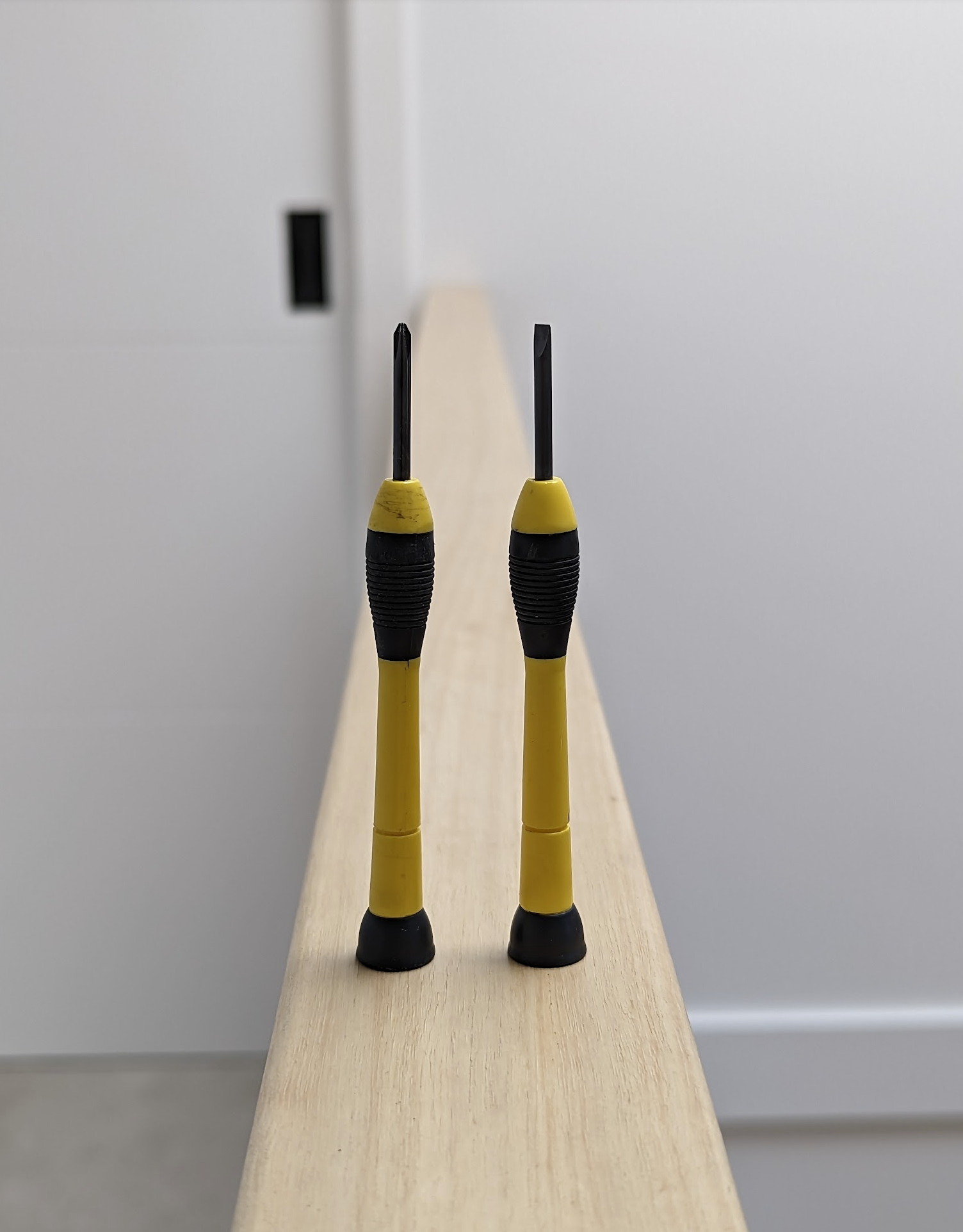

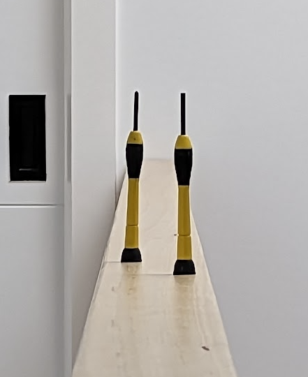

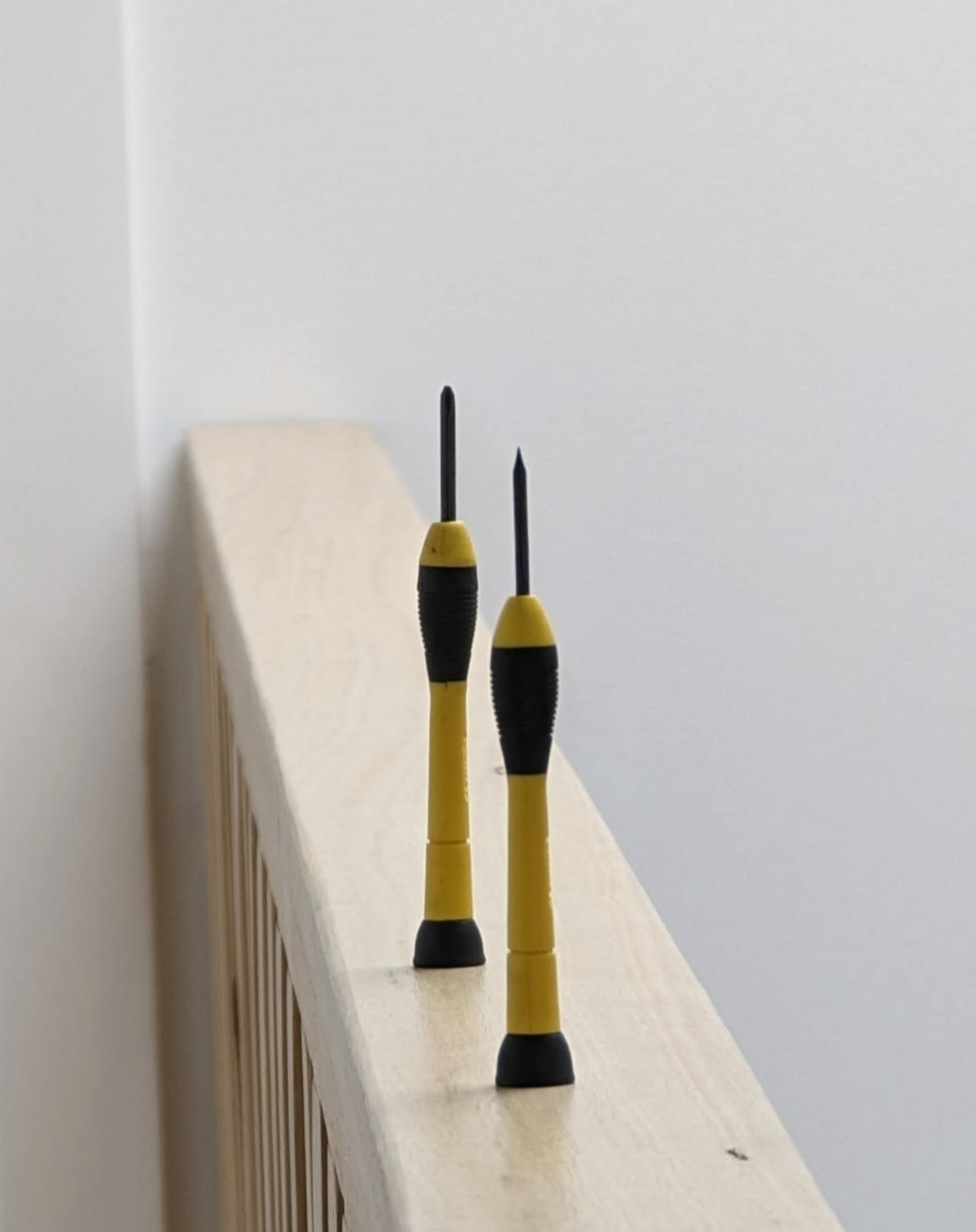

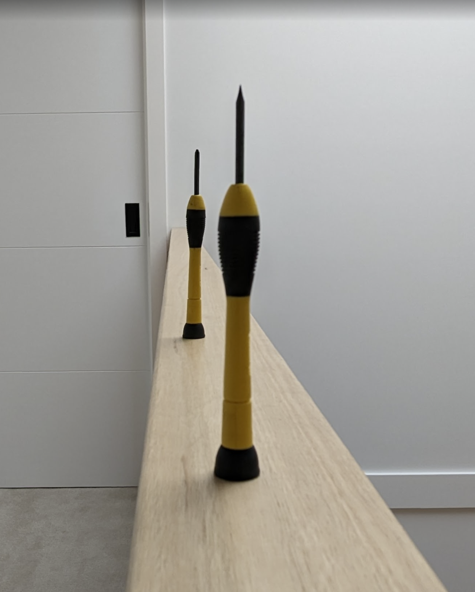

    May 24, 2023, 6:09 a.m.
    Ok so here's more to illustrate that the 'compression' depends on the distance to the subject(s) not on the focal length.
    1. This shot shows the screwdrivers are the same size:
    2. This one is taken close-up with wide angle:
    3. This one is taken at a distance with a longer focal length:
    4. ... and this one is taken at the same distance as the previous one (#3) but with a wider lens
    As you can see the relative angular sizes of the screwdrivers in (3) and (4) are the same.
    If we heavily crop #4, it'll be pretty much the same as #3:
    PNG, 115.3 KB, uploaded by Quarkcharmed on May 24, 2023.
    PNG, 1.5 MB, uploaded by Quarkcharmed on May 24, 2023.
    PNG, 2.5 MB, uploaded by Quarkcharmed on May 24, 2023.
    PNG, 859.4 KB, uploaded by Quarkcharmed on May 24, 2023.
    PNG, 919.2 KB, uploaded by Quarkcharmed on May 24, 2023.

  • Members 191 posts
    May 24, 2023, 6:25 a.m.
    See my message above with more example shots.
    'Compression' is not about how far away you feel the objects are, it's about their relative angular sizes and apparent distance between the distant objects. As you can see, in the shot #2 the screwdrives are apparently far away from each other, but in #3 the apparent distance between them is not so big, and the apparent sizes of the screwdrivers (angular sizes) are almost the same.
