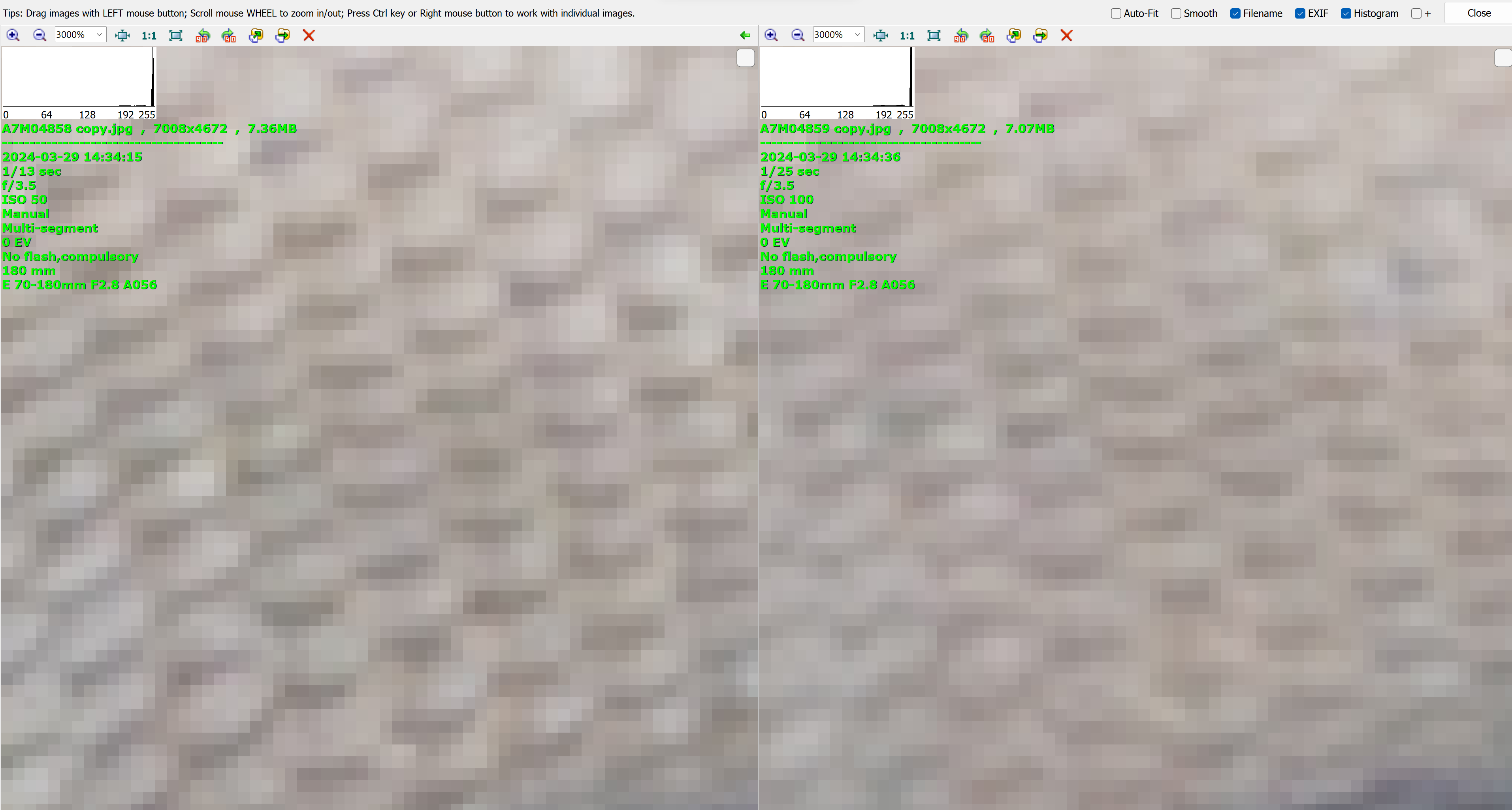

    March 29, 2024, 4:58 a.m.

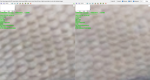

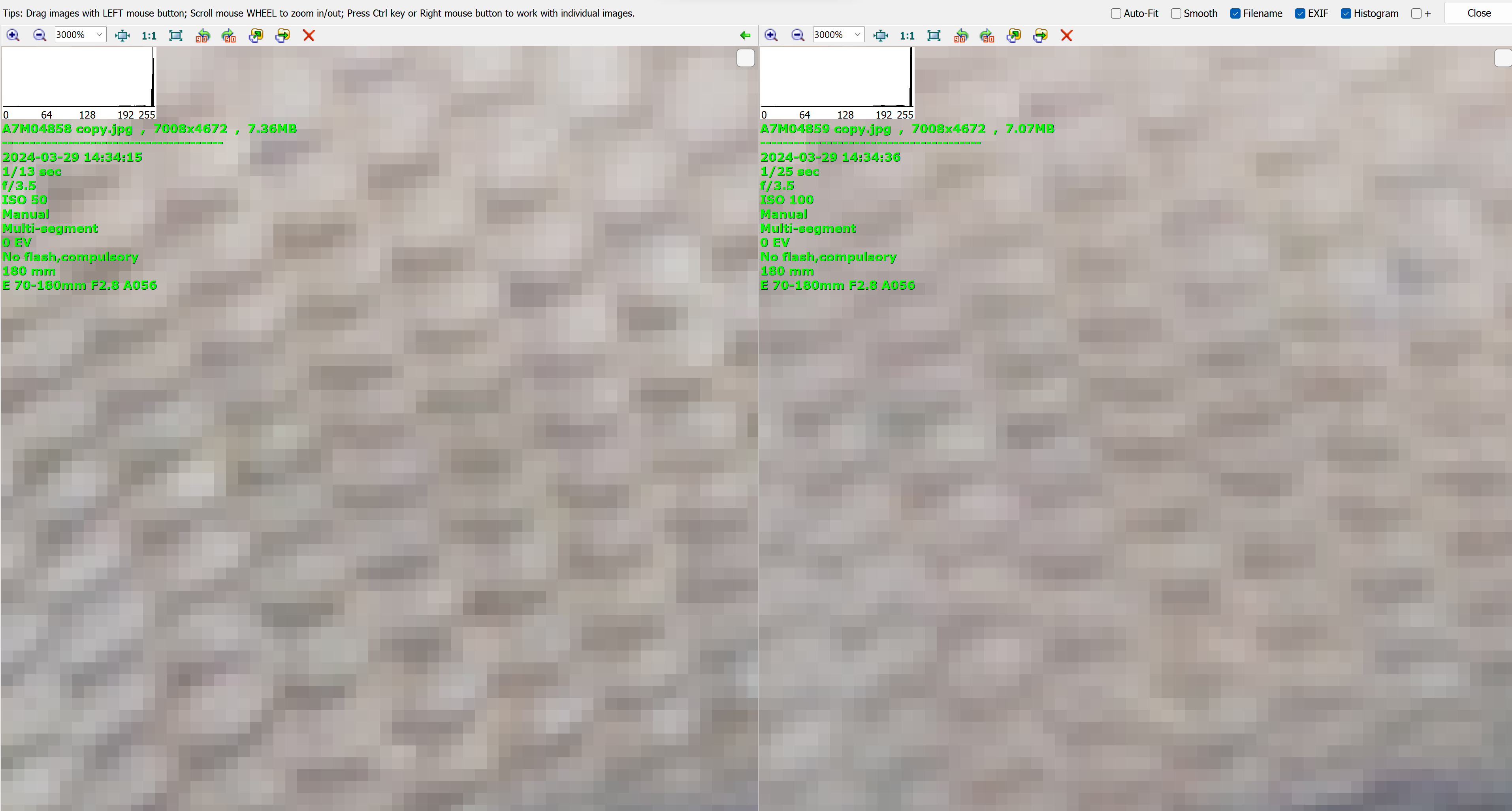

    you dont gain 2 stops useing extended iso's 50 vers 100 just tested my a7iv ,in fact as it should you loose dr and information, its suptle but you can see the difference at 3000 % i wouldnt hesitate useing iso 50 on my a74 if needed though as its nearly identical.

  • March 29, 2024, 7:30 a.m.
    As I said, it's not 2 stops, it's 1.5. And I explained where it comes from.
    Sorry Don, that test tells you exactly nothing about 'DR and information'. It doesn't get to ISO 100% exposure and it doesn't go down to the deepest shadows. As was discussed upthread, you can't display all of the DR that a modern camera can capture - the very best display tops out at about 10 stops.
  • Members 2650 posts
    March 29, 2024, 8:07 a.m.
    thats where your wrong, i did shoot a 100% DR shot and this is in the middle tones ๐Ÿ˜ why ? because thats where DR is most important ,in mid tones, and you can clearly see camera manipulation to the file โ˜บim tired of seeing in camera raw file manipulated shadow noise and squashed highlights that everyone posts.
  • March 29, 2024, 11:23 a.m.
    On the contrary, the middle tones tell you nothing whatsoever about DR. How could they? DR is all about the limits. Maybe you're confusing DR with SNR.

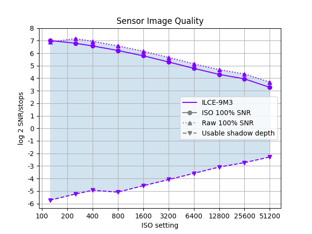

  • March 29, 2024, 5:29 p.m.

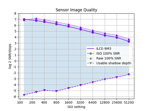

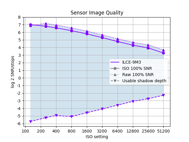

    Correct. I developed it for AP magazine. The idea is a simple to use/understand metric of sensor quality, for normal photographic use. Most photographers meter by the camera, so if one bases a metric on the understanding that they will meticulously use all the raw headroom then most photographers will not see all of teh performance indicated. The full 'metric' is shown like this:
    The major line shows SNR at 100% ISO, plotted log to relative to 1 (2^0). This gives an indication of how 'noisy' the image will look. The dotted line shows the SNR if the photographer makes full use of the raw headroom. The dashed line shows the 'Usable Shadow Depth' (aka 'DR') plotted relative to the major line. The Y axis legend is a bit non-intuitive for this - the reader needs to look at the difference between the two lines to work out how many stops below 100% is the usable shadow. On the other hand, it's visually apparent just by looking at the graph.
    It's normalised, as I said to and A3 print at 360 ppi. The reference point for 'usable shadow' is SNR=2. This sounds very low to many, but as I explained before, you'll never see a lot of detail or tonality in the Zone 1 shadows (Zone 0 is black point), and if your reference is a 360ppi print at normal viewing distance, then SNR=2 looks pretty good (I've tried it), unless you're using an old 5D - then you have to whack all the pattern noise.
    Mostly, people won't bother with the technicalities, but the graphic illustration gives a nice illustration of the 'quality envelope' of cameras. For instance, here it's quite easy to see that the extra DR at 125 ISO comes from lower RN (Sony does some crazy things with its gain settings), or 'in the shadows'.

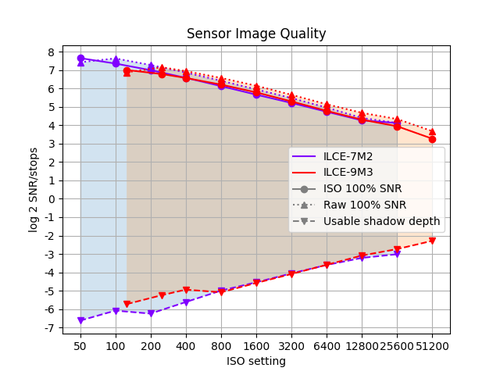

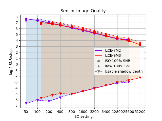

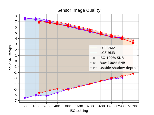

    It can even be used to compare, as follows.
    Which shows what has been sacrificed for the global shutter.
