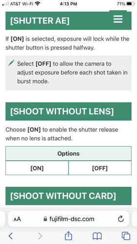

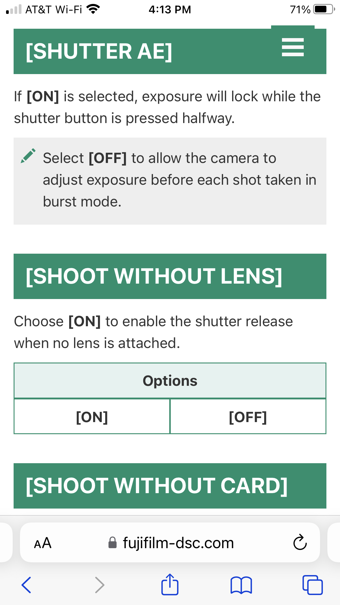

    You must have the SHUTTER AE option enabled for both AF-S and AF-C (though you may not want your exposure locked in AF-C).

    ErikWithaK
    Members 215 posts
    April 20, 2023, 8:15 p.m. April 20, 2023, 8:15 p.m.
    @MustafaK has written:
    Do you mean interlock spot AE and Focus Area (page 133 in user manual)? It is set to ON.
    No, SHUTTER AE, it’s in button and dial settings (the exposure must be locked to see the ISO value)...

    Erik, thank you. I set Shutter AE for both AF-S and AF-C to ON, but there is no improvement. In EVF I see still the max. ISO value. Dou you possess X-S10? If yes, would you please check this? Thank you.

    Excuse me. I checked that under low light conditions at moment. You are right, now the correct ISO value is shown, if I set the max. ISO value to a higher value.

    If you’re in Auto-ISO it will always read the max limit unless the exposure is locked (AEL assigned to a button will work too). I highly recommend setting an ISO 12800 limit for all three presets and a different minimum SS for each for the best performance.
