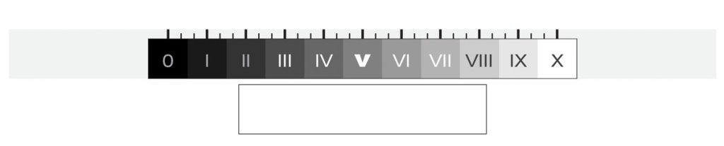

    We often see Zone V equated to Middle Gray but is rarely mentioned that there are other shades of gray within the Zone.
    I was quite pleased today to find this illustration:
    It is clear that middle gray (generally agreed to be 18%) is indeed in the middle of Zone V, but I had to know what is the range of reflectance represented by Zone V ?!
    I asked AI:- it said "12% to 24%" but, with AI, it can pay to check - so I figured out how to calculate the range:
    I make the Adams/Archer Zone V range of reflectance to be 12.728% to 25.456%.
    Interestingly, in the similar and contemporary chart by Kodak, 18% middle gray is not in the middle of the similarly-described range of reflectances e.g. "weathered wood" ... nowhere near, in fact ...
    Anybody know how to go half a stop each side of 18?

    Oct. 12, 2024, 6:54 a.m.
    I'm sure you know this!
    To go one stop above, multiply by 2. To go one stop below, divide by 2.
    To go half a stop above, multiply by the square root of 2. To go half a stop below, divide by the square root of 2.
    So, half-stop intervals around 18 are: 9 .. 12.73 .. 18 .. 25.46 .. 36 .. 50.91 .. 72 .. 101.82
    I think I have probably misunderstood your question - please put me straight!

  • Members 562 posts
    Oct. 12, 2024, 11:44 a.m.
    I have never used the zone system myself, but I understand that each zone covers one stop.
    If that is the case, then Zone V will be 5 stops below Zone X.
    So Zone V would be from 1.5625% to 3.125% grey.
    Then 18% grey would be roughly in the middle of Zone VIII (12.5% to 25%).

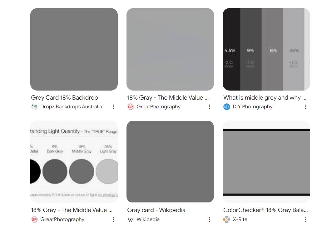

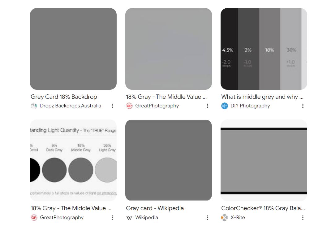

  • Members 2665 posts
    Oct. 13, 2024, 8:58 a.m.
    which one is correct

  • Members 1639 posts
    Oct. 13, 2024, 11:46 p.m.
    After some more research, it looks like Kodak's numbers are based on a span of 0.5% to 90% reflectance:
    photometric.coffeecup.com/exposure/orig%20Kodak%20step%20table%20hilit-1.jpg
    Based on that, I did a spreadsheet to find the "middle" of Kodak's Step 3 (their equivalent to Zone V):
    photometric.coffeecup.com/exposure/Kodak%20Half-steps.gif
    So not real close to the oft-quoted Adams' 18% - but I do recall reading that Kodak preferred 16% as "mid-gray", so their "15.9%" above comes as no surprise to me ...

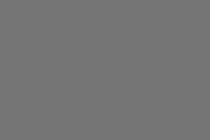

    Oct. 14, 2024, 5:27 p.m.
    According to ISO/CIPA middle gray is 0.461 of max so, for 8-bit, that is 0.461 x 255 = 118.
    Therefore, none of the above according to my screen color-picker.
  • Oct. 14, 2024, 5:53 p.m.
    You forgot gamma correction? One online tool gives sRGB 0.461 = linear 0.18 (normalized values), thereby for 8-bit 118 equals to 18% of gray :)
    /edit/
    I likely misunderstood your claim. 118 for 8bit and sRGB is correct, but images, from what you pick your colors, are most likely not correctly made.
    What your screen color picker dispalys for next one - should be 117 or 118 (sRGB 118 ≈ Adobe RGB 117):
    JPG, 4.6 KB, uploaded by ArvoJ on Oct. 14, 2024.
