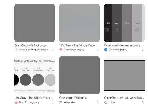

    Yes, it displays RGB 117,116, 117.
    It is not a claim, Arvo. It is taken from this Japanese Standard:
    kronometric.org/phot/std/DC-004_EN.pdf

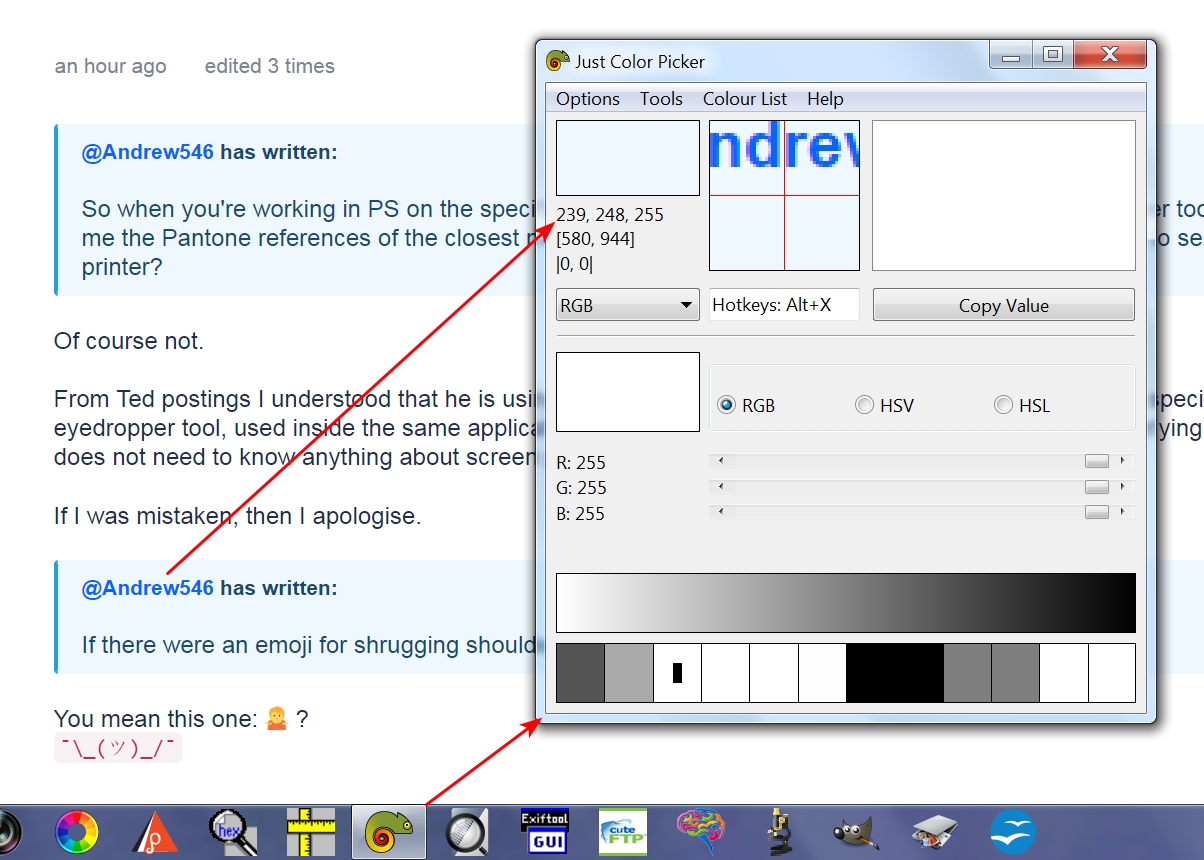

  • Oct. 18, 2024, 10:05 p.m.
    Of course not.
    From Ted postings I understood that he is using some system-wide screen color-picker, not application specific eyedropper tool, used inside the same application. The latest of course knows, what it reads from underlying image - it does not need to know anything about screen properties.
    If I was mistaken, then I apologise.

  • Members 1633 posts
    Oct. 18, 2024, 11:15 p.m.
    ... and here it is ...
    Between the image data and the screen data there exists the matrix-type color profile 'n199sx.icm' ...
    As I said to Arvo earlier:
    ,,, now you know everything ... 😀
