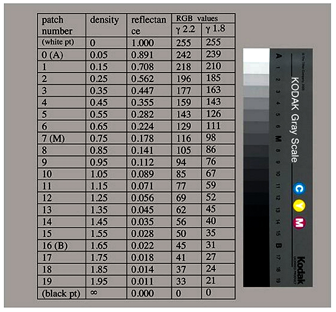

    After more research and discussion here and elsewhere I have concluded that:
    film: the characteristic curve maps logH (illuminance on the film to the resulting log10(Density) i.e. log10(1/(reflectance or transmittance))
    digital: DPR's test curves map the 21 Stouffer steps to 8-bit sRGB.
    Therefore both X-axes are logarithmic: the one base 10; the other base 2.
    BUT the Kodak/Stouffer wedges have a much greater range 0.05-3.05 (10 EV) of density than film say 0.2-2.3 (7 EV) and none of them have 18% gray at the logarithmic mean. Furthermore, most Zone step diagrams don't have 18% gray in the middle, instead showing 127 or 128 out of 255! (everyone and his dog including CIPA/ISO knows that 18% gray maps to 118/255).
    So the Kodak/Stouffer wedges just serve as a reference range for determining the characteristic curve for films - which do vary quite a lot.
    And so-called "middle gray" is picked out of the air by various entities i.e. it is not always 18%.
    Case in point: most Zone tutorials have Zone V at 127/255 i.e. close enough to 0.5 which, working backward to the sensor via 2.2 gamma, gives about 22% exposure, not 18%.
    Recently found this Kodak illustration which maps density to both reflectance and 8-bit RGB (2.2 gamma, also 1.8 gamma)
    Unlike other step-wedges this one has intervals of 0.1 density i.e. neither full nor half steps, but about 1/3 step.

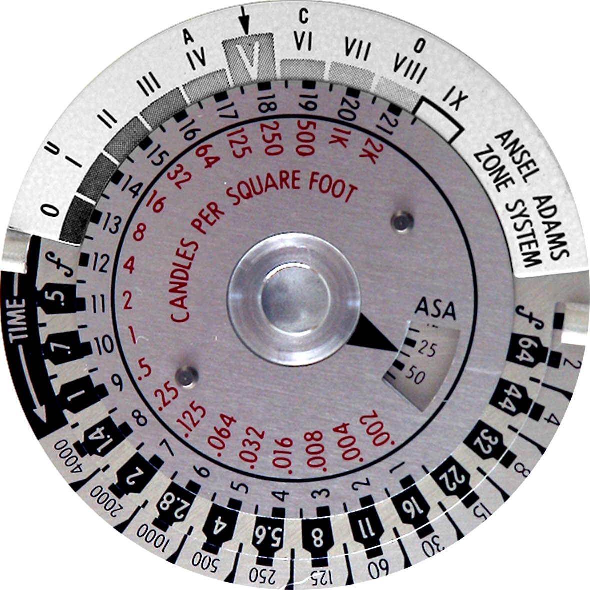

  • Members 1431 posts
    Dec. 3, 2024, 8:44 p.m.
    More about the Weston Master 6 model 560 Ansel Adams 'Zone' accessory dial which differs quite a lot from their regular dial:
    Not obvious but I think, for a normal shot, one aligns the Zone V mark with metered foot-candle value. Then to vary that one aligns another Zone with metered foot-candle value, thereby 'placing' the metered subject into another Zone.
    There's another scale going 1-21 next to the candle values, perhaps Stouffer step-wedge values ... any body?
    Noticeably absent is a window showing EV.
    'A' and 'C' are obviously the 1 EV offsets but I don't know what 'O' represents. Again, anybody?
    P.S. just now noticed the letter 'U', so under- and over-exposed, I guess ...

  • Members 359 posts
    Dec. 3, 2024, 11:31 p.m.
    1-21 or the ft/candle should represent the numbers on your dial (or dials if you have the two scale and flippy thing on the bottom), Each number is a stop apart, and they directly reference the meter scale, nothing else. Take the average reflected reading and use the "V" marking as the line-up arrow. Alternatively if you have a spot attachment then you can read off clouds/blue sky, or shadow values and then you can both choose what zone to place them on (align the reading directly to the zone mark) or see the range and where the values fall which will allow you to assess DR and any development adjustments you may need to make. I.e. if you read off the cloud, it reads "21" and you want it white with texture then align Zone VIII with "21". Anything that reads "14" in the picture will be on the limit of any detail in the shadows. But you have to calibrate your development times against negative densities. YOur shutter/aperture combinations are indicated on the dial for the film speed set in the window.
    That's how they normally work. But my Master V only goes up to 16 and I can't see a picture of the needle scale for your meter.
    EDIT: There are Weston meters that do have a scale that runs to 21, (the Ranger 9) so the dials may fit multiple models and/or you have a modified dial that fits a number of models, hence the dual scale.

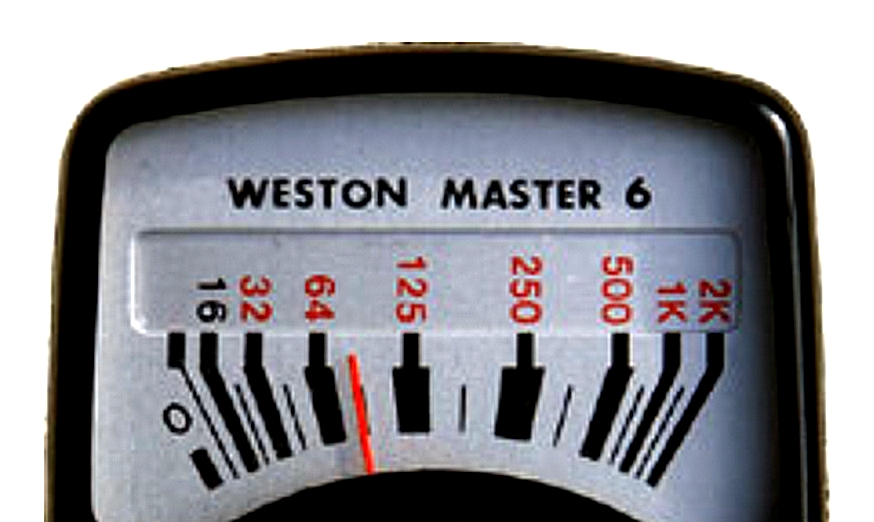

    Dec. 4, 2024, 2:15 a.m.
    Thanks, I have never developed or printed film and don't intend to - my Weston is just a collectible toy
    Mine goes 16 to 2K with the slider covering the sensor and 0.125 to 32 with it slid out of the way of the sensor, in other words changing the slider toggles the meter scale.
    As it stands, the dial above looks to be recommending 13 EV for 250 fc, e.g. f/8 at 1/125 sec for 37.5 ASA when VIII is aligned. with 21, FWIW.
    Dec. 4, 2024, 4:39 p.m.
    So, to 'place' the metered subject into Zone VI, one would align VI with just under 250 fc. f/8 would now align with 1/60 sec, thereby doubling the exposure i.e. increasing the exposure by one Zone.
    Here's the meter scale, BTW, with the slider covering the sensor :

  • Members 359 posts
    Dec. 4, 2024, 7:19 p.m.
    LOL, something I used to do all the time with 35mm, meter off the palm of my hand which was the Zone VI reading.
    To place the meter reading on Zone VI you literally place the meter reading on Zone VI, set the "17.5" or mid point between 64 and 125 to Zone IV. If you make a reading off the palm of your hand then it will be reading a reflected light value of one stop above middle grey, so your middle grey should theoretically sit half way between 32 and 64.
