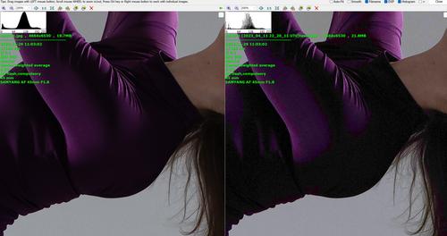

    JPG, 1.7 MB, uploaded by DonaldB on April 20, 2023.

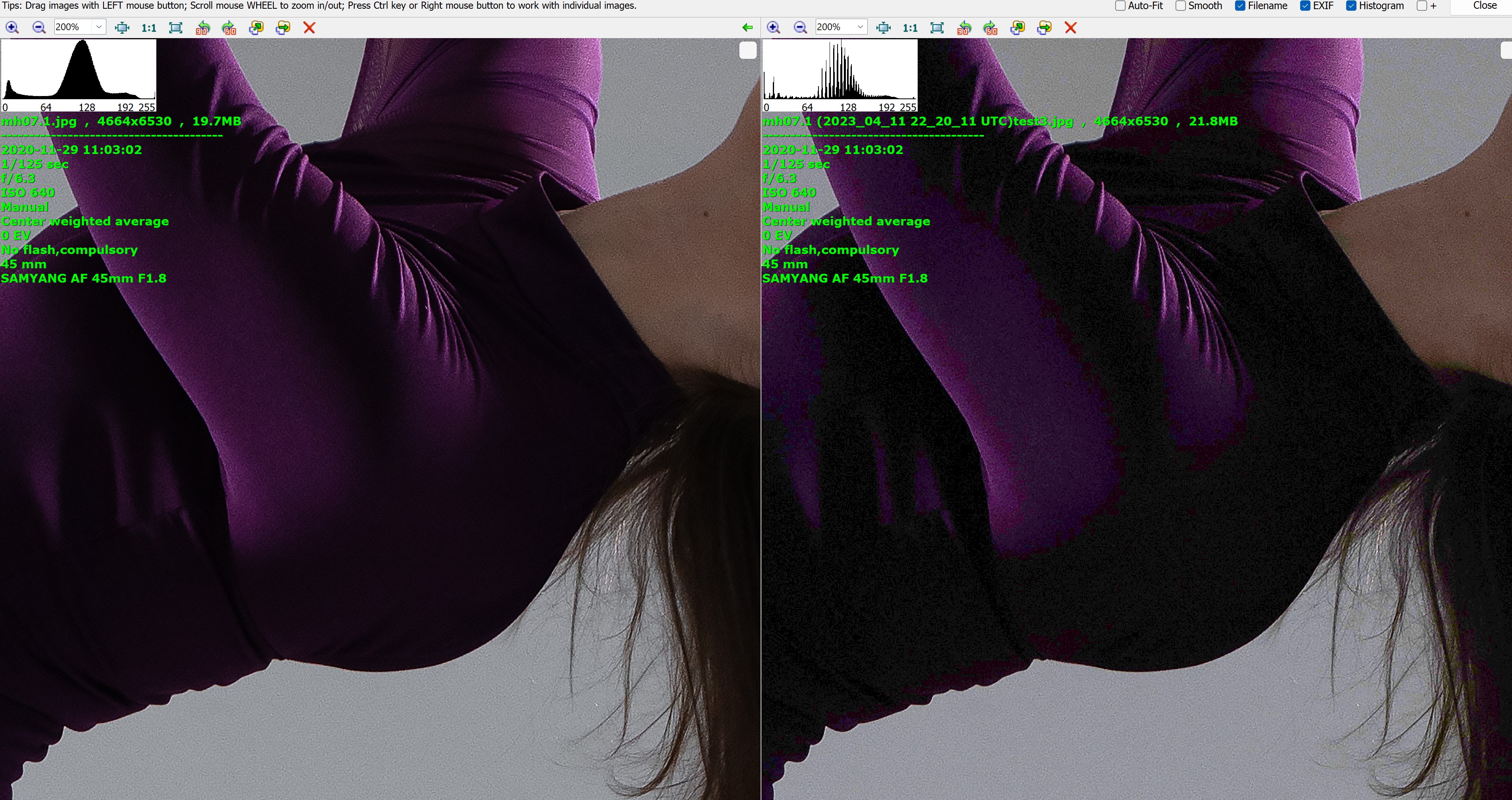

    test shooting 4 stops then raising in post compared to raising in camera. just shot some test shots in my studio.
    first shot iso 1250 raw processed ACR no processing
    second shot iso100 not quite 4 stops under exposed.
    conclussion the images looked near enough identical if anythin i would give the prize to the 100iso lifted in ACR close.
    dont know what you wanted but i just dont shoot 4 stops under as i shoot live,.

    Thank you, you have confirmed my previous post. Take ISO out of the equation, it doesn't matter. Just set whatever shutter speed and aperture you need to get the shot and ignore ISO. You'll underexpose and get a dark preview but when you edit and brighten in post, the image will look about the same as it would if you boosted ISO. Or if it makes you feel better to boost ISO, do so but it doesn't matter.
    These threads have pretty much all been red herrings, for practical purposes the only thing changing the ISO changes is the brightness of the preview on the back of the camera.

    pretty much my conclusion from my test shots tonight. BUT i have to use iso all the time as i shoot live monitors. just tested AF and the boost on the a74 is amazing and iso makes no difference.

    i will also comment that the colour tones of the underexposed 100iso lifted were more saturated and pleasing even though the noise was the same. good test and we both have learn someting new or at least confirmed some common misconceptions. modern cameras are awesome.
