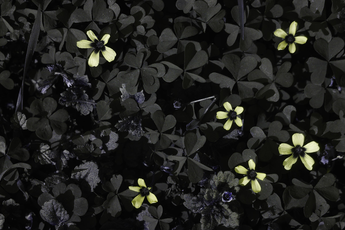

    [IMGP3677yellowflowersingrass.jpg] (/a/mUMQxwsVf8Ff6VEMdozErOzbxdMmrf3IuU5sibqOTRbyyqVnlKL3ZpilmNAjSMVu/5612/?shva=1)
    JPG, 247.8 KB, uploaded by barondla on April 26, 2023.

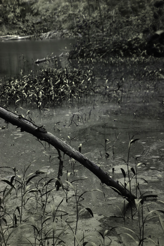

    Cross posted in Today With Your Pentax. Tywappity Lake in UV. Pentax K-1 with metal EL-NIKKOR 85mm enlarging lens. Hoya U360 (2mm thick) and Schott S8612 (2mm thick) stacked filters. ISO 1600, F8 at 5 seconds. The wind was making things difficult. IMGP8677tywappitylakeUV.jpg
    Thanks for looking,
    barondla
    JPG, 213.7 KB, uploaded by barondla on May 3, 2023.

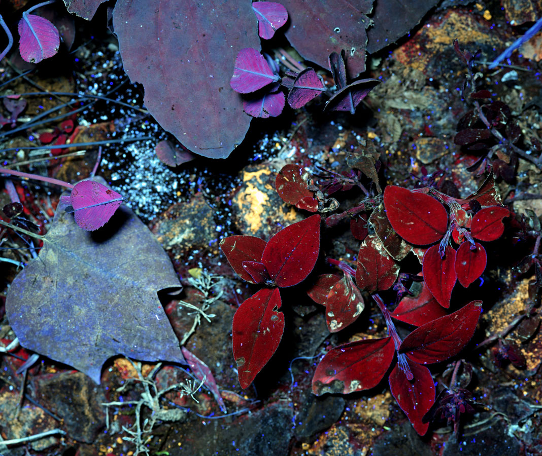

    This is an UltraViolet Induced Visual Fluorescence (UVIVF) photo. Some subjects lit by UV emit visual light. Light purity matters a lot. Used "Nemo" 365nm flashlight with built in filter to illuminate subject. The flashlight filter eliminates anything approaching visible light. Stock Pentax 645Z camera, Pentax A series 120 macro with Tiffen Haze 2A. The haze filter eliminates UV contamination of the visual fluorescence.
    JPG, 349.5 KB, uploaded by barondla on June 29, 2023.

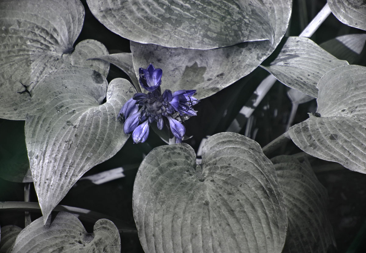

    UV image. Pentax K-1 full spectrum modified by Kolari Vision. Nikon El-Nikkor 135mm metal enlarging lens. Added a Canon C-6 front teleconverter for more magnification. More glass is usually avoided since it reduces UV light. This giant, over 3" across, converter seems to work fine in this situation. Probably helps that it has very little, if any, lens coatings. Used my filter standard stack, of Hoya U360/Schott S8612, to remove visible and IR light. ISO 400, F11 at 30". Most things are colorless in UV. The blooms are an exception.
    Thanks for looking,
    barondla
    JPG, 218.1 KB, uploaded by barondla on July 15, 2023.

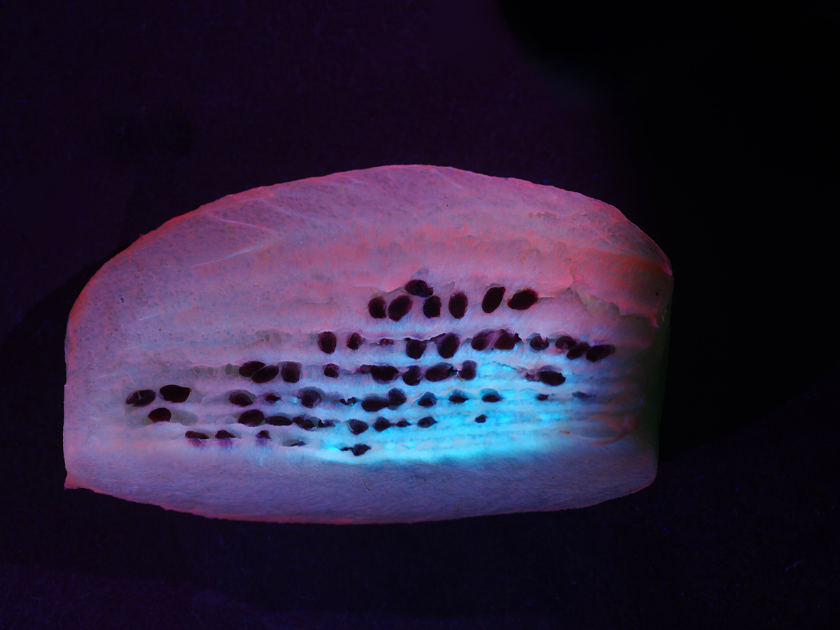

    @simplejoy you probably know that UV Induced Visual Fluorescence (UVIVF) is done with a stock, unmodified camera. You just need a filtered UV light source. This can be a modified electronic flash, an UV flashlight, or the Adaptalux with UV arms. It also helps to use a filter on the camera lens to block UV. Most of my UVIVF images use a stock Pentax 645Z.
    Reflected UV can sometimes be done with a stock camera. But, just like IR with a stock camera, exposure times are very long. I used to do IR with a 6mp Pentax *ist DS DSLR. It had a much weaker internal filter that let at least 1 stop more IR thru than other cameras. I've also done IR with the stock 645Z at 3200 or higher ISO. Long exposures are required but high ISO looks ok on that camera. No doubt for reflected UV and IR a modified camera is best.
    The US has Kolari Vision, Lifepixel, and Max Max doing conversions. I went with Kolari because they modify Pentax and Lifepixel doesn't. Didn't learn about Max Max untill later. To find a company willing to modify your camera in Europe check out robertreiser.photography/infrared-camera-conversion-service/
    This site has a listing of worldwide modification services. Be careful, not all companies do all types of cameras or mods.
    UVIVF of Kiwi plant. Two Adaptalux Pod Mini with UV arms, Pentax 645Z with Pentax 645 120mm macro lens and Tiffen Haze 2E filter.
    Thanks for looking,
    barondla
    JPG, 390.0 KB, uploaded by barondla on July 20, 2023.
