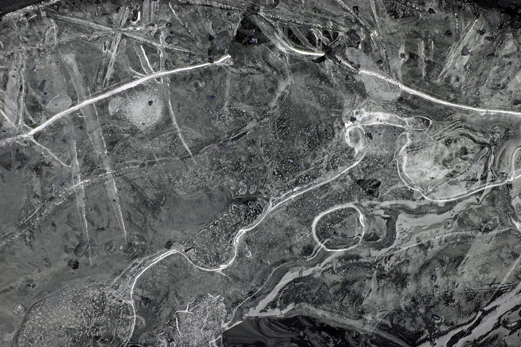

    Dec. 21, 2023, 6:03 p.m.
    Ice in UV. Kolari Vision modified Pentax K-1 with metal mount EL-Nikkor 80 enlarging lens and Hoya U360/Schott S8612 filter stack. ISO 100, F11 at 30". This was ice frozen in dog's water bowl. At least I finally got time to shoot something!
    Thanks for looking,

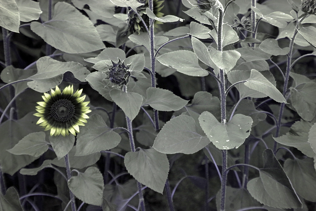

    Aug. 27, 2024, 7:48 p.m.
    Sunflower field in UV. Pentax K-1 full spectrum modified by Kolari Vision. Nikon EL-NIKKOR metal 80mm F5.6 enlarging lens with Hoya U-360 (2mm thick)/ Schott S8612 (2mm thick) filter stack. ISO 6400 1/4" at either F5.6 or 8. waited forever for the wind to subside.
    Thanks for looking,
