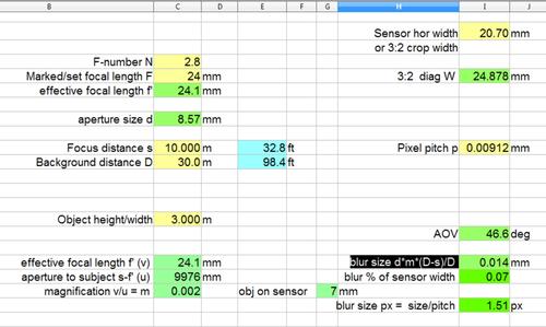

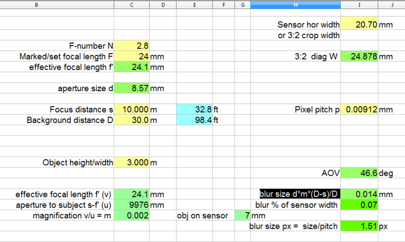

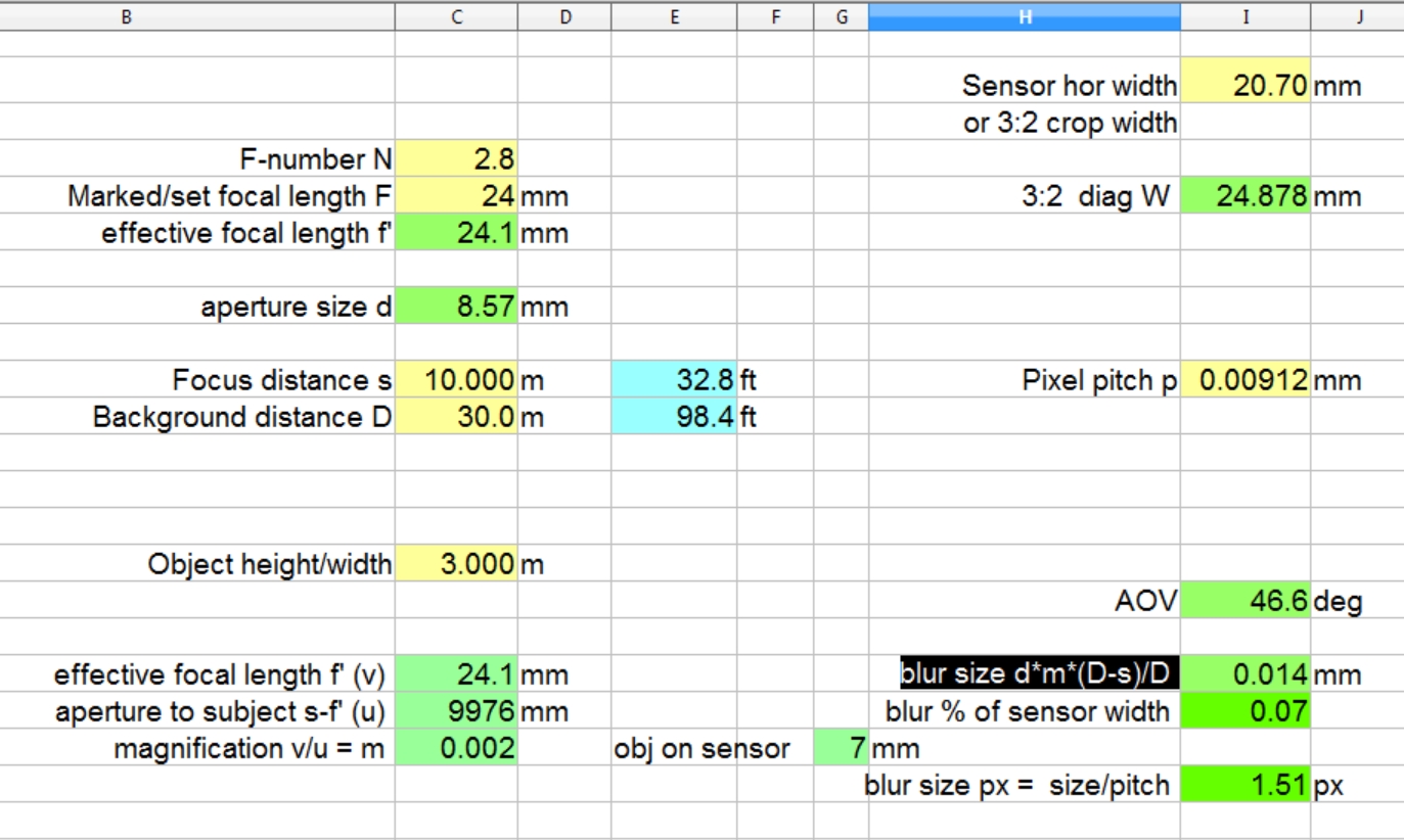

    A while back, I made an Open Office spreadsheet for blur size at the sensor ...
    Lots of blur references here:
    www.trenholm.org/hmmerk/TIAOOFe.pdf
    JPG, 327.9 KB, uploaded by xpatUSA on May 24, 2023.

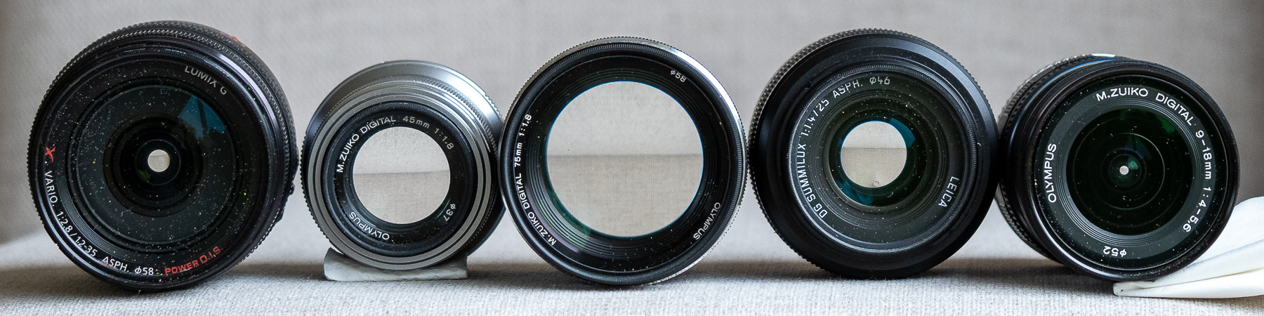

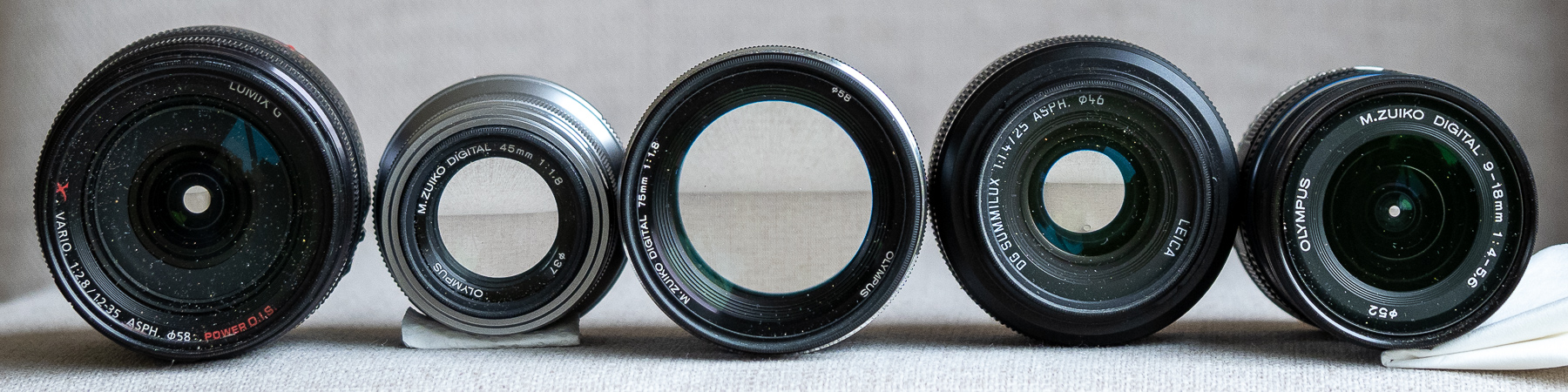

    The size and shape of the bokeh balls you see in the image are determined by the size and shape of the entrance pupil of the lens.
    Take the lens off the camera and look into the front of the lens with a brightly lit wall some distance behind the lens. The hole that you see inside the lens is the entrance pupil.
    By putting a cut-out in front of the lens, you are trying to change the shape of the entrance pupil. You cannot make it bigger, you can only make it smaller. So, the cut-out must be smaller than the entrance pupil to have any effect.
    The diameter of the entrance pupil is equal to the focal length divided by f-number. Your 150mm f/2.8 lens has an entrance pupil of 150/2.8 = 54mm, while your 50mm f/2.8 lens has an entrance pupil of 50/2.8 = 18mm.
    Put your cut-out on the front of the lens and look into the front of your lens + cut-out to see the new entrance pupil. In general, the shape of the entrance pupil depends on the position you view it from, both the distance away from the lens and the angle.
    JPG, 541.0 KB, uploaded by TomAxford on May 26, 2023.
