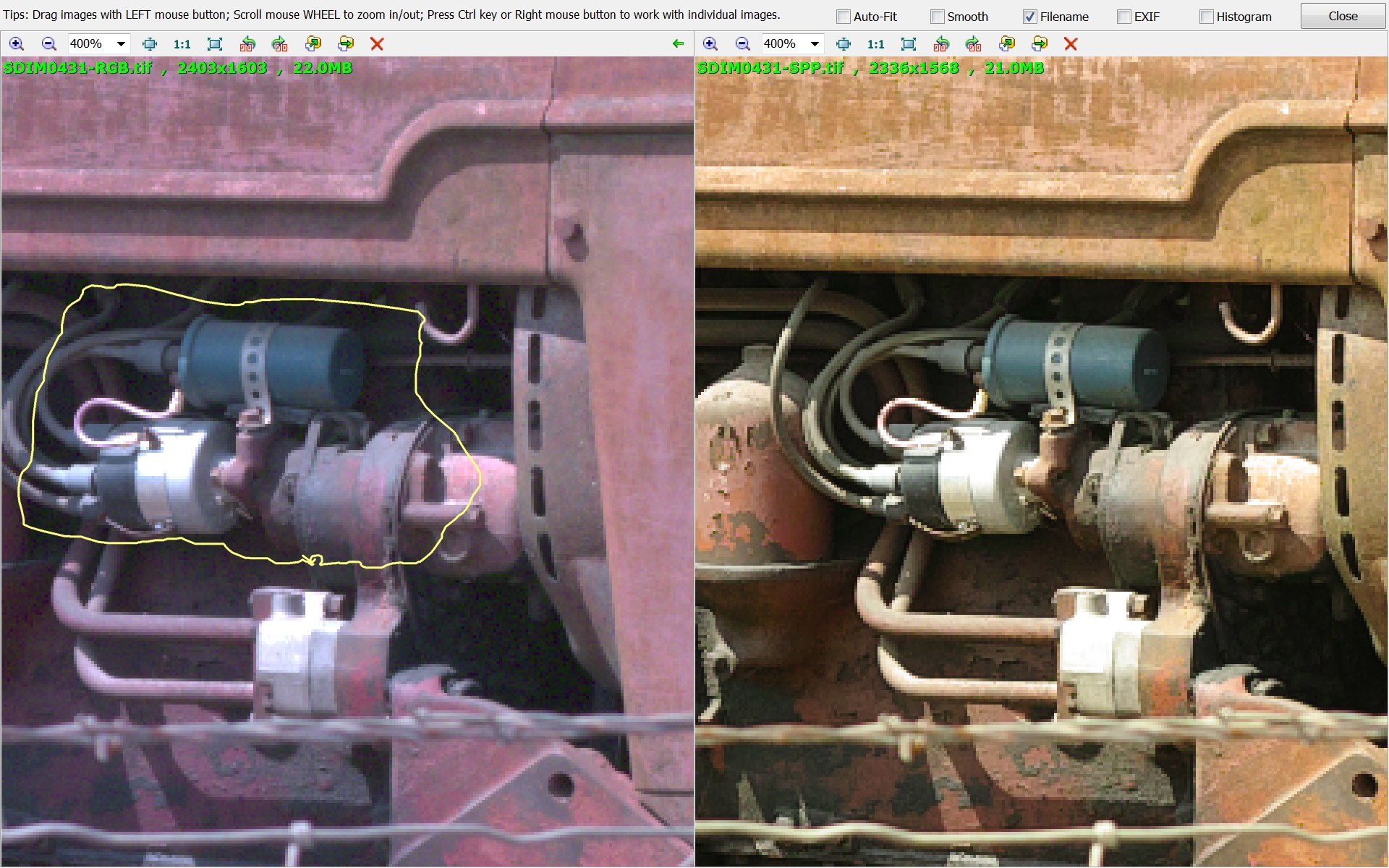

    Terminology can be confusing. Rather than "creating", how about 'capturing' a raw and how about 'converting a raw to a JPEG'.
    Indeed, it might better to consider the act of converting a raw to RGB, i.e. JPEG, GIF, PNG, TIFF, etc., etc.
    Here's the same raw file converted to RGB TIFFs (not JPEGs) by two different converters, please observe the difference in color rendition - extreme in this case but as-converted with no adjustment - LibRaw at left, Sigma Photo Pro at right:

    As we know, Foveon-based Sigma cameras do not have a CFA on the sensor. I have owned many different Sigma cameras and studied then in great depth. Each model embeds a color conversion 3x3 matrix in the raw file meta-data which the converter uses to transform the raw data to RGB. Thing is that Foveon sensors do not vary much in raw values versus incident wavelength - but the conversion matrix for every model is significantly different!
