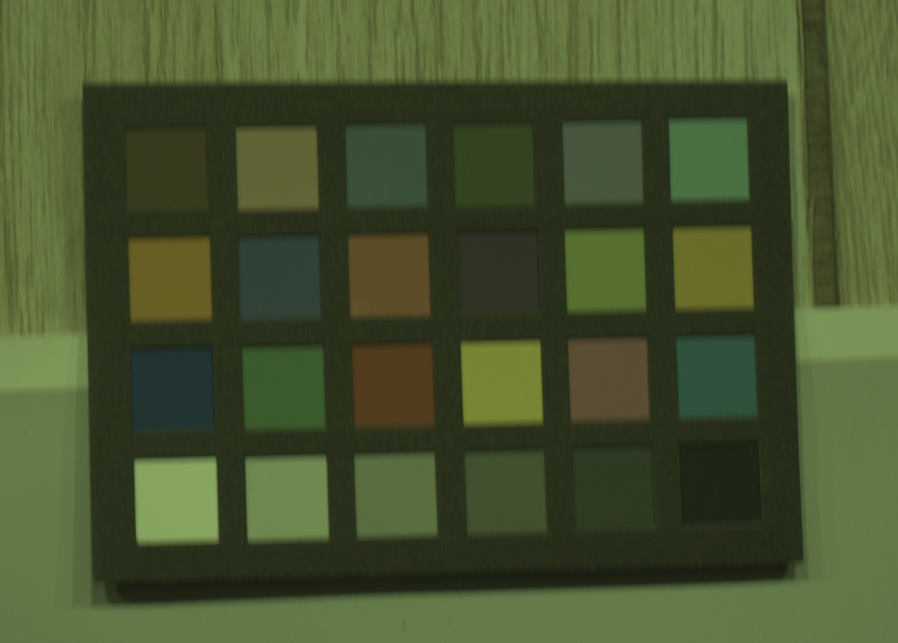

    March 20, 2024, 12:39 a.m.
    Are you sure?
    This is a raw composite (no conversion) image exported from a Lumix G9 raw file:
    Perhaps we are talking at cross-purposes. It is obvious that without a CFA over the photocells the sensor outputs would have no color ... but the raw file does include the effect of the CFA as can be seen above.
    JPG, 437.9 KB, uploaded by xpatUSA on March 20, 2024.

    But what you posted was a jpg, so, naturally, it has color. But, assuming we could view a RAW file, wouldn't it be a bunch of pixels that are all entirely red, green, or blue? And wouldn't the hue of the red, green, and blue necessarily correlate to the dyes in the CFA?

    thats not true 🤪 the voltages are measured from the coloured filter/diode. and i beleive every sensor maker has there own colour mixtures.

    Agreed. Raw is just numbers. How these are turned into colour is what is being discussed. There is the manufacturer's interpretation and then there is any interpretation you care to apply to that RAW data.
    Interestingly, when people do blind tests to decide what camera/processor did what image, the variation is huge. By and large, people are very poor at knowing which result came from which camera. Colour interpretation/rendition is a very subjective thing.

    There's no actual interpretation of anything regarding color with the raw pixel values. A "color" raw image is actually a set of interleaved B&W images (stacked, for Foveon) shot through different color filters, and the raw data, as cooked or mangled as it sometimes is, has no color interpretation in it; that only happens when you convert it.
