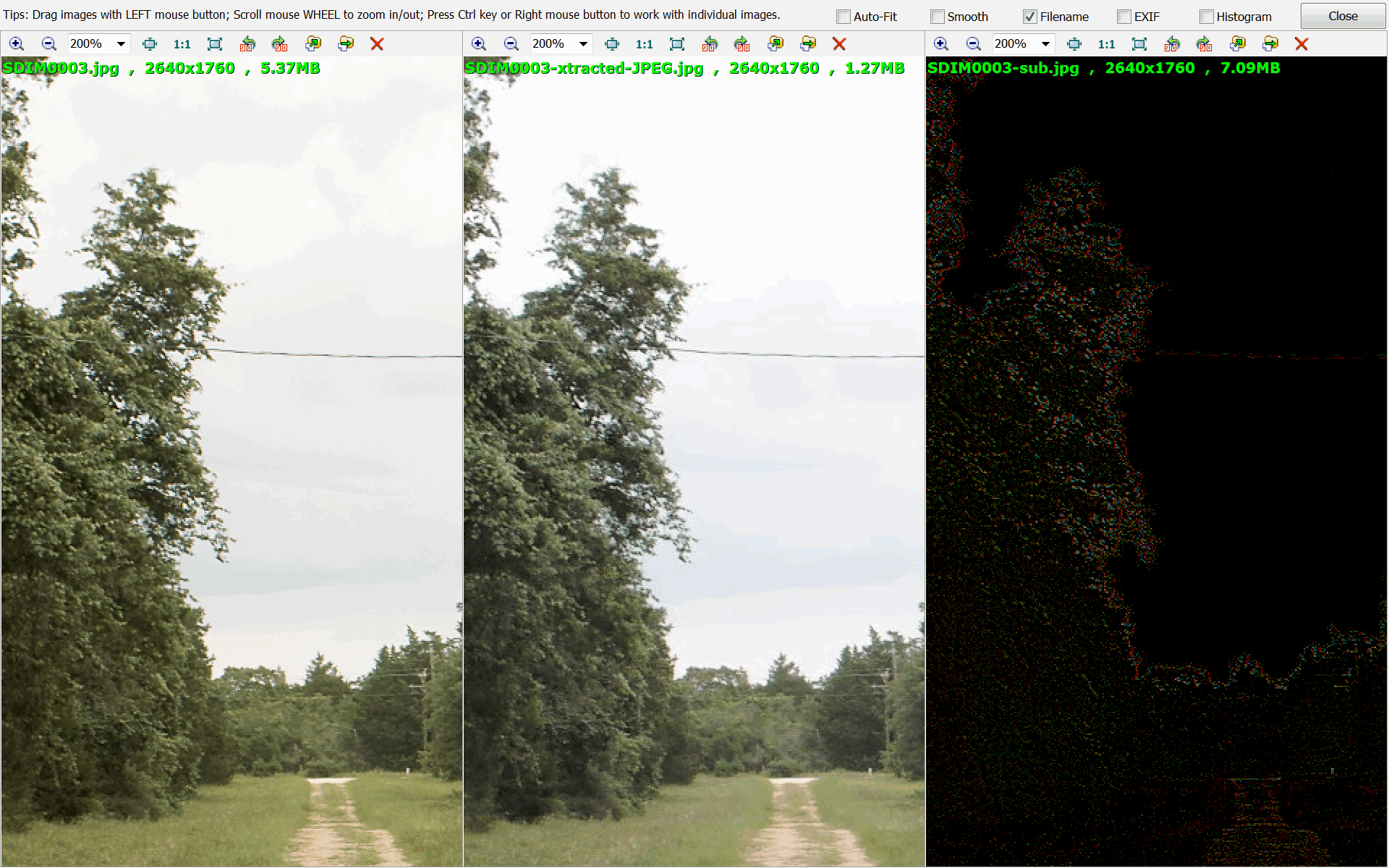

    Here's a Sigma best X3F raw conversion 4:4:4 vs. extracted from X3F 4:2:2 vs. subtraction:
    Best viewed large size. Obvious difference in luminosity. Noticeable difference in overall color. Big difference in edge detail.
    Comments invited.

    I showed a third image which is the result of mathematically subtracting the one image (converted) from the other (extracted}.
    When John said he did not subtract, he also meant to subtract mathematically. That is to create a new image by subtracting each pixel value in one image from the same location pixel value in another image. That is to say that, if the pixel at x,y 100,200 = 50,60,80 in one image and 45,50,65 in the other, then the result of the subtraction is 5,10,15 ... a much darker image and indeed a black image** would mean no difference at all between the two compared images.
    ** if a result has a negative value, that value is set to zero, in which case black may not mean "no difference".
    Not sure that question is relevant while we are talking about comparing two images by subtracting the one from the other.

    I thought you showed the difference between two images, converted with different lightnesses (which dilutes the actual differences in quality by putting a faint full image in the result).
    What I would be talking about is the difference between two OOC JPEGs, one explicit and one embedded, from the same capture. I don't remember having done that. I very well may have at one time and forgotten, but I have found Canon's embedded JPEGs to be good enough as far as JPEGs go, especially if you already have a raw image to work with if you want something different or better.

    Same capture but one JPEG was extracted from the raw file and the other JPEG was created by the raw converter on my computer.
    Ah, also from the same capture but both created in-camera, i.e. a raw+JPEG shot - assuming that "explicit" means from the in-camera converter.
    My example was not so, because that camera can't save raw+JPEG. Therefore my example would indeed show differences resulting from the difference between the in-camera JPEG engine and my computer's conversion software.
    Understood.

    What xpatUSA did was exactly comparing the difference between two OOC Jpegs of his Sigma camera. He extracted the embedded jpeg and subtracted it from the explicit jpeg ( or other way round, I don't know). As you can see at his example there is difference between those.

    No, sorry: one JPEG image was extracted from the OOC raw file and the other JPEG image was exported from the Sigma Photo Pro software on my computer therefore not OOC
