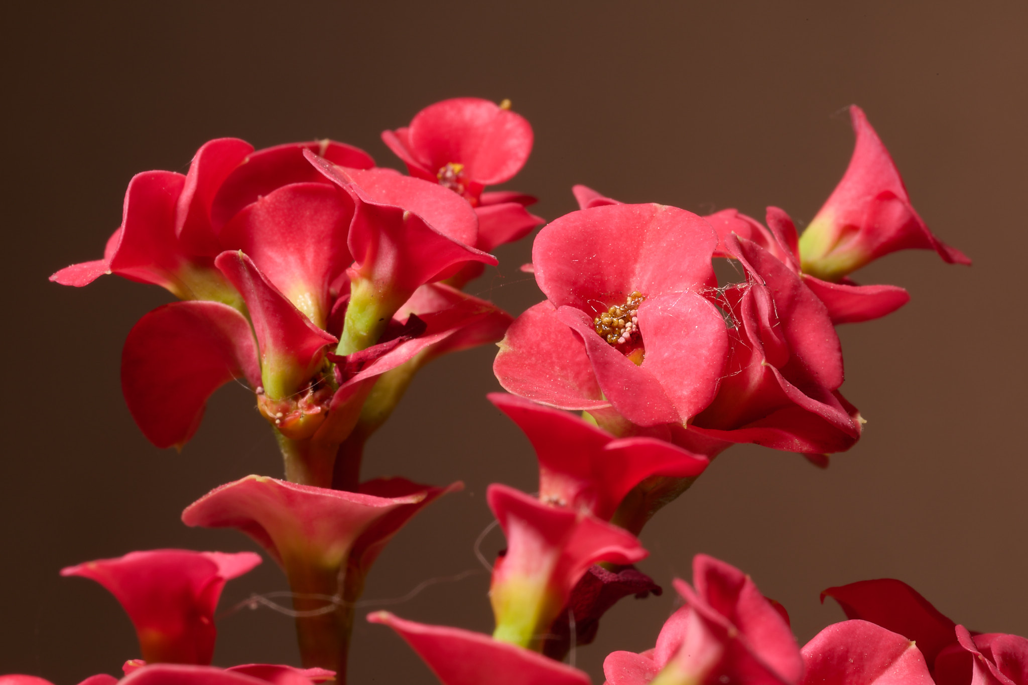

    I am experimenting with Macro at the moment. I have been experimenting with flash, and to get a reasonable DoF, I stopped down to F45.
    The Raw was soft, but the Diffraction Correction , Capture One, seems to clean up the softness.
    Any opinions.
    JPG, 312.4 KB, uploaded by NCV on June 4, 2025.
  • June 4, 2025, 8:16 p.m.
    Can you post original too?
    Theoretically you can use deconvolution to weaken diffraction effects (restore details), but this would be very error-prone (and heavily lens-dependent) way - or a very resource-hungry one (you can estimate best deconvolution parameters by trial and error and anlyzing results). Then people use different sharpening techniques, but those do not actually recreate details, only make image sharper. What C1 does internally, I have no idea - most likely some combinations of different methods.

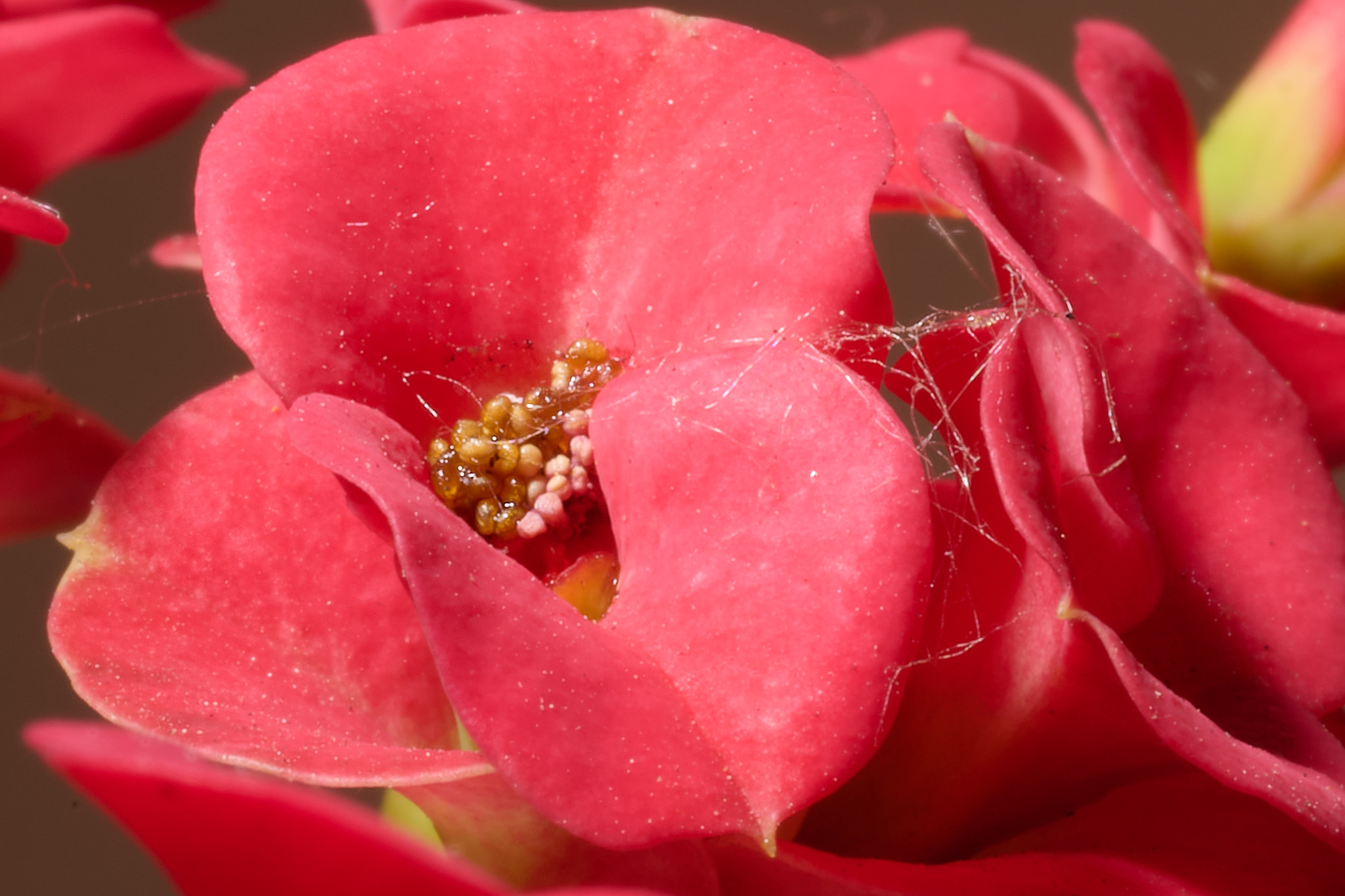

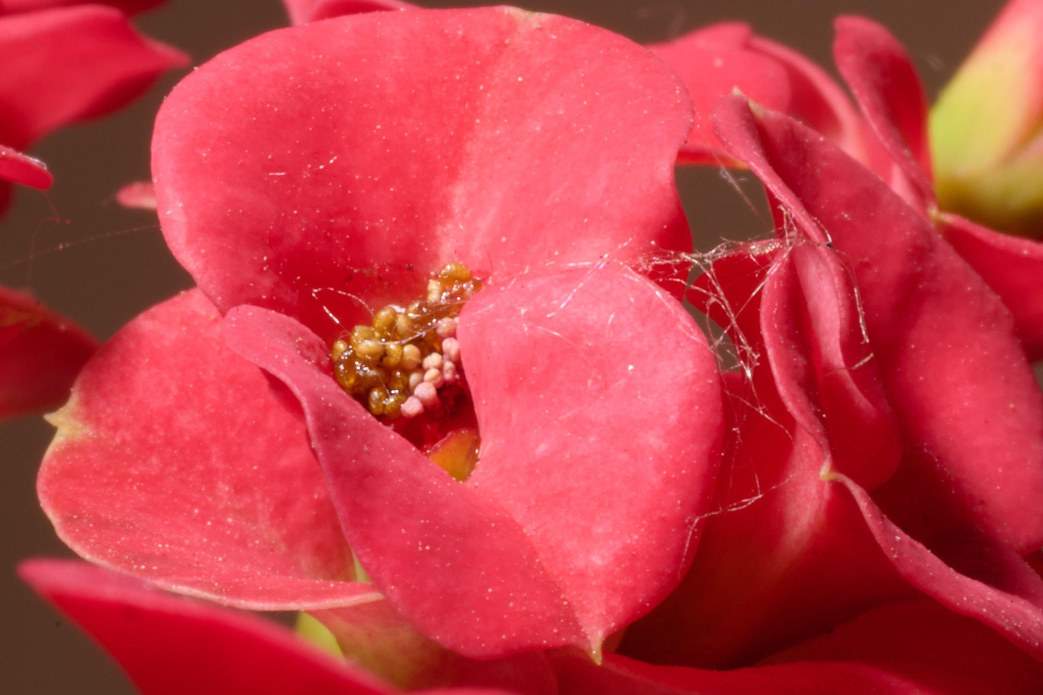

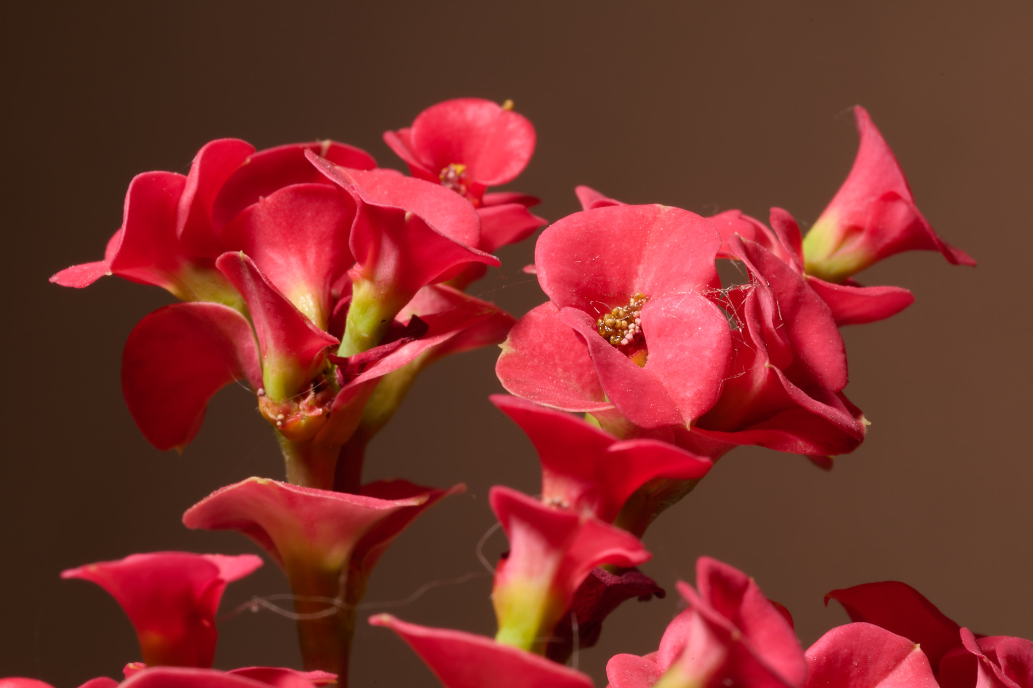

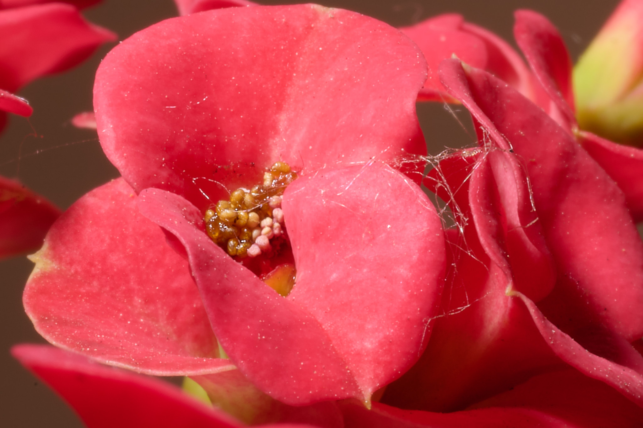

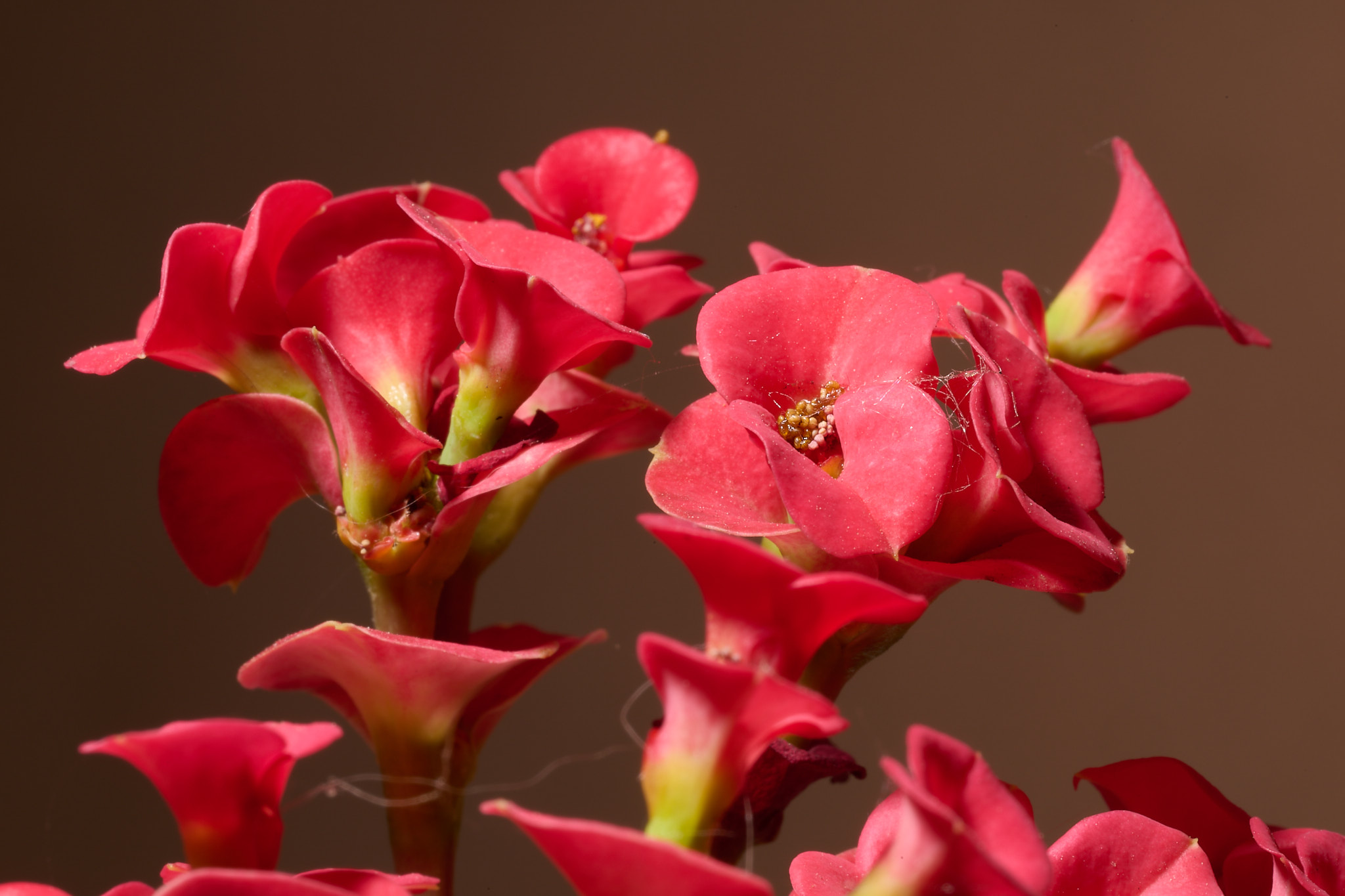

    Here is the original
    Enlarged
    Original
    Corrected

  • June 4, 2025, 8:42 p.m.
    This looks pretty much like sharpening - well, I don't have any comparative results about what deconvolution can do, but here no details are restored, rather some details (thin and not contrasty lines) are removed, also many sharpening artefacts are visible (dark halos around bright spots).
    Nevertheless the result looks better than original :) Most likely focus stacking (using optimal aperture) could yield even better results - but would require much more time and preparation.
    About diffraction in my images - I don't care much. Usually I shoot using quite wide aperture; when I need 1/16 or similar (on APS-C), then I can get pretty good results with sharpening (using some DXO Photolab trickery - their noise removal + sharpening algorithms make wonders).
