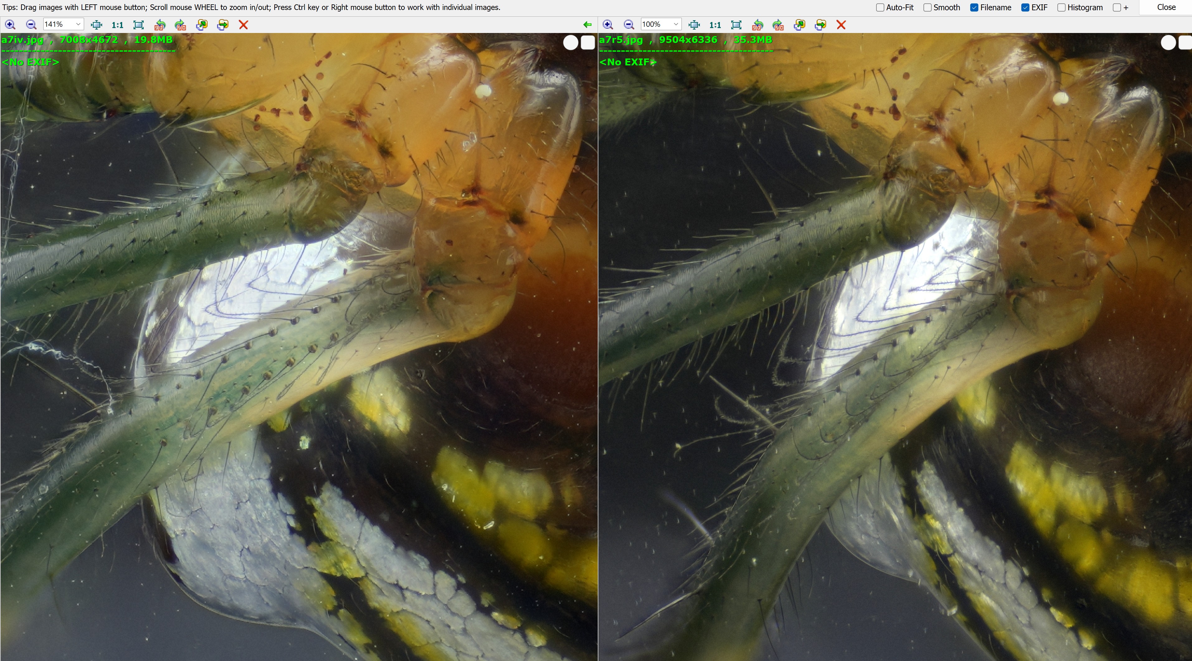

  • Members 2665 posts
    June 9, 2025, 11:29 p.m.
    I discovered the problem with the a7r5, it wasnt diffraction, it was slow sensor speed at 100ms using my extreme macro studio, the reason the a1mk2 was so sharp is the sensor speed is 8ms as im using electronic shutter with no black put viewing.
    June 11, 2025, 6:05 a.m.
    had me questioning as well. i knew my a6700 had some very minimal diffraction at 10x but couldnt figure out why the A1mk2 was so sharp even at 50 mpixels compared to the a7r5 at 60. i can also say that 8.5 stops of IBIS is total marketing crap, because it was no better than my 5.5 stop 7iv.

    Illusion, exacerbated by upsampling methods that create pixelation (Nearest Neighbor and variants/hybrids). Instead of looking at how "sharp" details are on an insect, try both sensors with the same lens on text of variable size, like a document that scales font size by 0.8x with each subsequent line of text, printed and photographed from a distance. I don't even need to do this to know the outcome - there 60MP will record more lines, legibly, while the 33MP will give sharper results that are illegible gobbly-gook.
    June 24, 2025, 9:48 p.m.
    not into black and white writing as accurate testing.

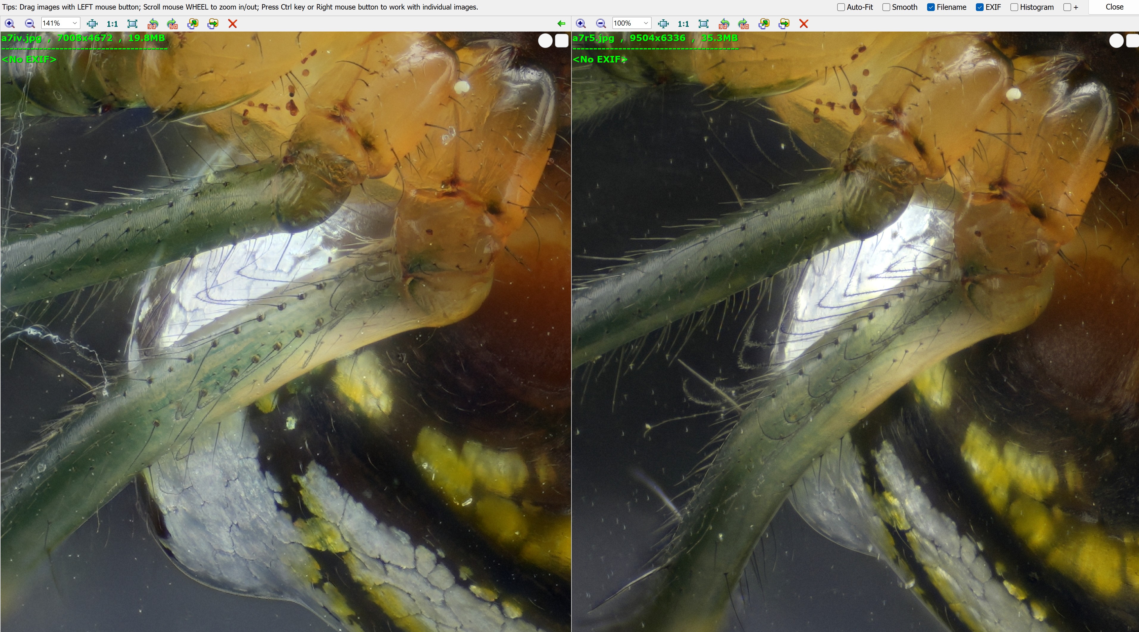

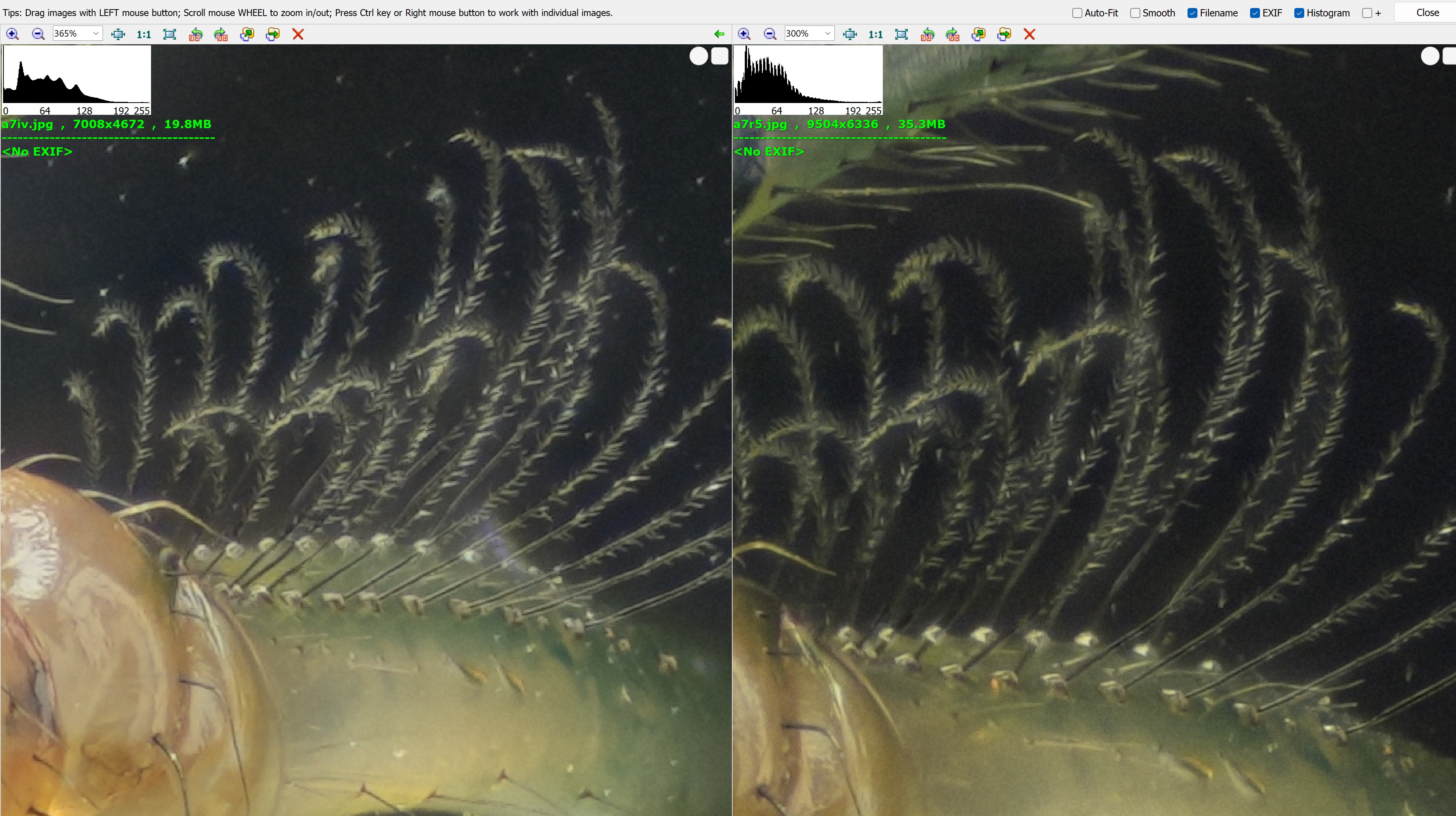

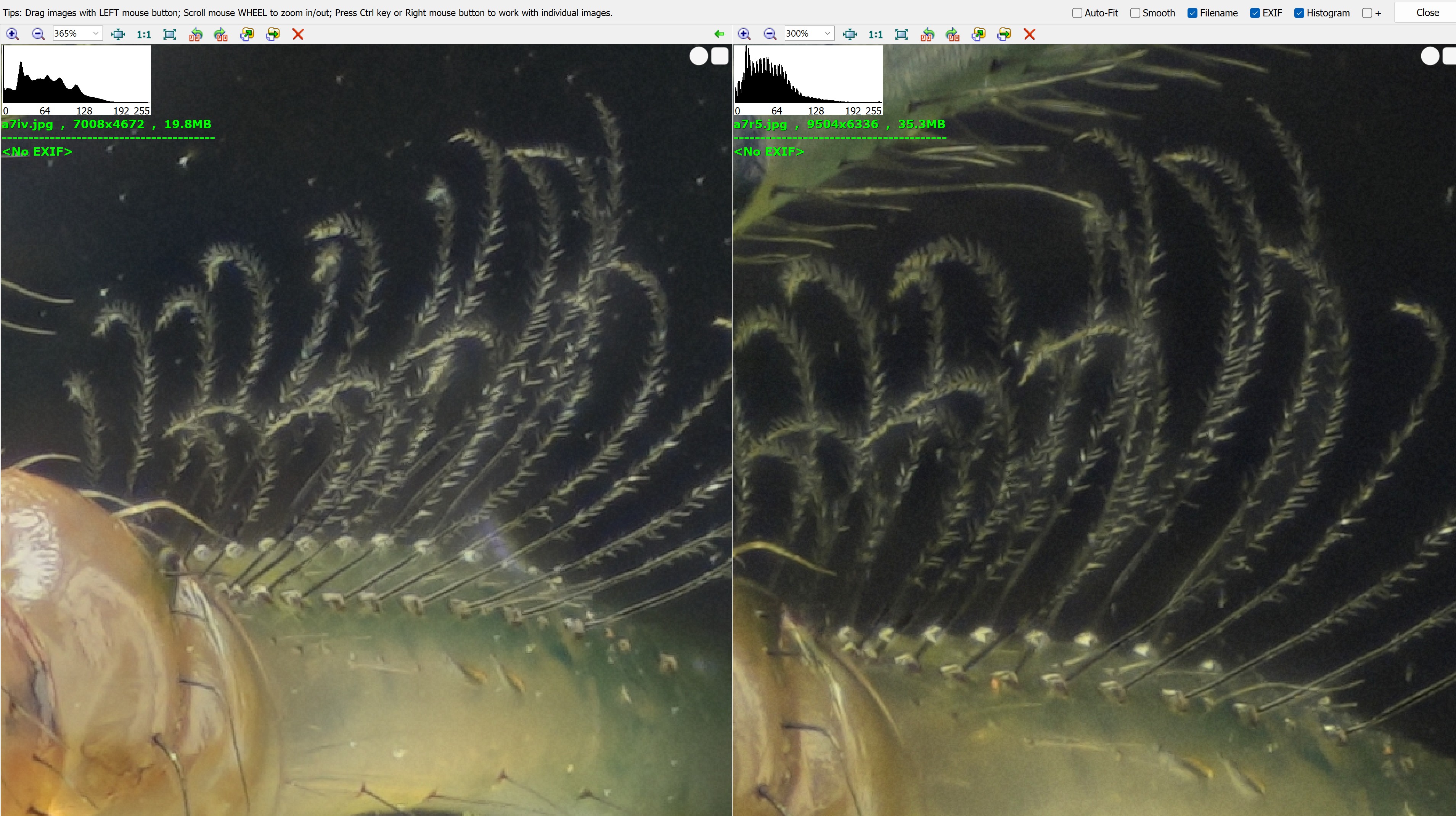

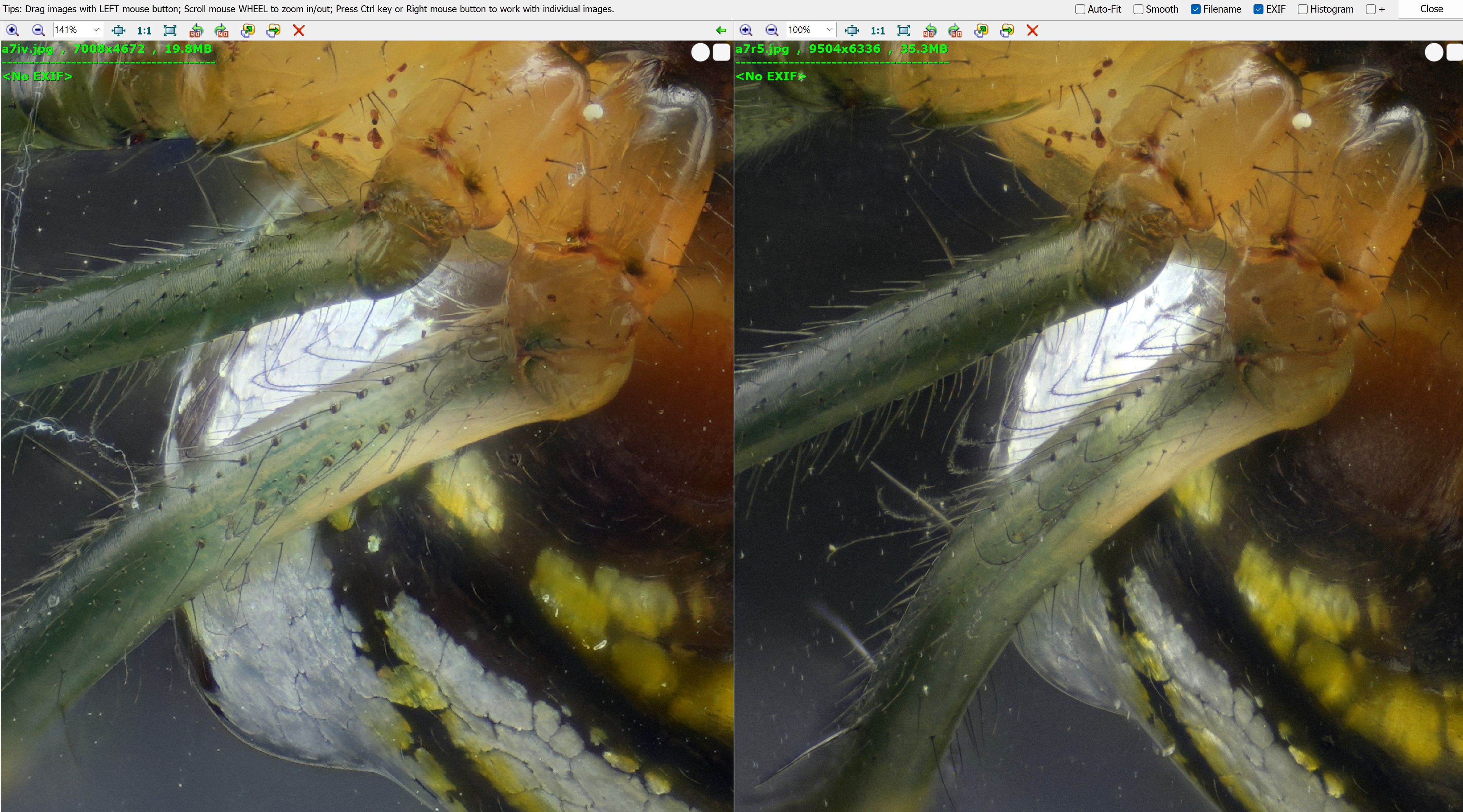

    JPG, 1.4 MB, uploaded by DonaldB on June 24, 2025.
    JPG, 1.2 MB, uploaded by DonaldB on June 24, 2025.

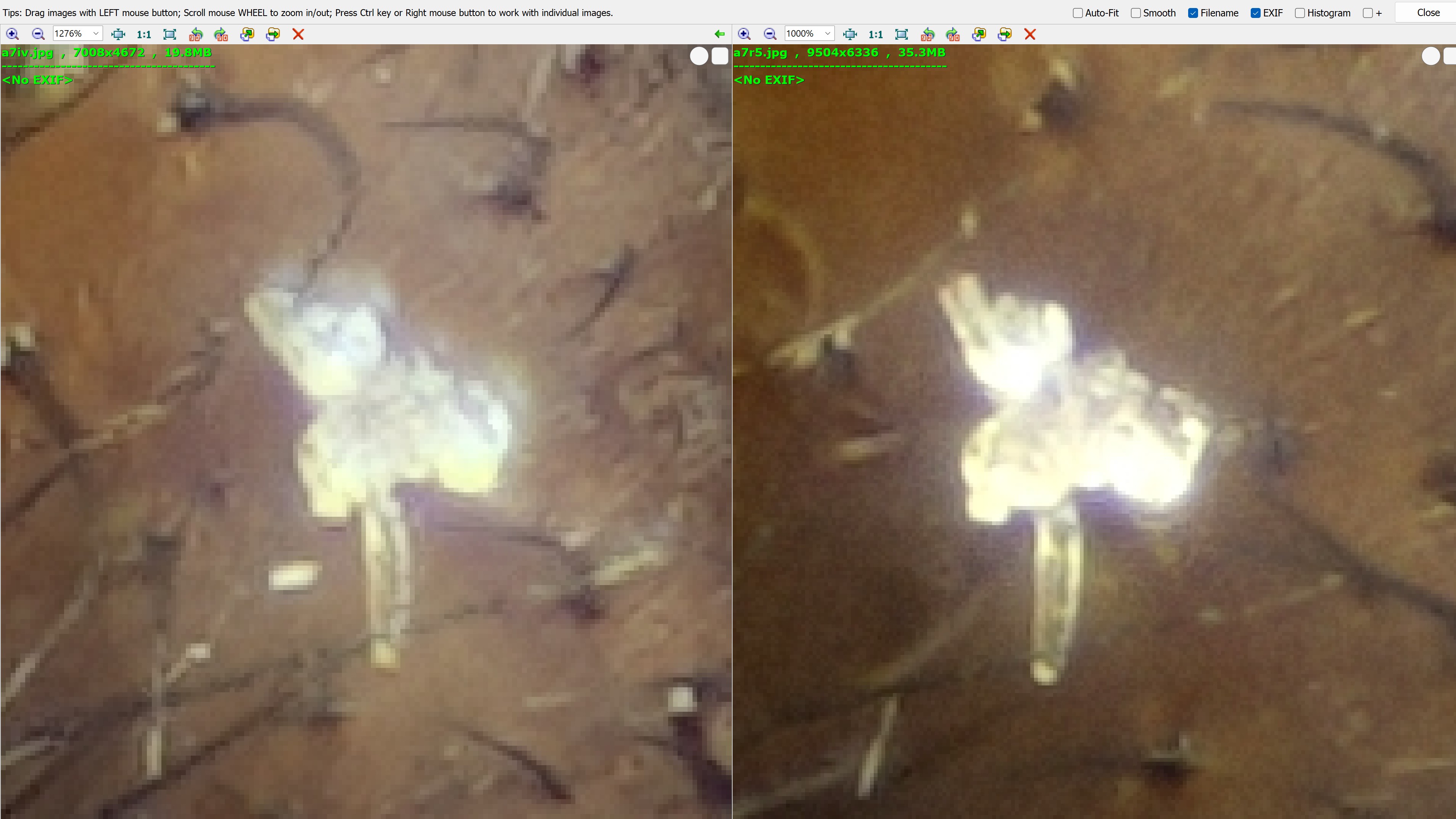

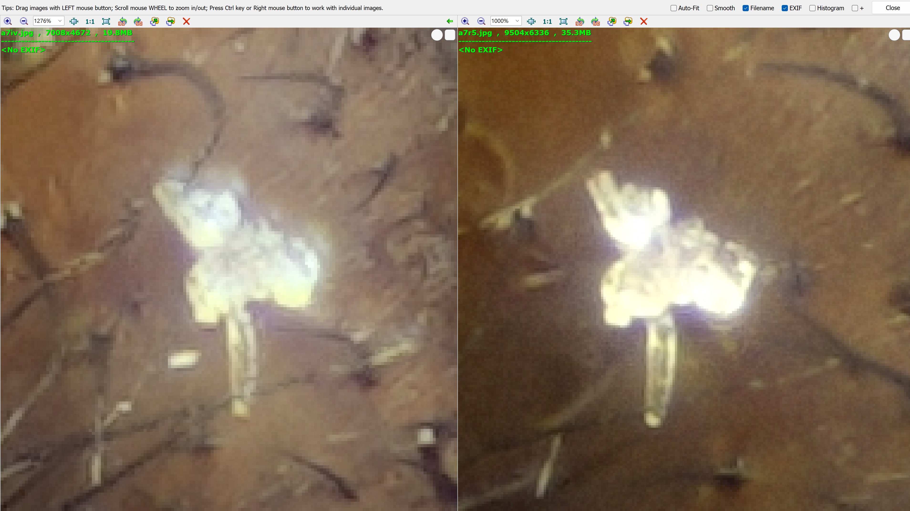

    June 26, 2025, 4:10 a.m.
    60 meg greater cropability right 🤔🫣
    JPG, 732.4 KB, uploaded by DonaldB on June 26, 2025.
