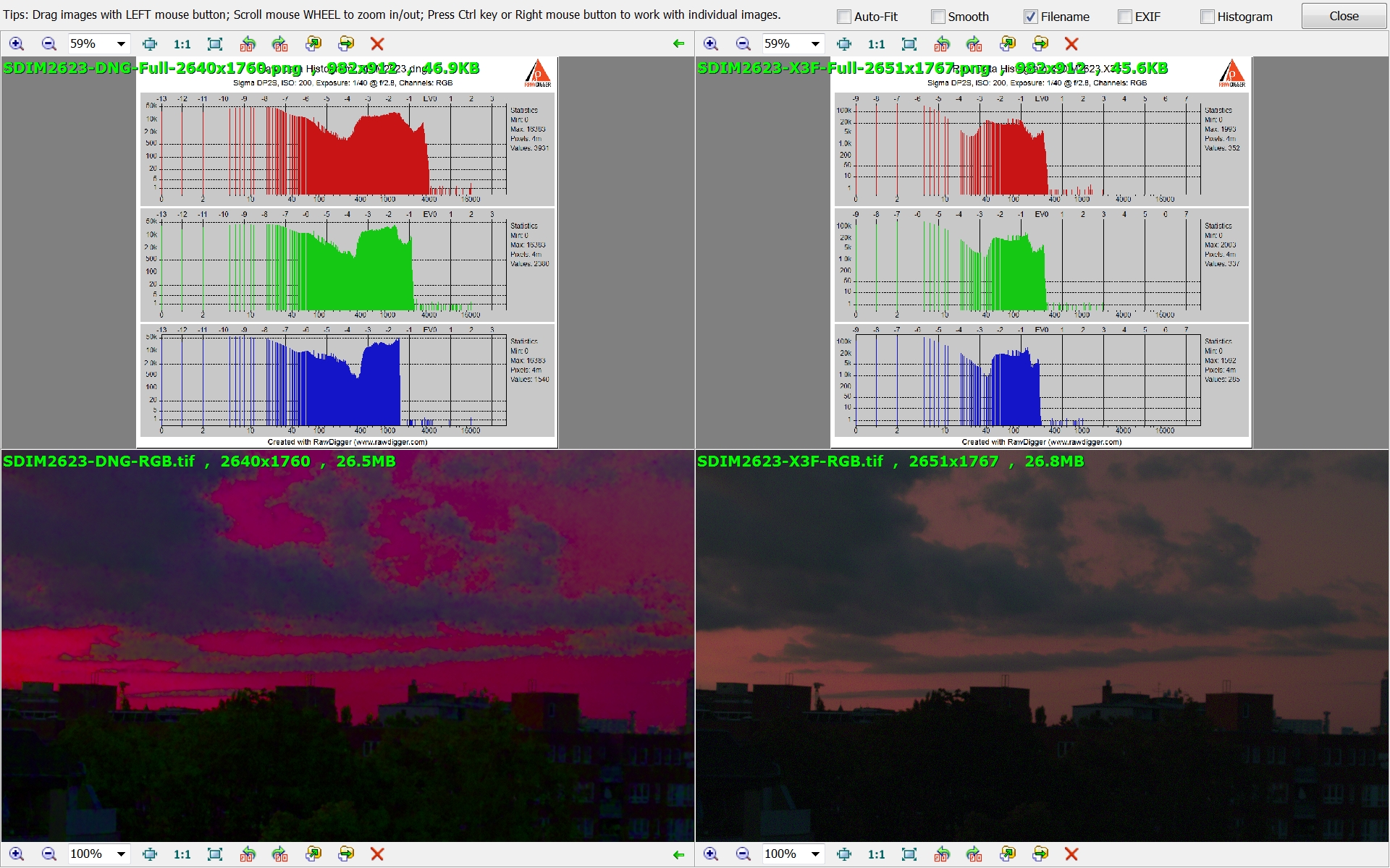

    I'm no fan of Adobe. However their effort to provide an alternative to proprietary raw converters was at first seemingly laudable.
    But then along came RawDigger which allows one to examine raw data. To one's surprise and in spite of early Adobe-speak, DNG "raw" is not the same as what a camera writes to the card.
    JPG, 1.2 MB, uploaded by xpatUSA on Feb. 12, 2024.

    RawDigger does not confirm your thought, unfortunately.
    A lot can happen between the ADC output and the writing to the card.
    Examples for 12-bit ADC (0-4095):
    Nikon D50: 683 loss-less compressed
    Sigma SD9: around 9000
    Sigma DP2: around 3000
    Sorry, not sure what that means in context.

    It doesn't matter if the digital receive system is for audio, RF, or two dimensional such as in a camera, there is a host of processing prior to the recording. There is the amplification, signal conditioning, potentially companding in RF or power law gamma compression in imaging designed in to insure the voltage presented to the ADC falls in the appropriate range to get maximal dynamic range by insuring the signal range falls into the input range of the ADC. The ADC then quantizes the input data and coverts to a PCM digital output. The PCM data recorded in the case of an image is the raw collect or raw image. However, the signal into the ADC has had both linear and nonlinear operations applied to the output voltage of the photodetectors.
    In RF systems, designers often use AGC ( automatic gain control ) to insure the output voltage falls in the input required by the ADC. In digital imagery, it is a function of the person behind the camera properly setting the ISO. The equivalent in digital imagery to an AGC is auto-ISO.
    Rawdigger simply pulls the PCM samples. There is a lot that happens from the time the photons hit the detectors and the bits PCM samples hit the card.

    Not on my camera. The Foveon channel output voltages are applied directly to the three ADC inputs..
