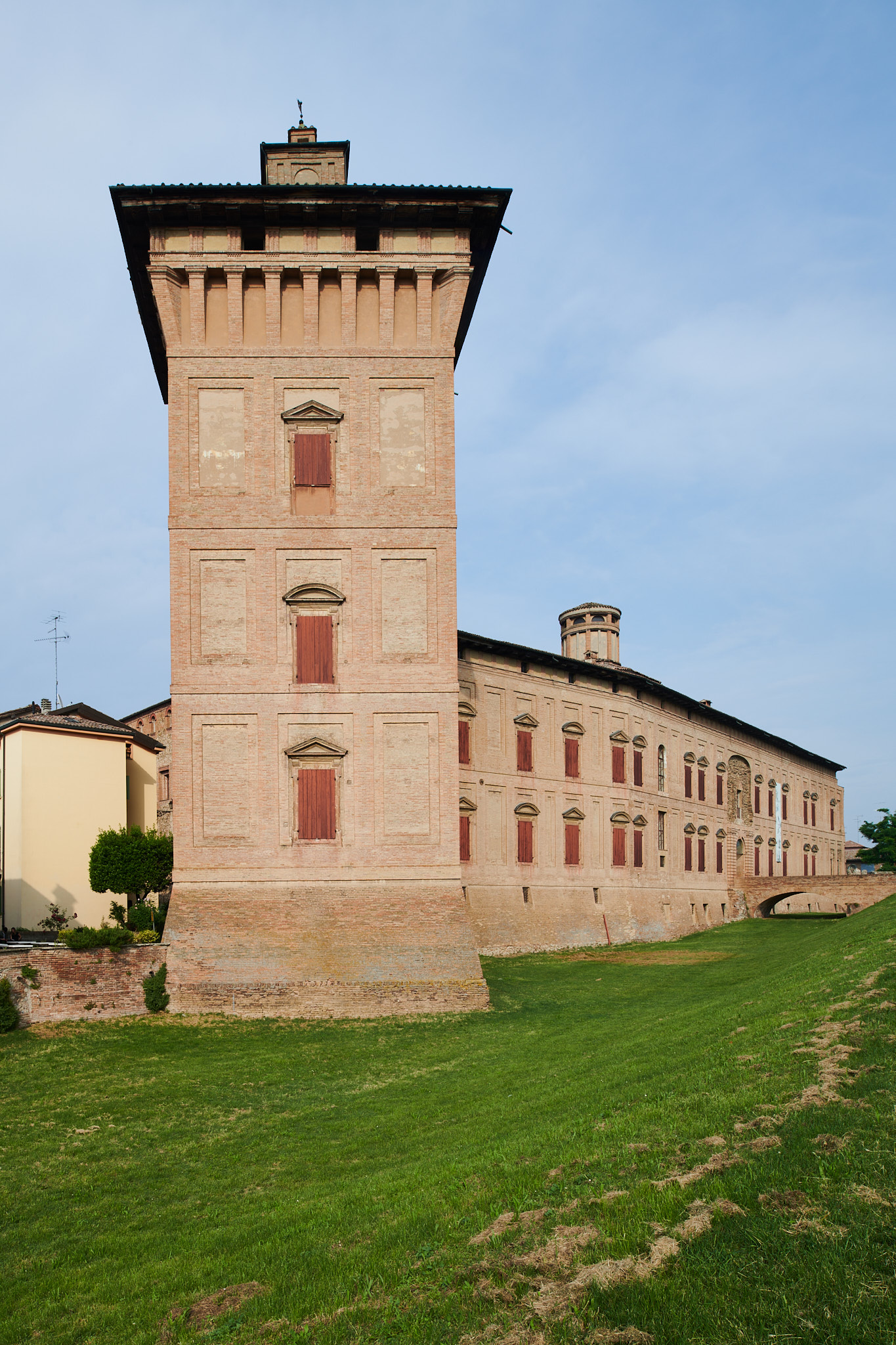

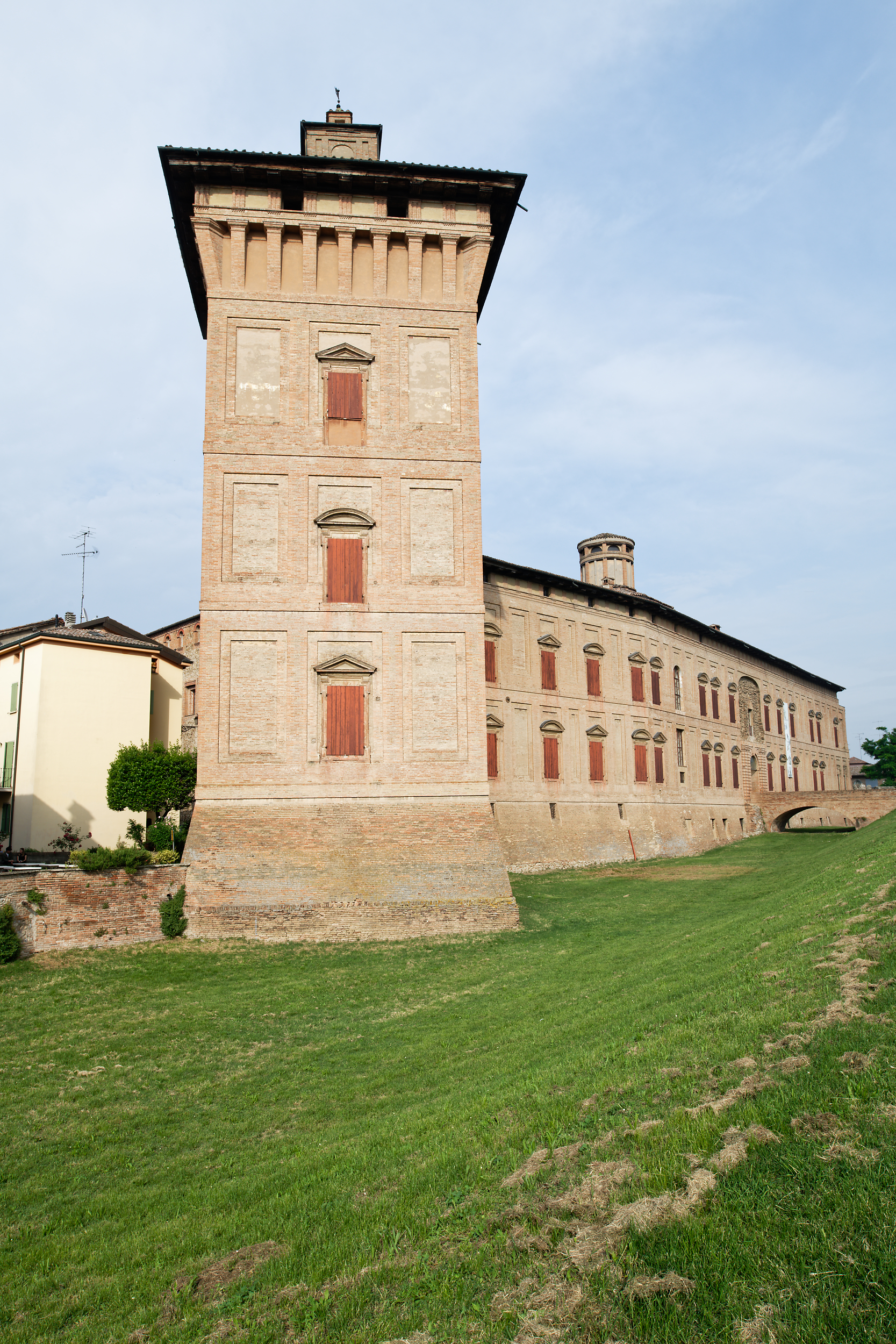

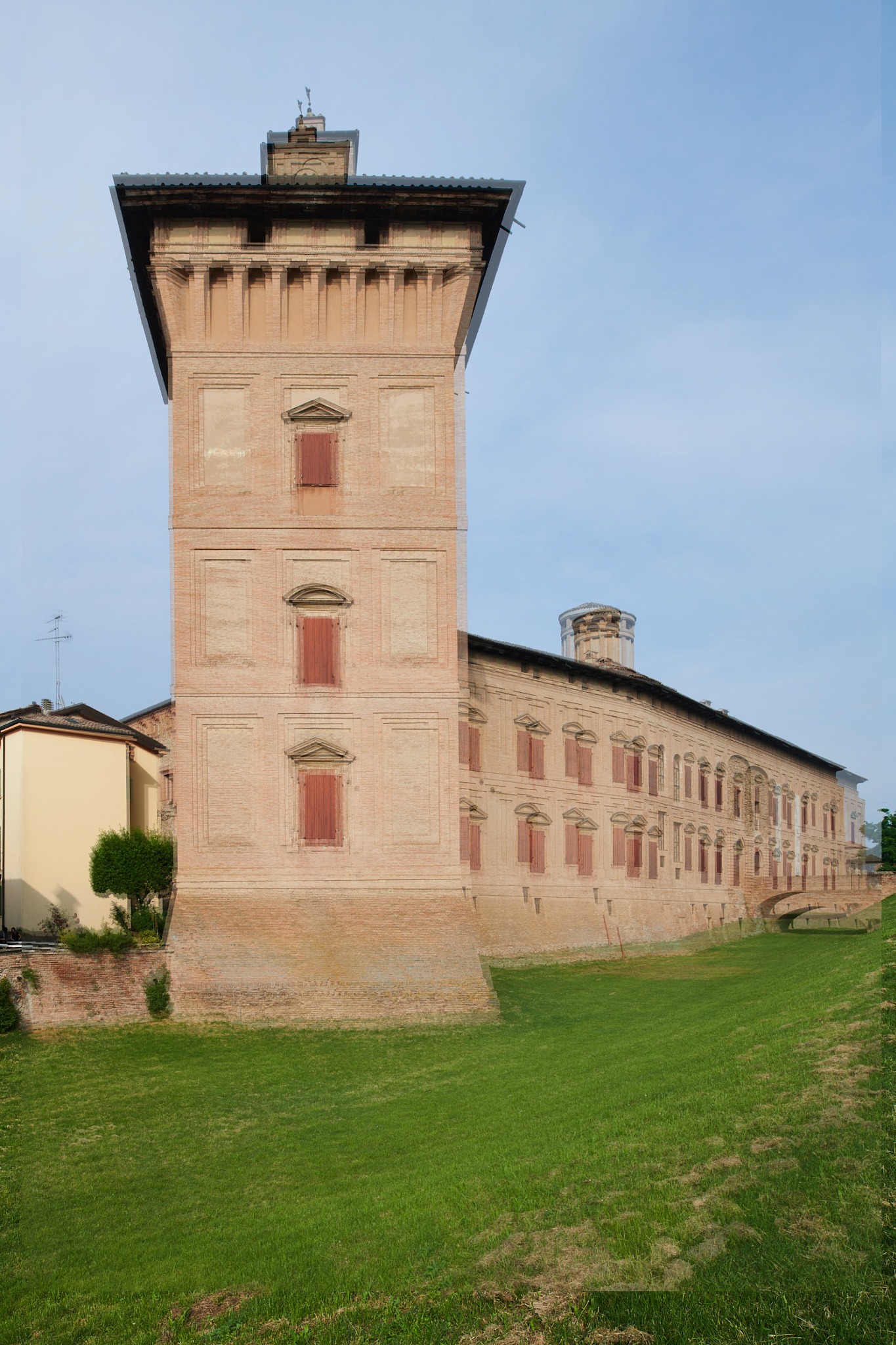

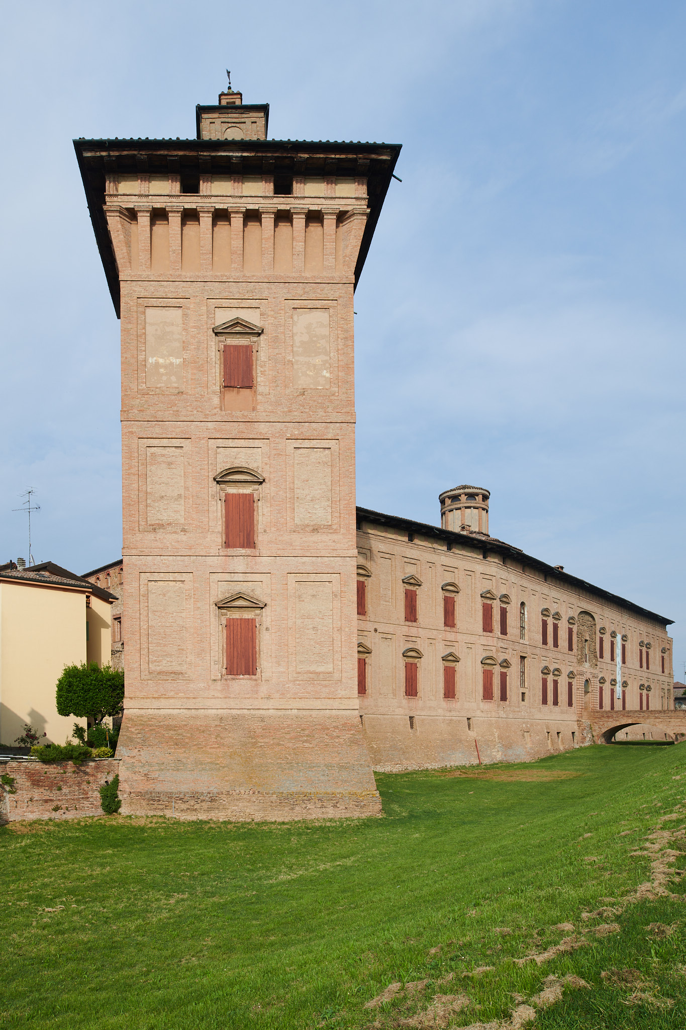

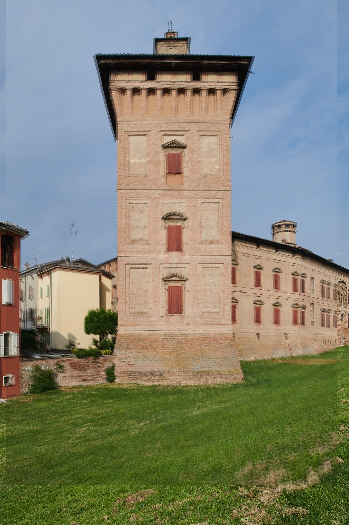

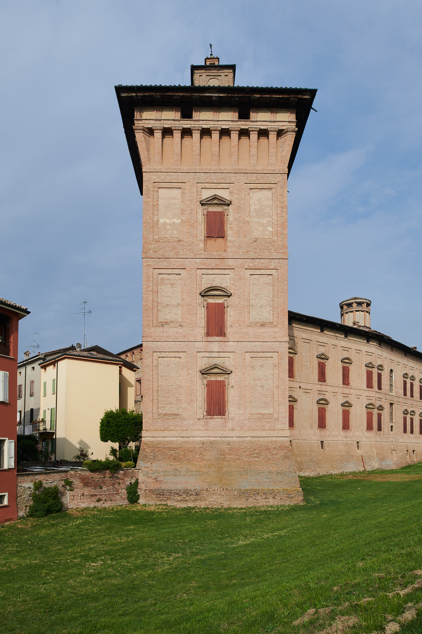

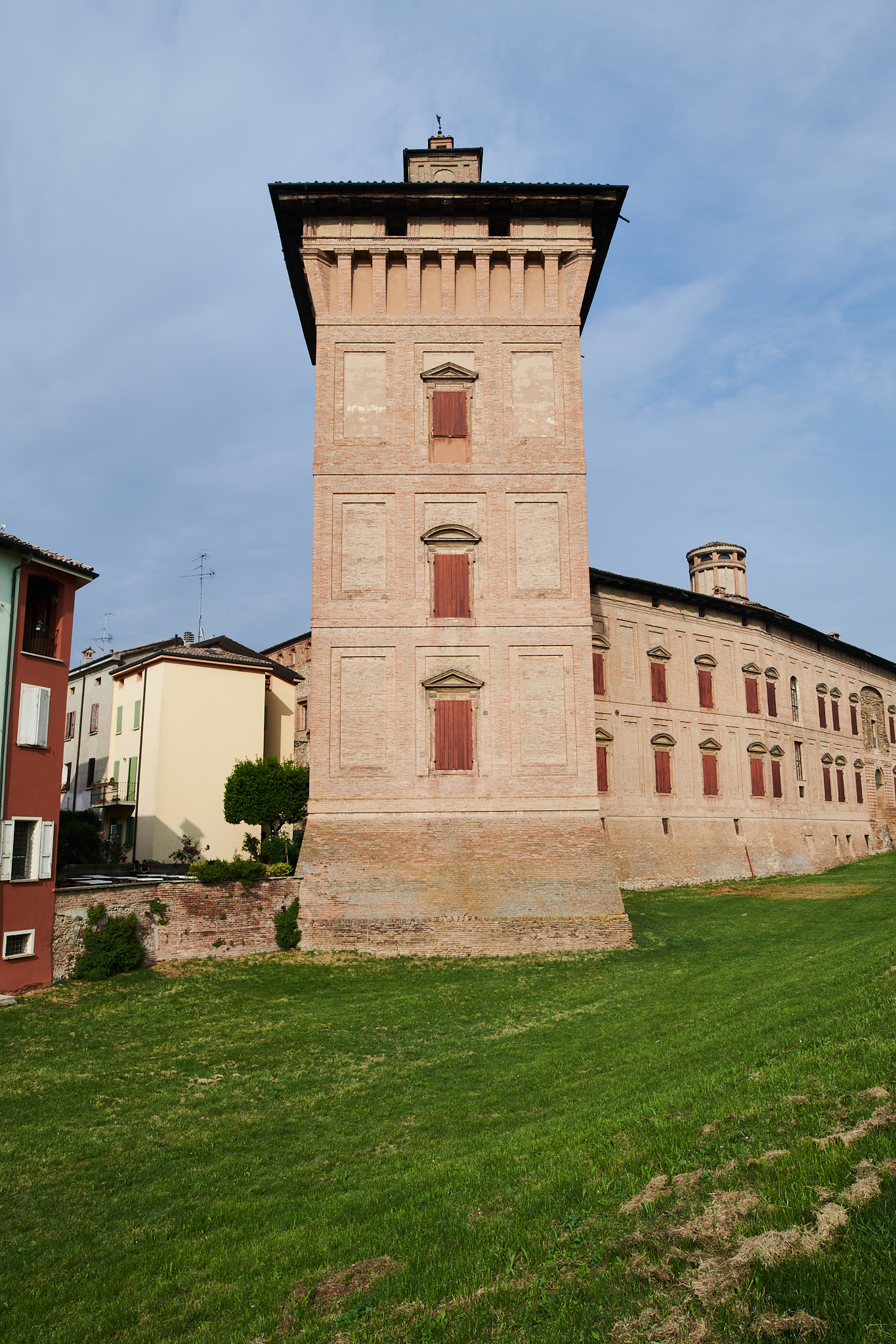

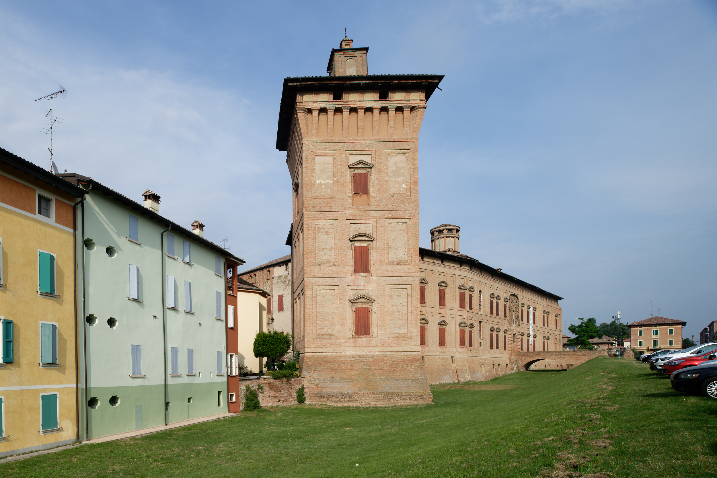

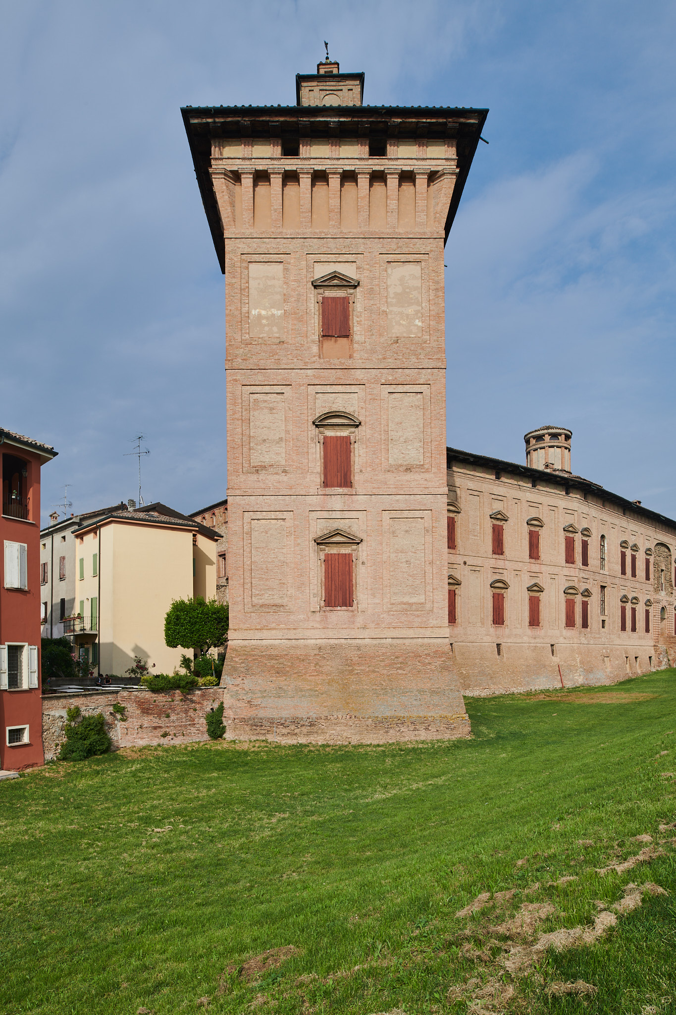

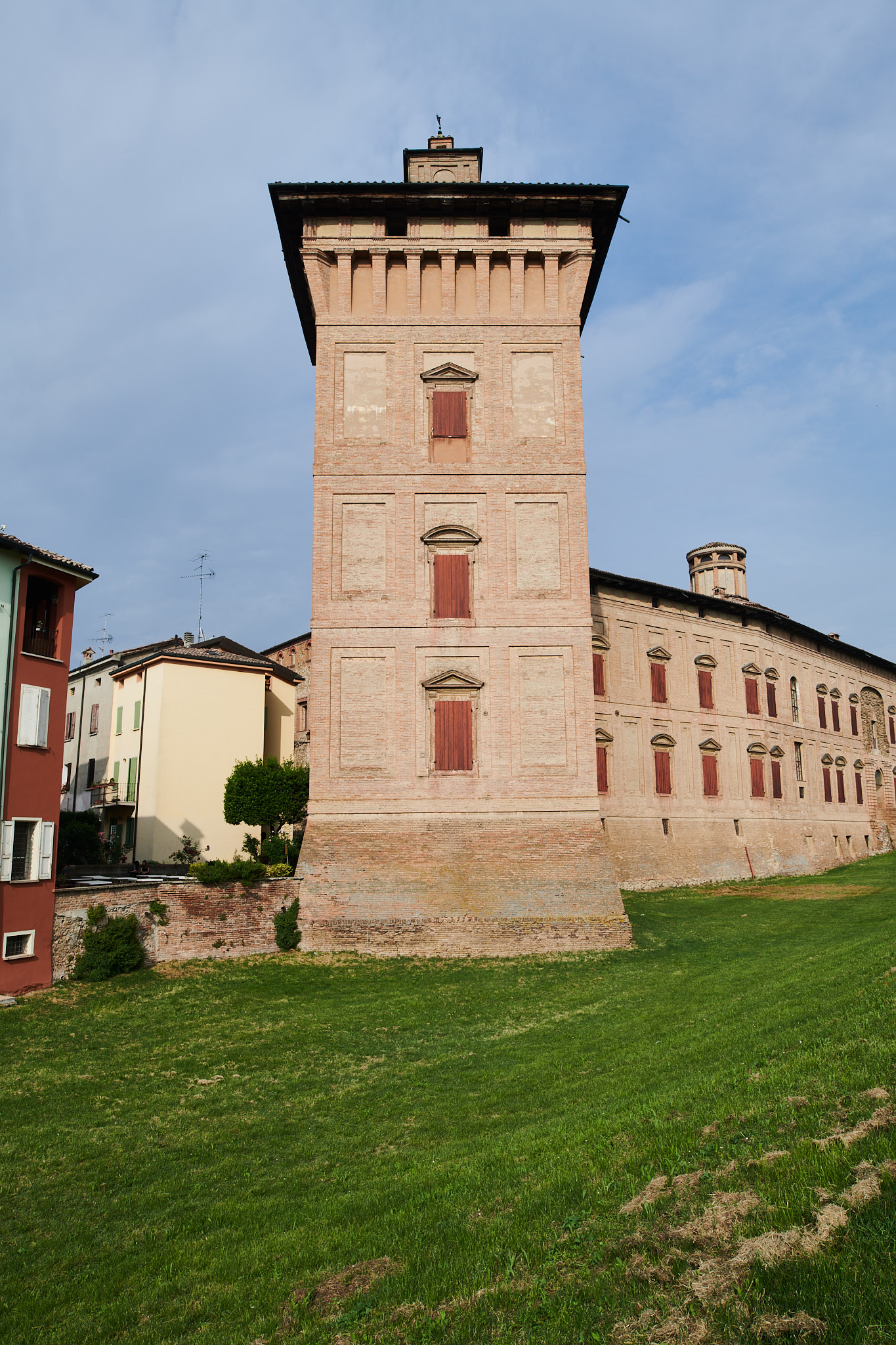

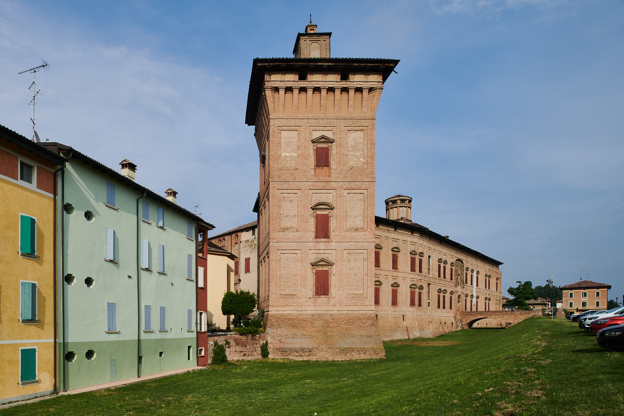

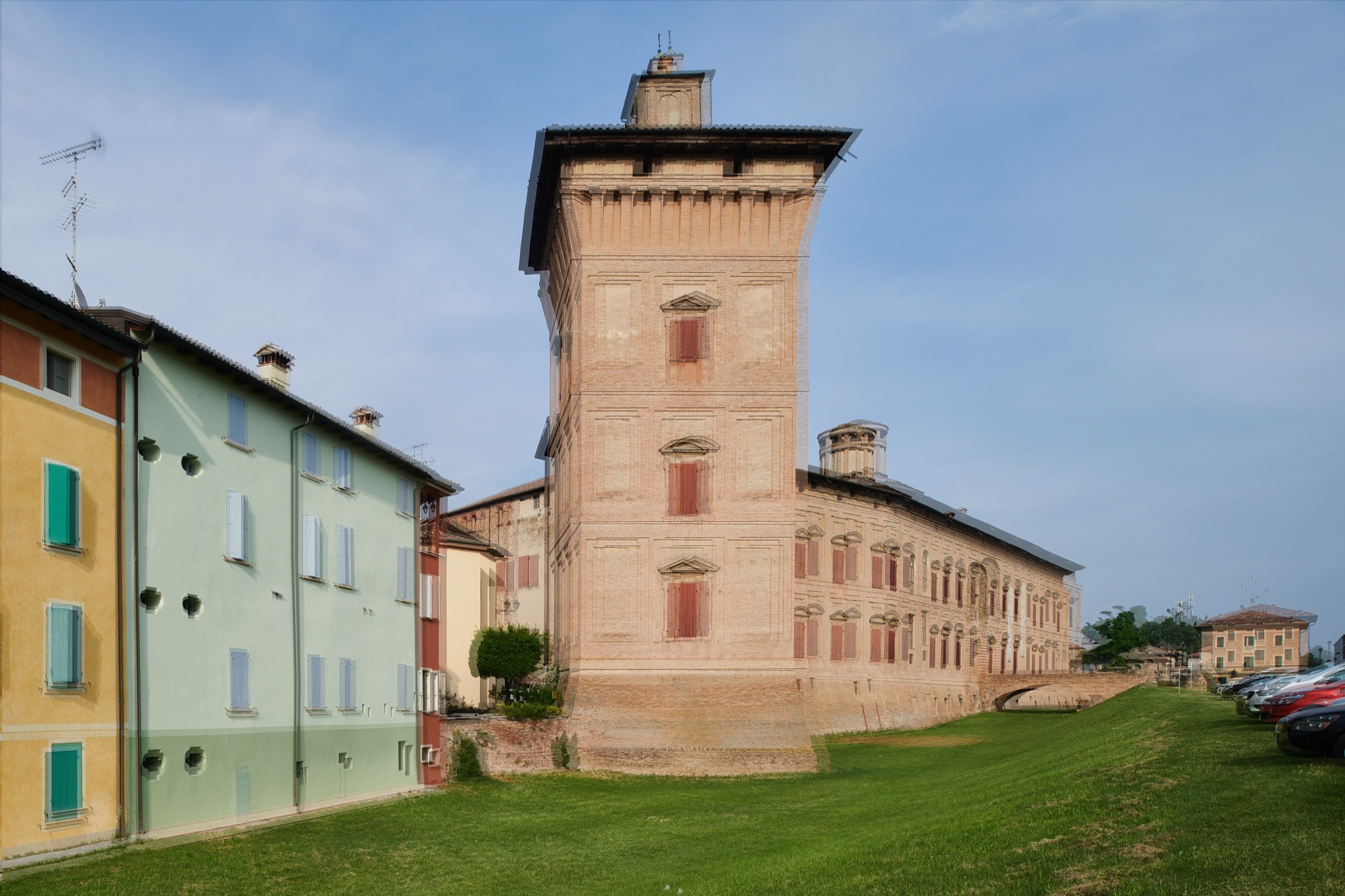

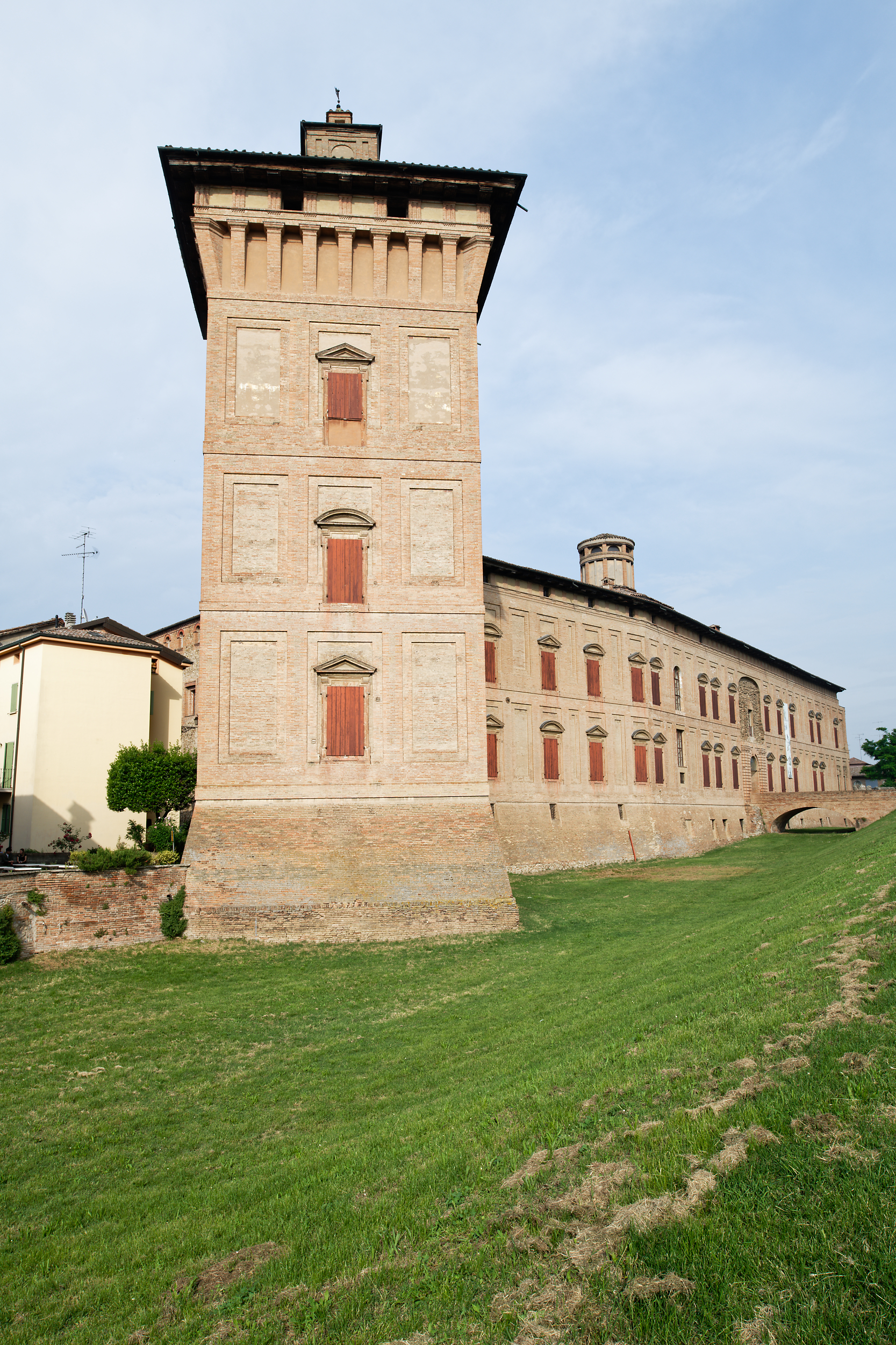

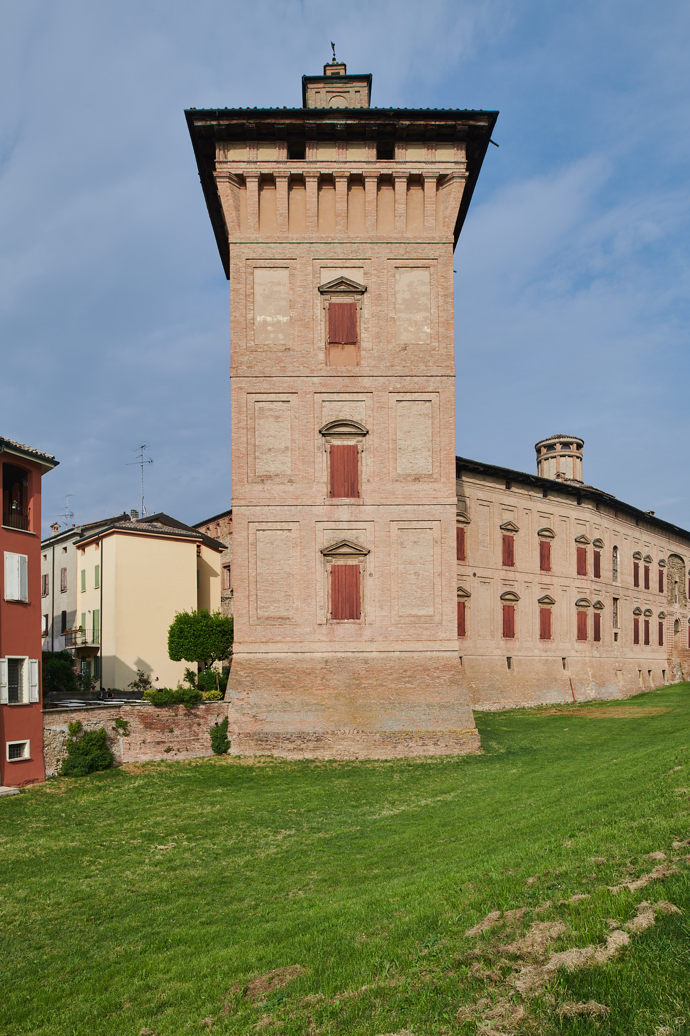

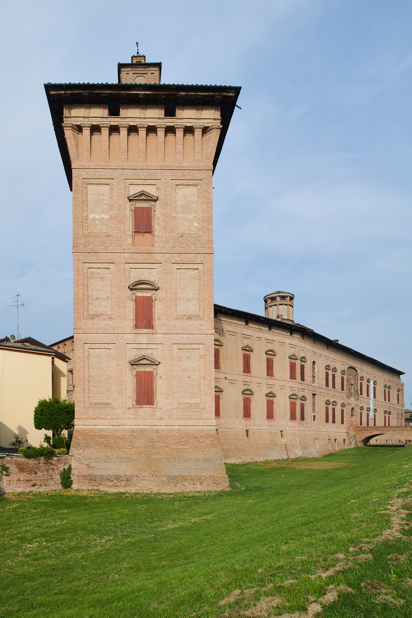

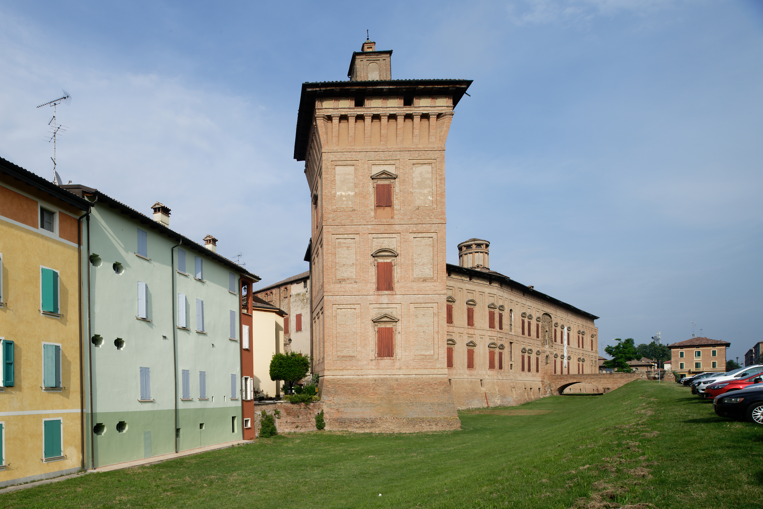

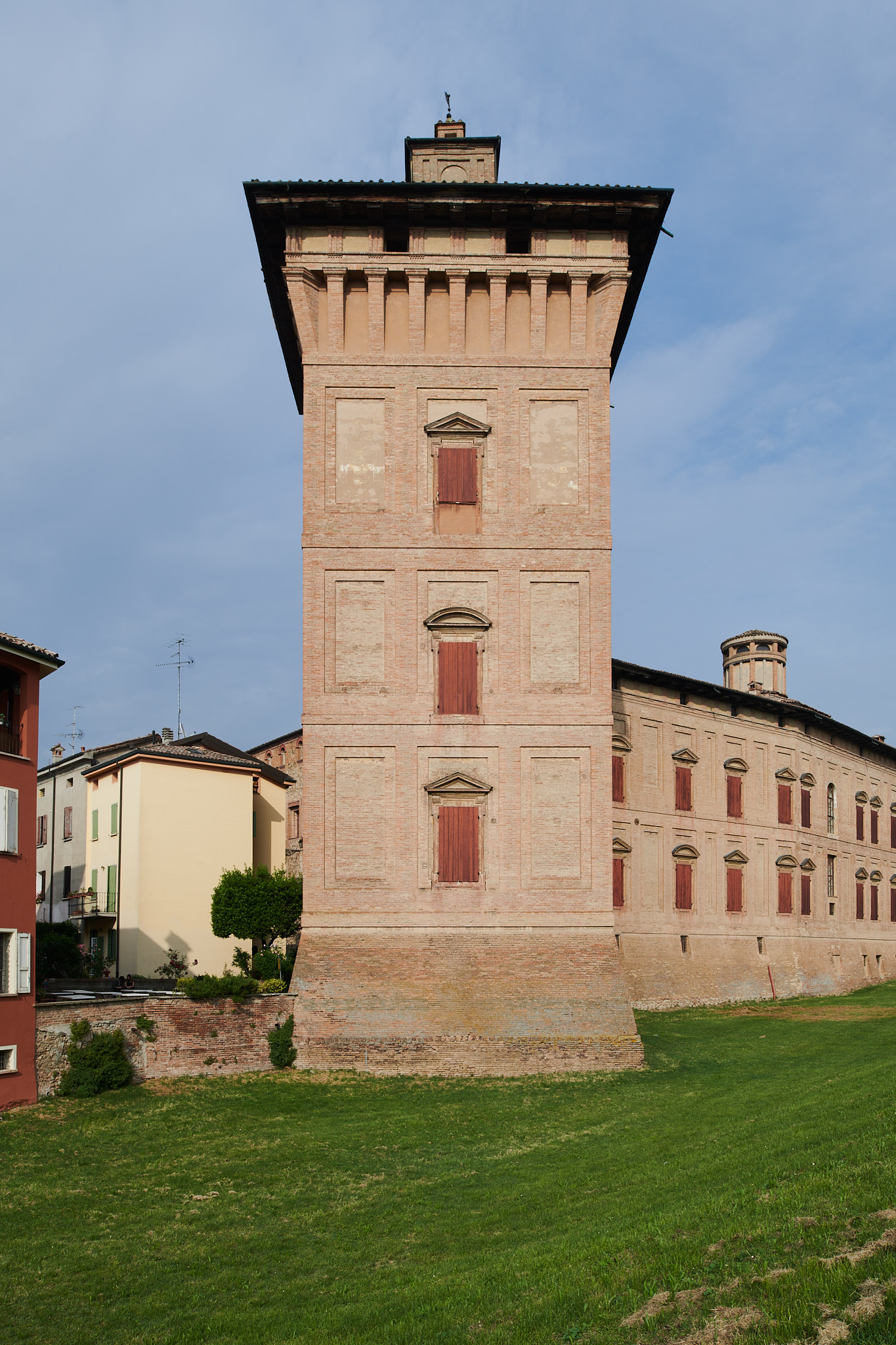

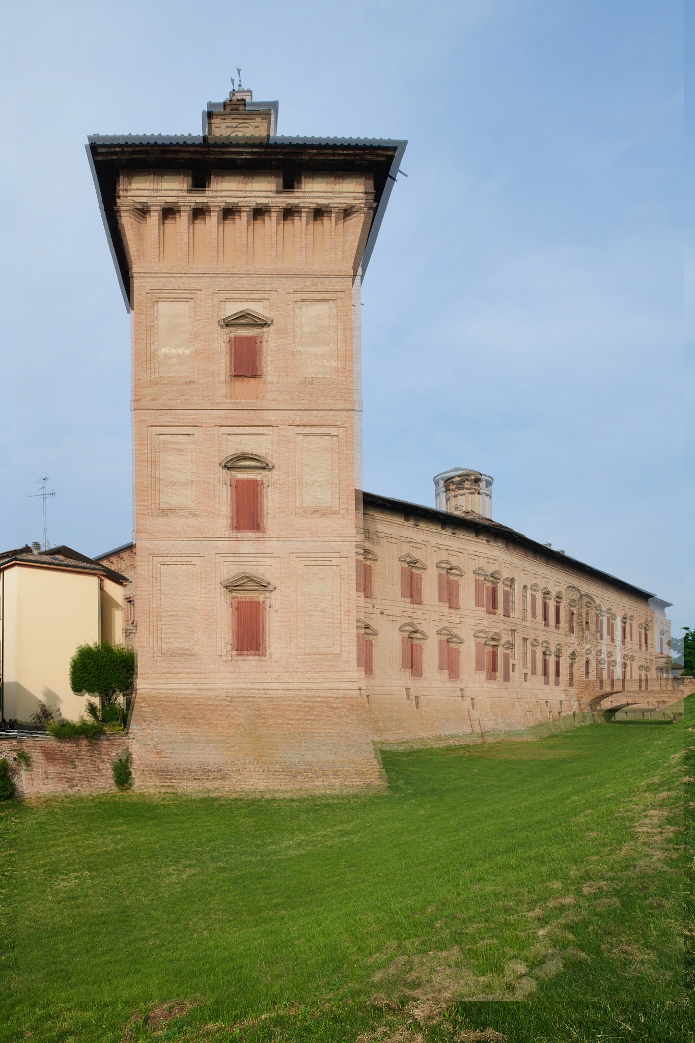

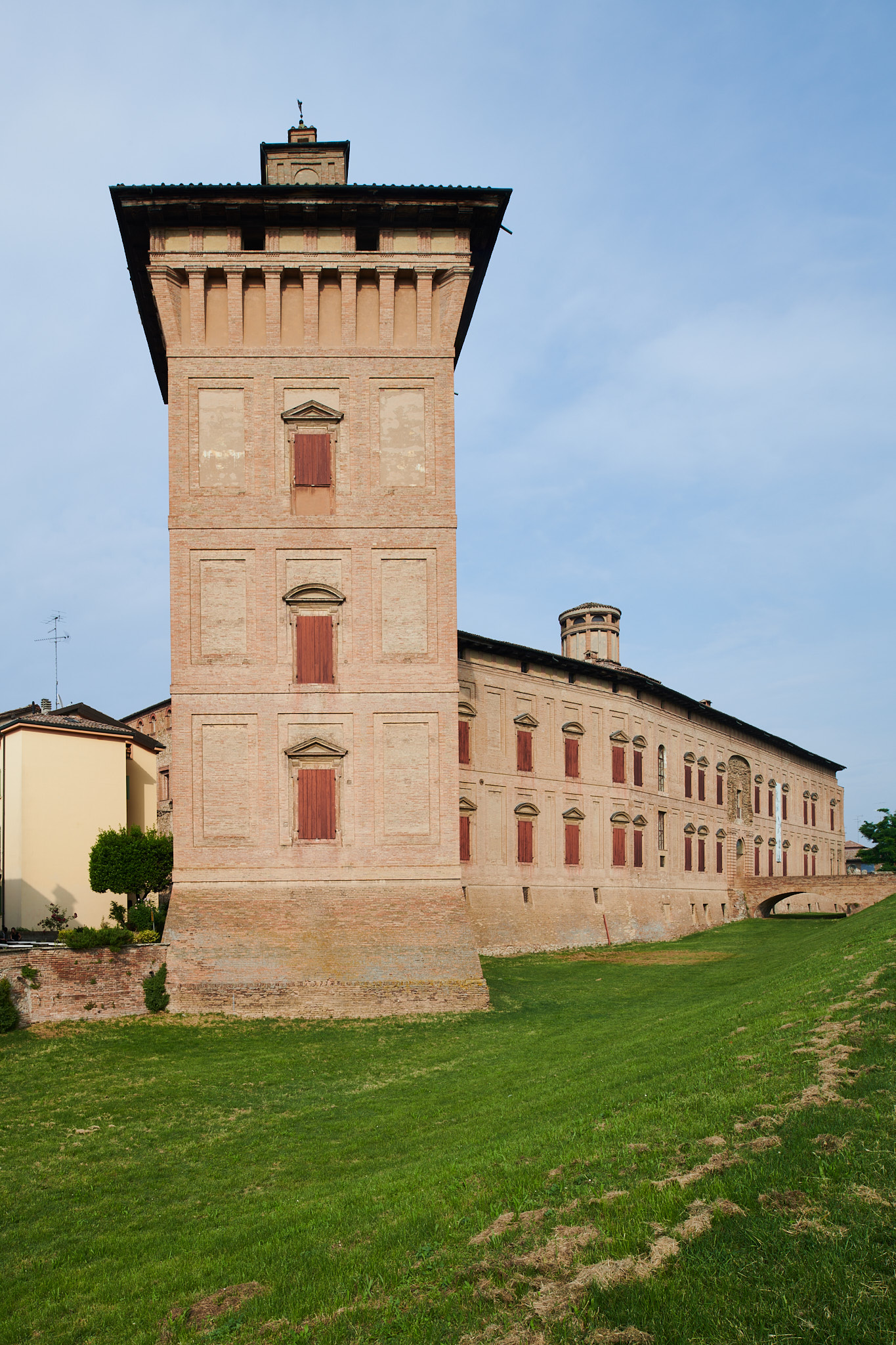

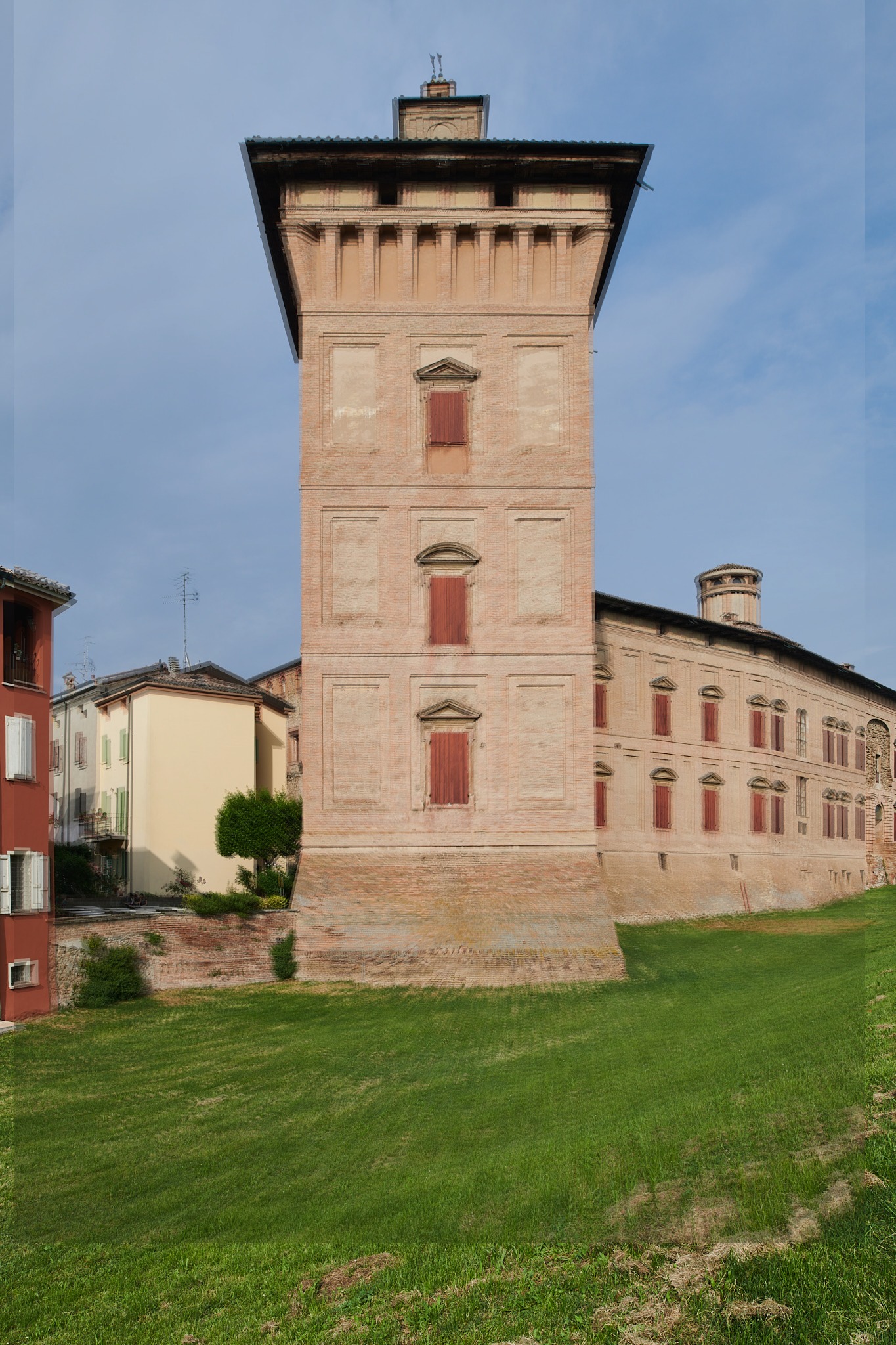

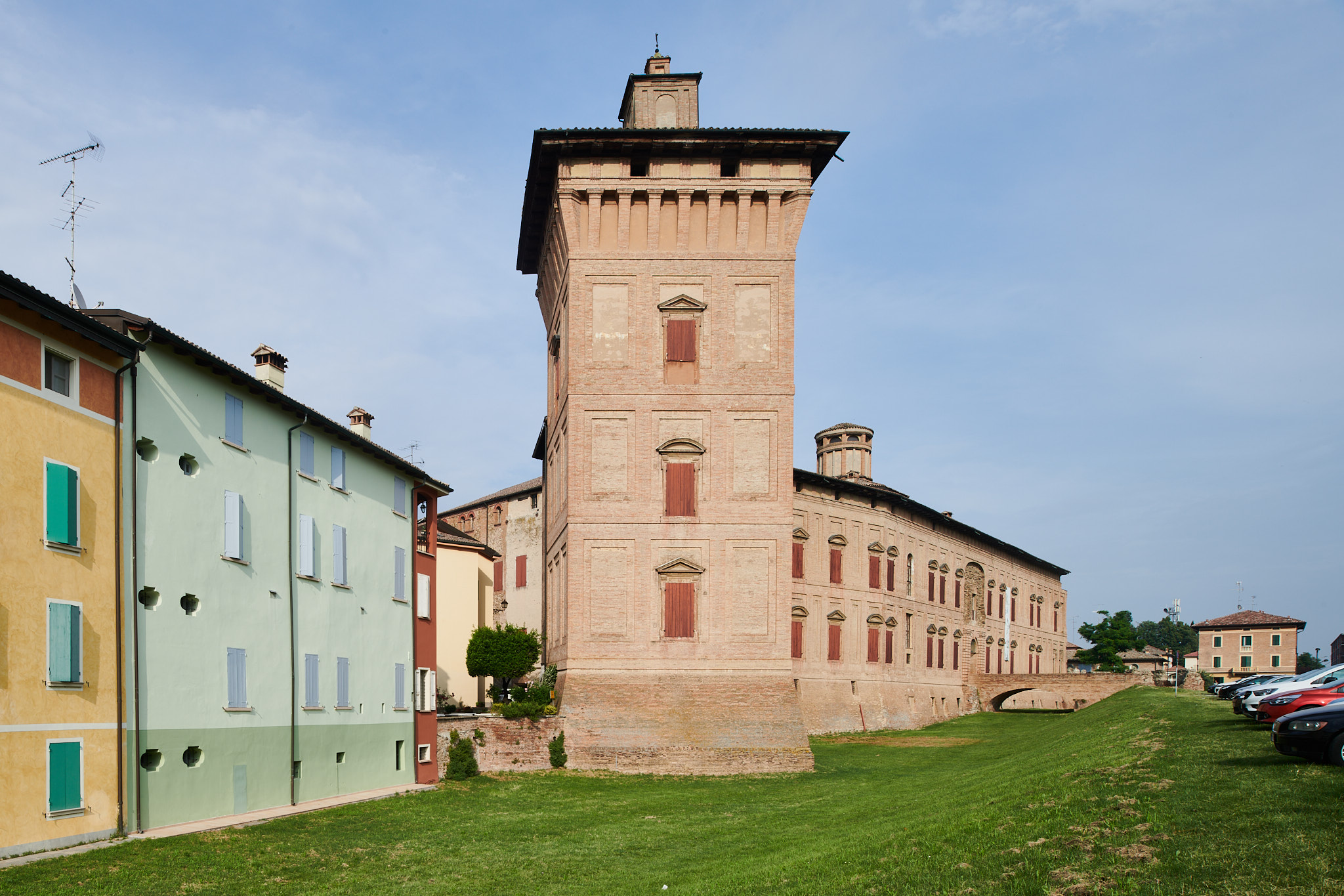

    Last year, I took my 24mm TS lens to a local castle to see if there are any visual differences between using a shift lens, and correcting keystoning in post. The lens was on a tripod and in a fixed position. In one case the lens was shifted, in the other, shift was set to zero and the lens tilted to simulate a normal lens. I have never seen any sort of comparison in my textbooks or on the web, so I decided to do my own comparison to see if things change geometrically.
    I looked at two cases: simple vertical shift and diagonal shift. I then made an approximate overlay of the images to get an idea of the differences using a pretty primitive hit or miss tool on the Web.
    Simple vertical shift is pretty close, with very minor differences probably due to my approximations. Diagonal shift does have some more noticeable differences.
    I just wanted to do a geometrical comparison. The other merits of using a shift lens compared to correcting in post is an another interesting conversation.
    1- 24mm TS levelled and shifted upward. Camera centred perpendicular to the tower
    2- 24mm TS levelled with zero shift and pointed upwards. Camera centred perpendicular to the tower . No correction in post
    3- 24mm TS levelled with zero shift and pointed upwards. Camera centred perpendicular to the tower . Correction in post
    4- Overlay - The match is almost perfect

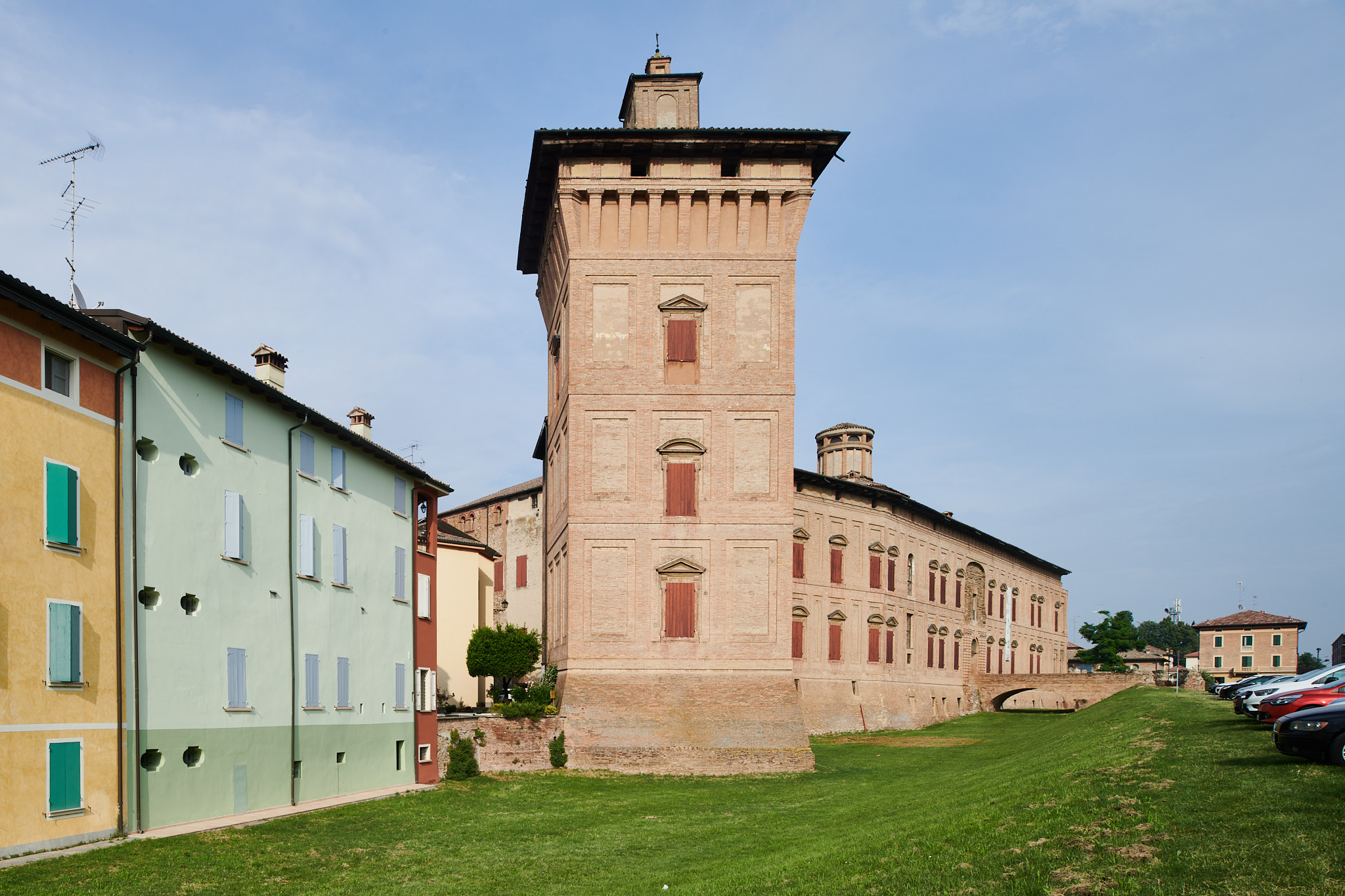

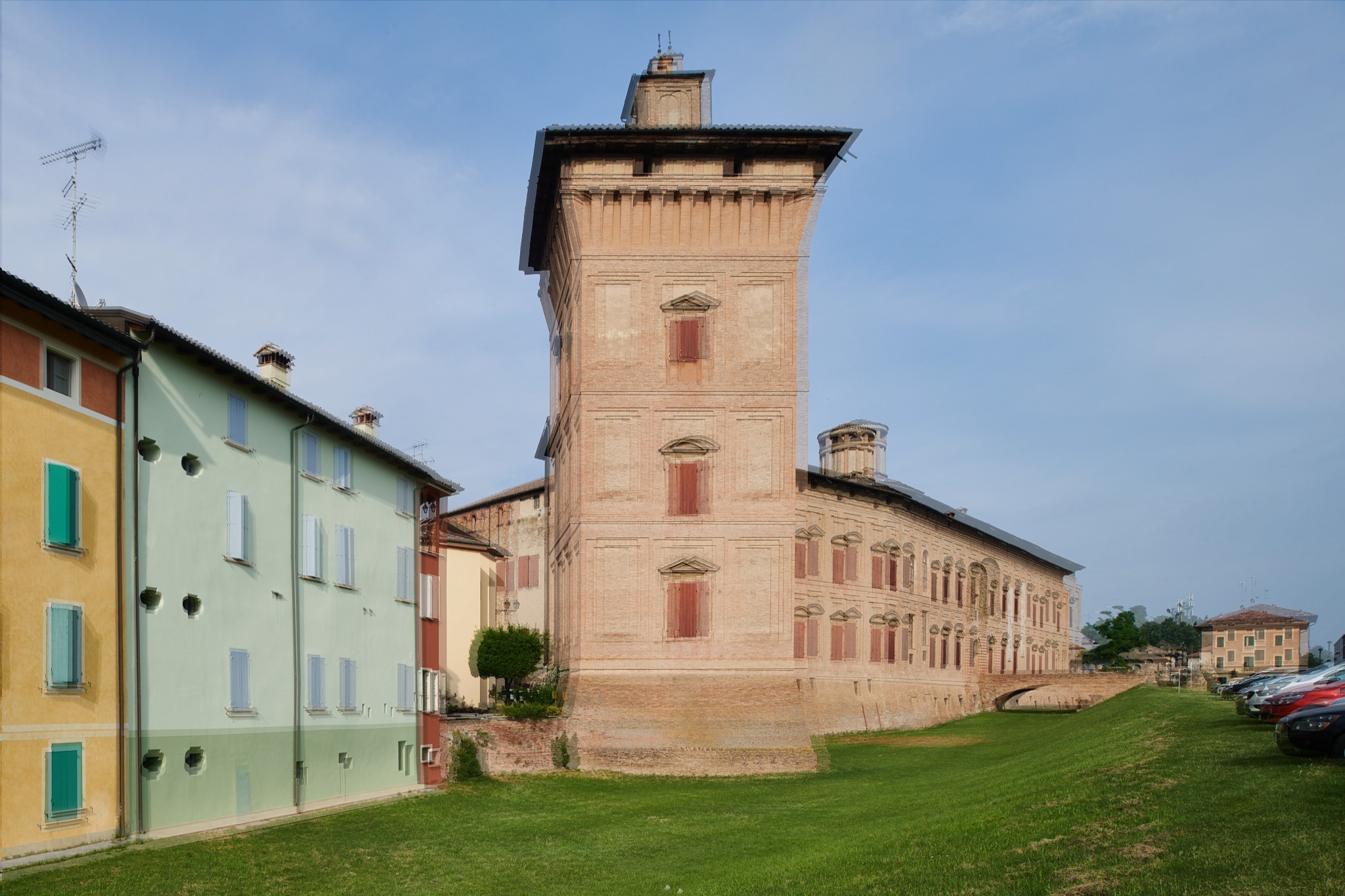

    5- 24mm TS levelled and shifted diagonally upwards. Camera centred to get the whole building into the frame
    6- 24mm TS levelled with zero shift and pointed upwards. Camera centred to include the whole building . No correction in post
    7- 24mm TS levelled with zero shift and pointed upwards. Camera centred to include the whole building . Correction in post in 2 directions
    8 Overlay. This is pretty approximate as getting a good match was almost impossible.

    9- 24mm TS levelled and shifted upwards. Camera centred to get the whole building into the frame
    10 - 24mm TS levelled with zero shift and pointed upwards. Camera centred to include the whole building . No correction in post
    11- 24mm TS levelled with zero shift and pointed upwards. Camera centred to include the whole building . 2 way correction in post
    12 Overlay

  • Members 2696 posts
    Nov. 21, 2023, 6:07 p.m.
    I did the comparisons, because I was just to curious to see if there was any differences, between "doing it in post" and using a shift lens, as i could find no real life comparisons anywhere.
    I have had these sort of arguments before on DPR, in fact some people got quite nasty about it. There seems to be a strange aversion on photo forums to these lenses, because they are considered expensive specialist tools, that all conquering software can replace easily. In fact you can find an old Nikon or Canon PC lens for €200 - €300 and they still do a decent job. My more modern lenses cost me €1000 for hardly used copies. Hardly earth shattering sums compared to current lens prices. But nobody ever questions the wisdom of the bird photography brigade who often spend mouth watering sums on lenses.
    My tests show that indeed doing it in post can get the same results as using a shift lens, in the most simple cases. But start doing diagonal shifting and as my comparisons show, the results are very different, and difficult to achieve in post.
    But most of all photographing architecture with a shift lens on a tripod is a more satisfying experience. It is nice as well as easier to compose the near final framing in camera, without having to make guesses about the inevitable cropping that occurs with PP keystone correction.

    I took the same shot from the same spot with the same lens, shifted or with the lens tilted and then made overlays. I would say I have provided pretty good proof that in simple situations key stone correction and lens shifting provide much the same results with commercial software. I also show in more complex situations that optical correction and keystone correction give very different results.
    I will also add using shift lenses lets me control the perspective effects much easier. I see the perspective effects in camera, and can change focal length if needs be.
    Nov. 21, 2023, 8:25 p.m.
    Frame 8 and Frame 12. Enlarge the overlays and the difference is quite marked.
