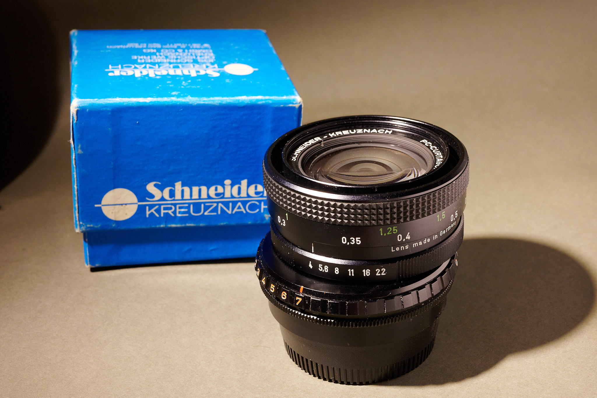

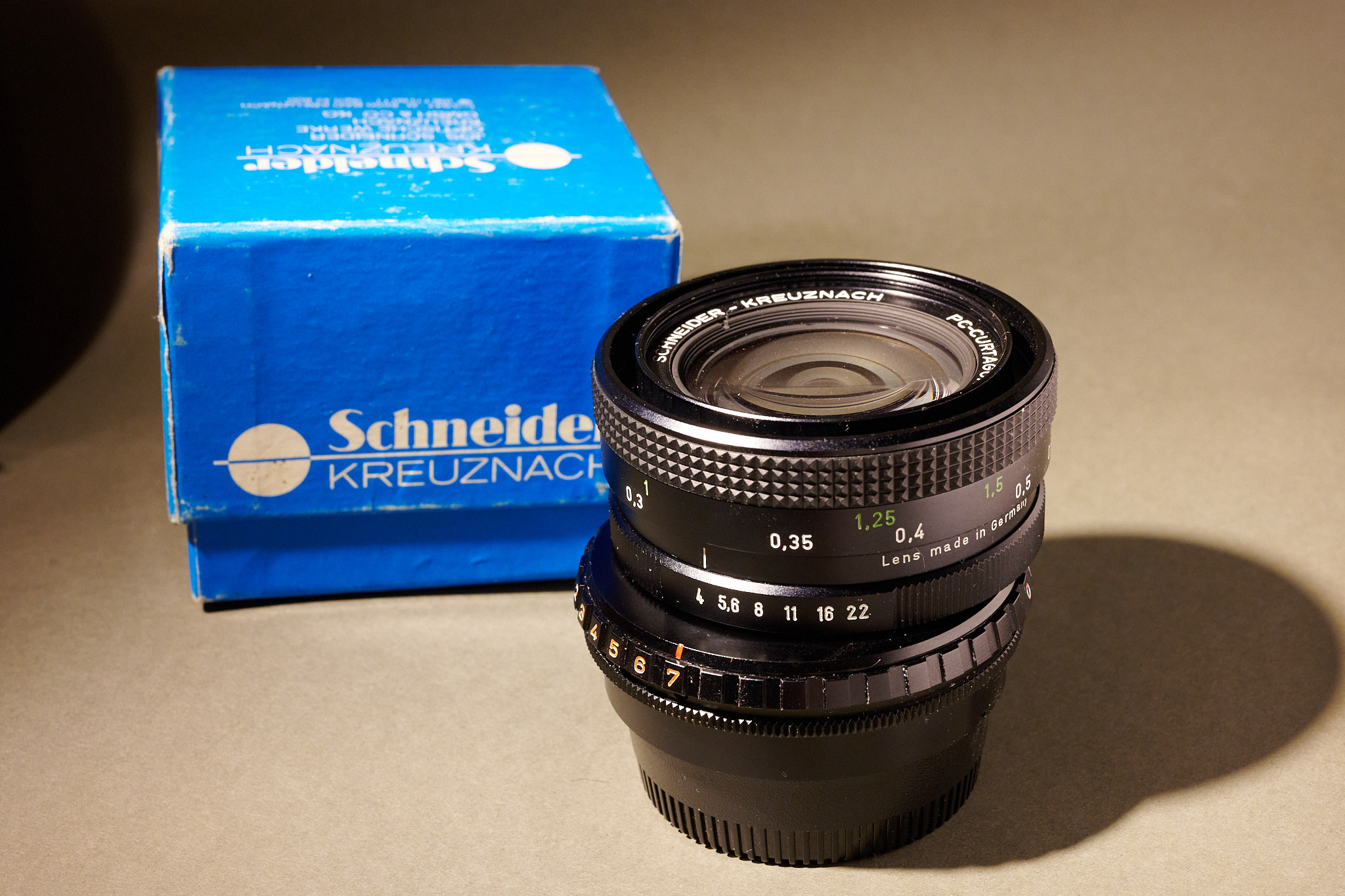

    Maybe my title did not have surgical precision. Lens quality today, seems to be tied up with MFT resolving power, test charts and blurred corners. I forgot Bokeh of course. This is what my post was all about. Nobody, talks much about contrast, micro contrast and other factors which make up the lens image quality package. The Samyang 24TS which I owned briefly was slated for various distortion issues in the reviews I read, but none talked about the horrible low contrast this lens had.
    Your observations regarding Leica and Fuji images, may be due to some sensor micro lens magic, or software processing. Who knows.
    I bought a Schneider Kreuznach PC Curtagon 4.0 35mm shift lens, old new stock for €240, out of curiosity. It has a very original shift mechanism. The few tests I found were not encouraging. But I like the rendering this lens gives me. Like the two Nikon PC lenses, it seems a bit more "creamy" than my sharper modern lenses.
    I might dig out my old Nikon 180 2.8 to see if it has anything to offer, when I photograph architectural details.
    The diversion of this thread turned out to be interesting. It seems diagonal shift, can be reproduced in post if you use the right software. Which begs the question about what transformations are being done when we use the key stone correctors in our software.
    JPG, 1.1 MB, uploaded by NCV on Nov. 22, 2023.
