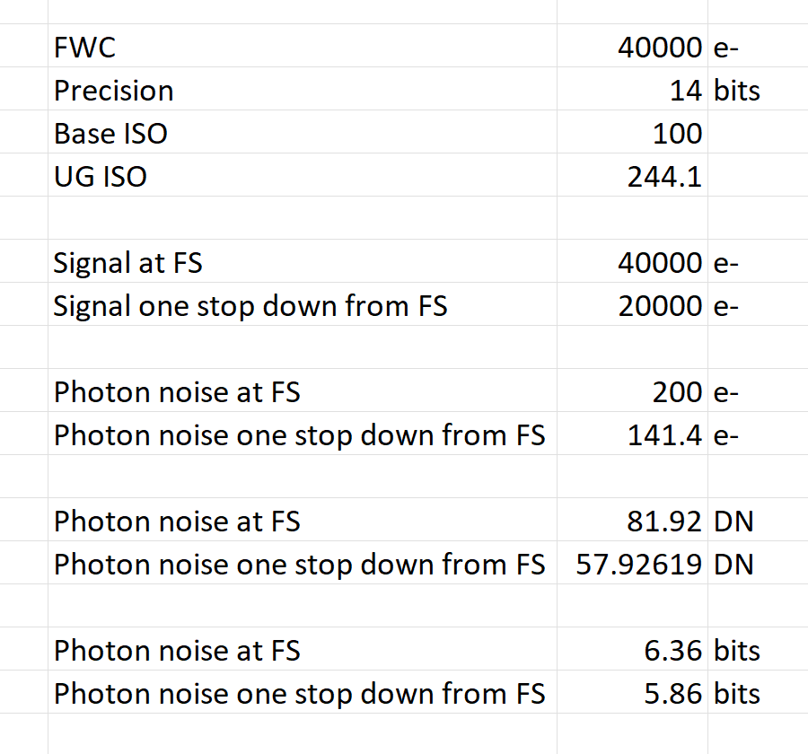

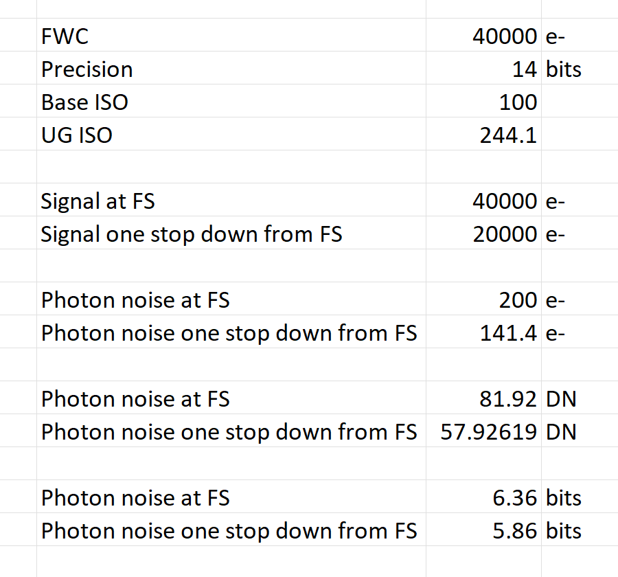

    Here are some numbers that show how much noise there is in the upper tones of a modern camera:
    So the 14 bit ADC becomes roughly an 8 bit one, for purposes of measuring the signal.
    PNG, 43.9 KB, uploaded by JimKasson on April 10, 2023.
