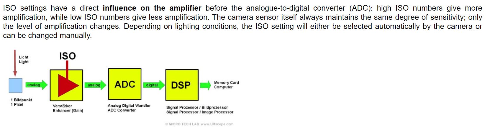

    Bob ,wouldnt the iso control operate the same as the electronic shutter ? because its using a timer to control the charging capacitor ?
  • Members 976 posts
    April 10, 2023, 12:05 p.m.
    Currently, ISO control doesn't use a timer.
  • Members 2662 posts
    April 10, 2023, 12:11 p.m.
    JPG, 101.3 KB, uploaded by DonaldB on April 10, 2023.
  • arrow_forward
    Thread has been moved from Beginners' Questions.
    April 10, 2023, 12:15 p.m.
    but it cant use anything else at pixel level (would be to complicated), just a simple transitor triggered to stop the charge to the capacitor ?
  • Members 976 posts
    April 10, 2023, 12:18 p.m.
    That's wrong.
    ISO "implementation" is a multi-stage chain, might even involve raw converter. In current consumer cameras it may involve pixel control, one or two variable gain amplifiers, ADC, multiplication in camera, multiplication in raw converter. In the current experimental implementations there are even more stages present, and architecture in some of those is quite different.
  • Members 976 posts
    April 10, 2023, 12:19 p.m.
    It switches on/off an extra "capacitor" before the exposure starts.
    April 10, 2023, 12:20 p.m.
    electronic shutter how does that control light exposure ?
  • Members 256 posts
    April 10, 2023, 12:27 p.m.
    ISO settings influence the brightness after exposure - sometimes as analog amplification before the ADC, as in your example, or in the digital domain after the ADC (ISO implementation varies). At no time does ISO itself contribute to exposure.
  • April 10, 2023, 12:37 p.m.
    In the case of dual conversion gain it's an extra capacitor and a transistor that switches it in or out of circuit. Stopping the flow of charge to the capacitor would reduce photoelectron count, which is exactly the wrong thing to do.
    April 10, 2023, 12:38 p.m.
    By the shutter speed I set or the camera sets to satisfy its meter.
    Are there any sentences in my post you quoted that you think are not accurate?
  • April 10, 2023, 12:40 p.m.
    It doesn't work like that. Were it to it would be reducing the number of photoelectrons measured, which would result in the same effect as a smaller exposure - exactly what you don't want. The pixel circuitry contains an additional capacitor (the native 'capacitor' is the combined capacitance of the floating diffusion and source follower gate) and a transistor that can switch that capacitor in or out of circuit.
  • April 10, 2023, 12:42 p.m.
    It controls the time over which the sensor accepts light, as opposed to the time over which it is exposed to light. So, with a slight technicality it isn't quite controlling 'exposure time', rather 'integration time' - but it doesn't lead to conceptual problems if it's thought of as 'exposure time'.
  • Members 102 posts
    April 10, 2023, 4:28 p.m.
    Boy, this thread has sure shifted away from the simple issue of whether "exposure" is how dark or light an image looks.
    But in any case, different cameras have different implementations of ISO. It seems as if people are suggesting that all cameras do things the same way. That's clearly not the case.
    April 10, 2023, 9:06 p.m.
    thats all i needed to win, on a slight technicality 😜😁
    April 10, 2023, 9:08 p.m.
    i disagree , post a schematic that shows different. only extended iso is controlled digitally.
  • April 10, 2023, 9:11 p.m.
    Sorry, just not factual.
