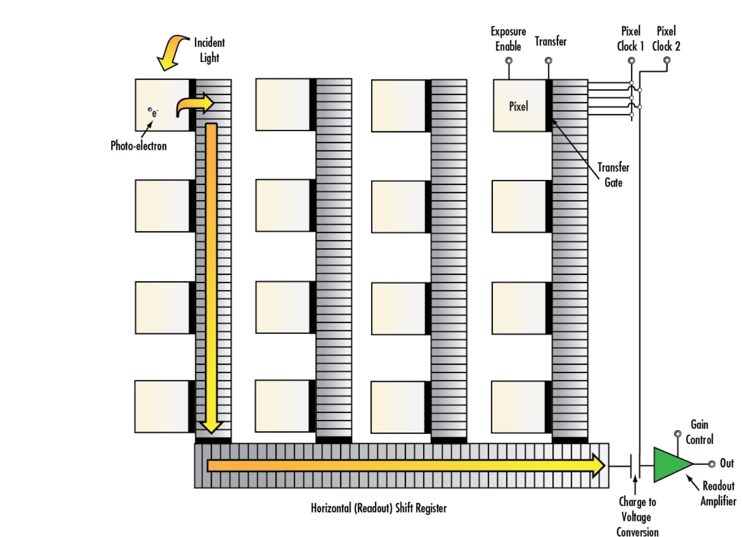

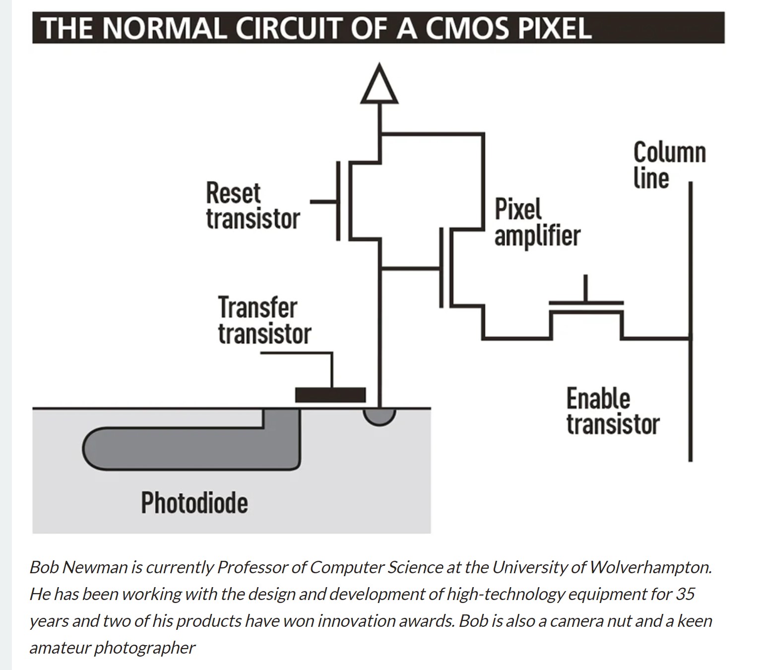

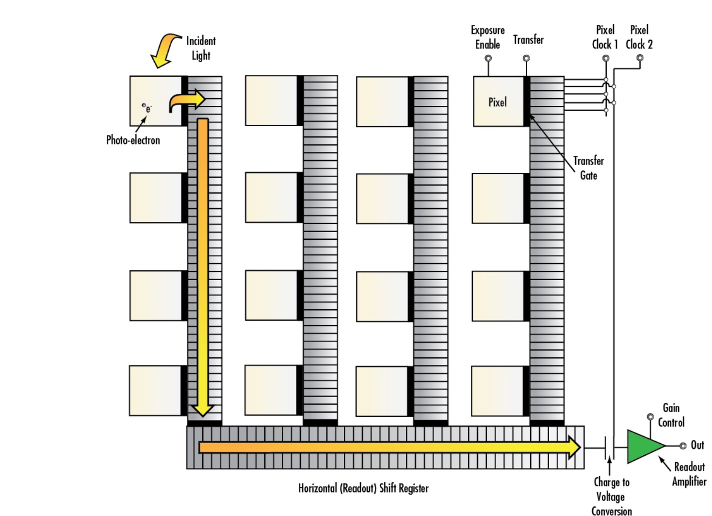

    i found these 2 images. not much info otherwiseScreenshot 2023-04-11 083829.jpgScreenshot 2023-04-11 091341.jpg.
