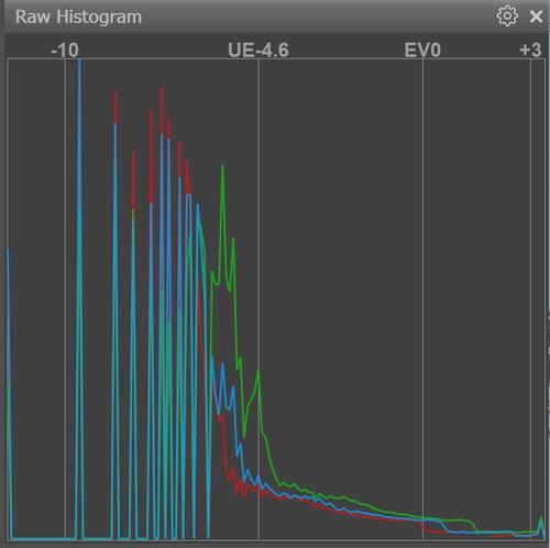

  • Members 2648 posts
    May 4, 2023, 10:27 p.m.
    my camera blinkies shows highlight clipping exactly to the scale of your raw histogram. my suggestion for you is buy a better camera 😁
    JPG, 71.9 KB, uploaded by DonaldB on May 4, 2023.
  • Members 976 posts
    May 4, 2023, 10:37 p.m.
    One example, and without even a JPEG histogram / blinkies scan/shot from the back of the camera, proves nothing. But you know that.
    May 4, 2023, 10:46 p.m.
    Im away camping so limited resource's, and no field monitor. the rear ldc is tiny and hasn't the resolution. but the blinkies dont care about resolution. and i knew i had already posted a raw histogram so that was easy to download.
