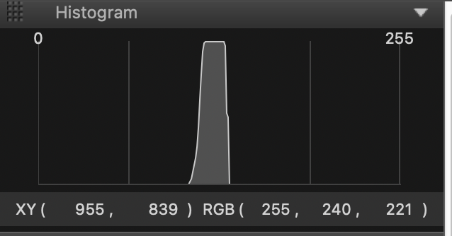

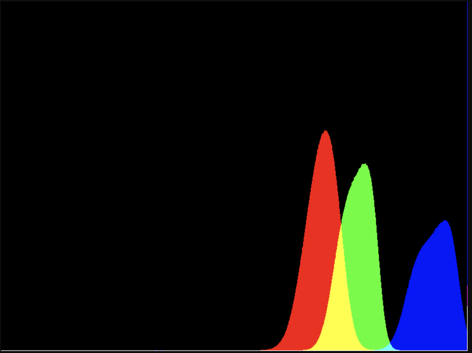

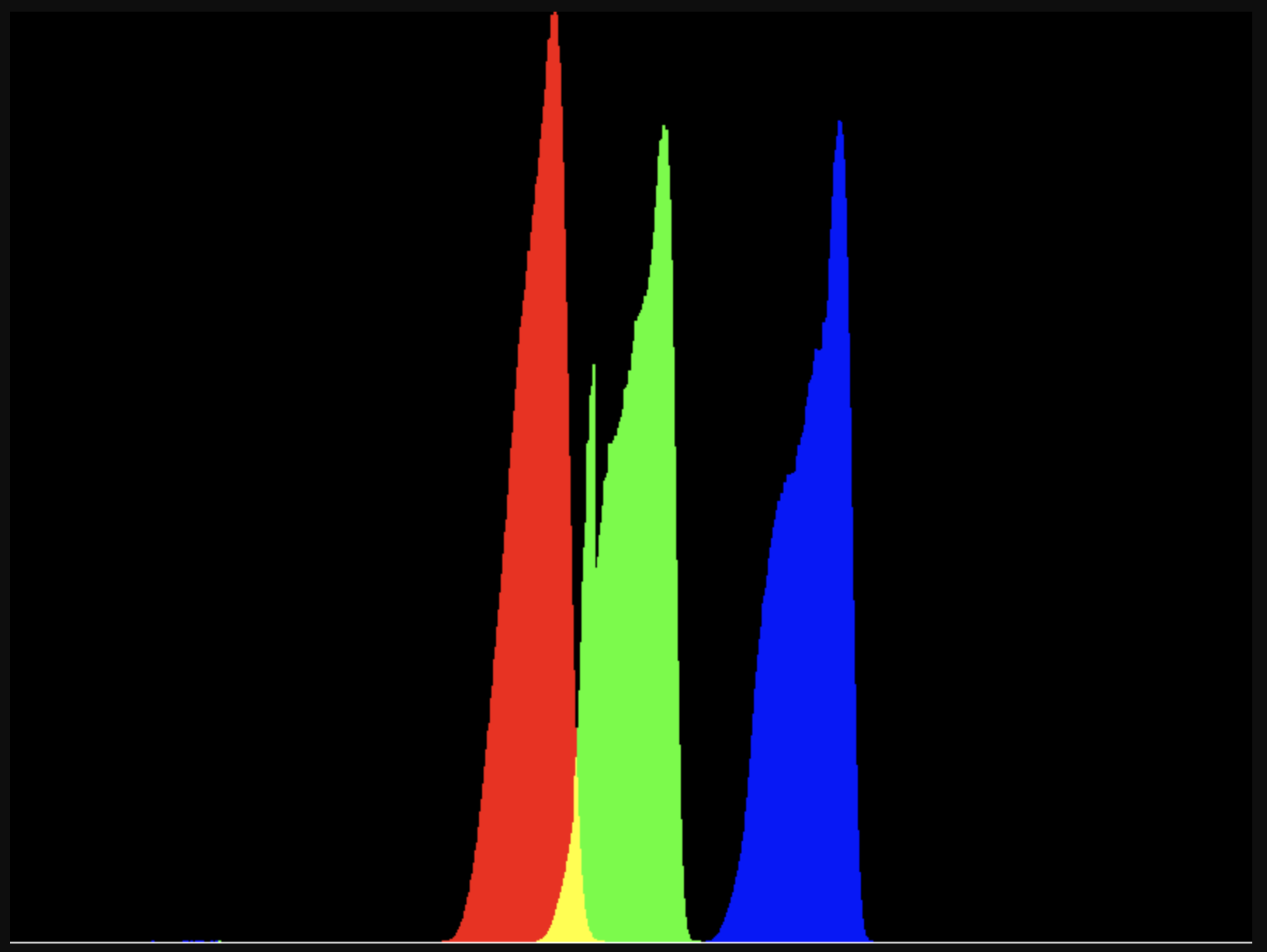

  • Members 83 posts
    May 11, 2023, 7:44 p.m.
    Thanks @JimKasson for the information at LensRentals. Well done.
    One thing I am still a little puzzled about is how the gamma curve (or curves) impact the values near clipping and how this might be predicted from a raw histogram. A Franklin's Gull was flying over my house when my camera was ready for a perched bird and I am old and slow. When I make what Canon DPP calls "gamma" adjustments, the shape of the curve changes, the input limits change (but less than is possible with rawtherapee), and the toe and shoulder of the curve cause levels to be stretched or compressed.
    (some command lines executed on my Debian machine and some on my iMac)
    image.png histogram in Canon DPP with cursor over pixel that has red value of 255.
    image.png histogram produced by
    /home/jrm/src/libraw2021dec18/LibRaw-master/bin/dcraw_emu -v -T -6 IMG_4055.CR3
    and
    /opt/local/bin/gmic IMG_4055.CR3.tiff keep[0] display_histogram 800,600,65536,0,65535,0,"cut(i,0,65535)" normalize[-1] 0,255 output[-1] IMG_4055a_hist.png ; echo "gmic histogram"
    [gmic]-0./ Start G'MIC interpreter.
    [gmic]-0./ Input all frames of TIFF file 'IMG_4055.CR3.tiff' at position 0 (1 image 8191x5463x1x3).
    [gmic]-1./ Keep image [0] (1 image left).
    [gmic]-1./ Render 800x600 channel-by-channel histogram of image [0], with 65536 clusters, minimum value 0 and maximum value 65535.
    [gmic]-1./ Normalize image [0] in range [0,255], with constant-case ratio 0.
    [gmic]-1./ Output image [0] as png file 'IMG_4055a_hist.png' (1 image 800x600x1x3).
    [gmic]-1./ End G'MIC interpreter.
    gmic histogram
    image.png histogram produced by changing the input range in Canon DPP to +2.00 and exporting 16 bit tiff and
    /opt/local/bin/gmic IMG_4055h.TIF keep[0] display_histogram 800,600,65536,0,65535,0,"cut(i,0,65535)" normalize[-1] 0,255 output[-1] IMG_4055h_hist.ppng ; echo "gmic histogram"
    [gmic]-0./ Input all frames of TIFF file 'IMG_4055h.TIF' at position 0 (2 images [0] = 8192x5464x1x3, [1] = 252x168x1x3).
    [gmic]-2./ Keep image [0] (1 image left).
    [gmic]-1./ Output image [0] as png file 'IMG_4055h_hist.png' (1 image 800x600x1x3).
    gmic histogram

    PNG, 72.5 KB, uploaded by JohnMoyer on May 11, 2023.
    PNG, 65.2 KB, uploaded by JohnMoyer on May 11, 2023.
    PNG, 67.2 KB, uploaded by JohnMoyer on May 11, 2023.
