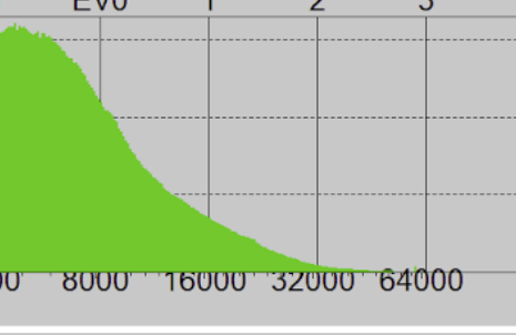

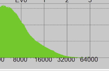

    Let's take a closer look.
    With a linear y-axis, there are no clipped pixels to be seen. We can tell there are some from the numbers, but the count has to be low. With a log y-axis, you can see some green channel clipping.
    But the X2D doesn't have a log y-axis option, so we can't make that comparison.
    PNG, 33.0 KB, uploaded by JimKasson on May 12, 2023.
